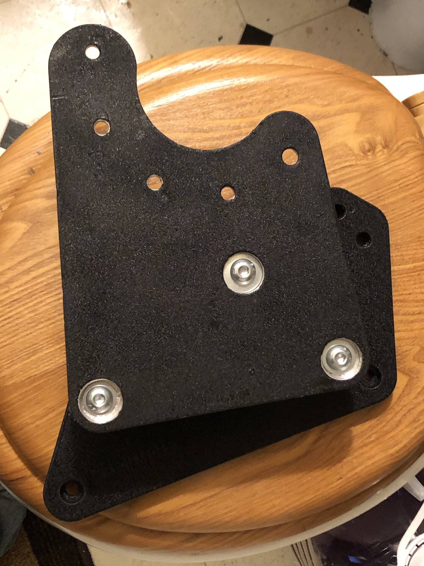

The brackets for a procharger carb legal kit are so easy that I can make them with a grinder and a drill no problem. They are both completely flat and a easy design to cut. This is the two brackets bolted together. As anyone can see this design would be easy to copy

That's true, but you need the brackets as a model. And they're precisely designed so you need a set to replicate. You don't just make those out of the clear blue

Where does the bracket mount to on the engine?
I don’t see why not. If you just replicate the mounting spots and adjust the mount so that the pulley is straight with the crank pulley I don’t think it should be that bad.
