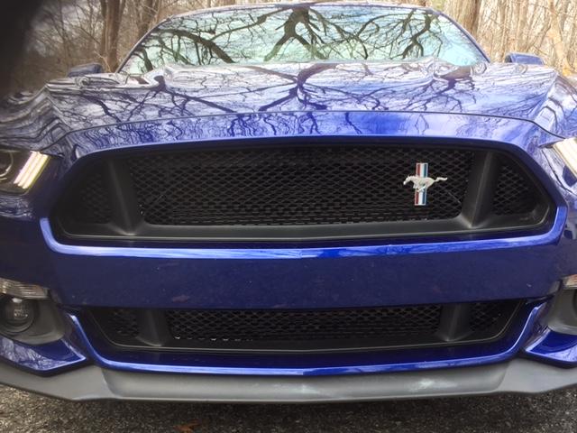

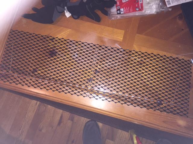

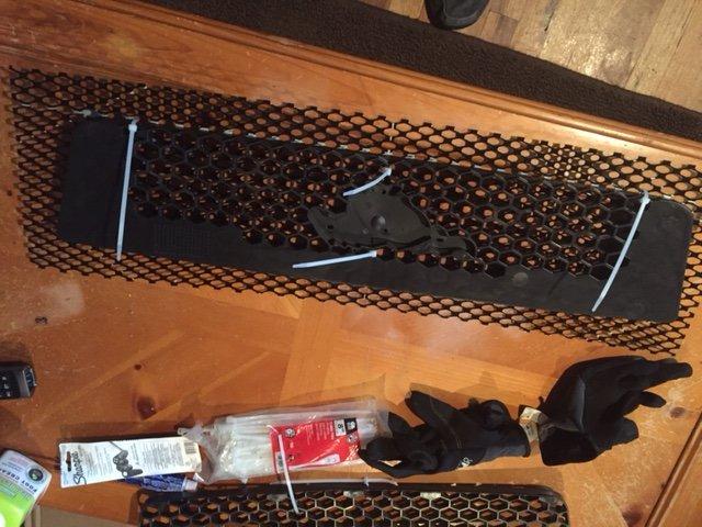

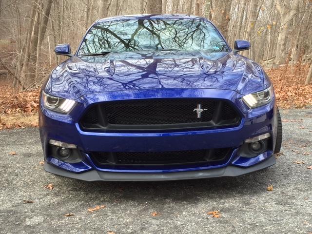

I just completed mine. Followed the procedure shown using a gloss black powder coated mesh sheet from Custom Car Grills. The 16" x 48" was more than enough to do all six sections.
http://www.customcargrills.com/proddetail.asp?prod=Perf_GT
The only tip I can add is before discarding the cut-out honeycomb bits, you can use it as a template to mark and bend the mesh. The aluminun mesh I used was easy to cut with snips, but tough to bend accurately. This template helps account for the curvature of the grille.
