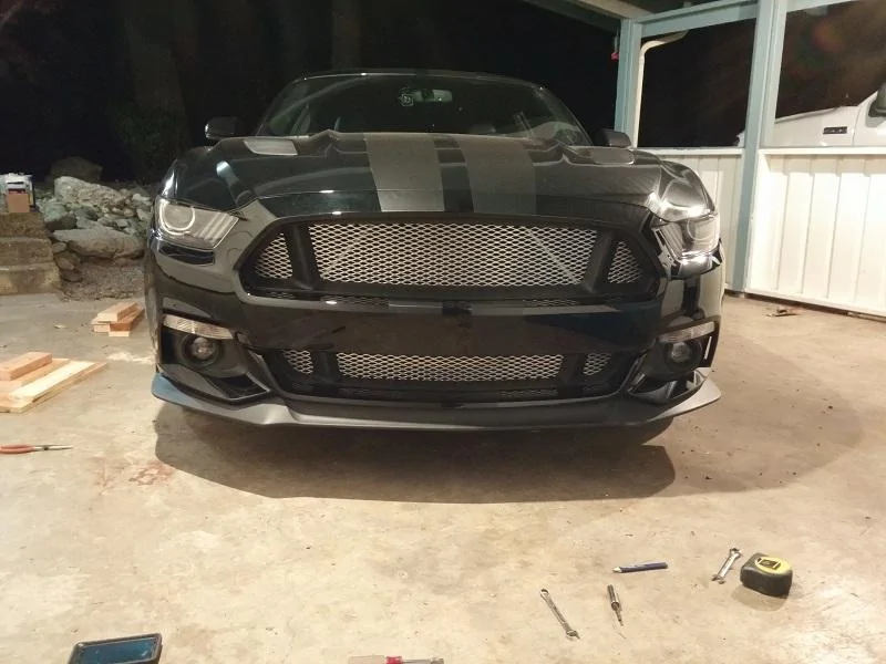

Looks great Trent. Where did you get the grille material?
Any metal wholesaler. I got aluminum it's more expensive but it won't rust. If your going to paint it just get the steel expanded sheet metal and powder coat.... Way cheaper. I'm going for lightweight so I replaced the crash bars with aluminum while I had the bumpers off and got the grill in aluminum too. If you get the thin stuff it won't matter if it's steel or not it's going to be pretty light.

Thanks, for the feedback. I have been looking for something at the larger hardware stores but, everything I seem to find has holes that "look" too small. Is this a flat sheet or does it have some depth (like the extruded steel)? A close up picture would be great!

Its a flat sheet of expanded sheet metal i got at a local metal wholesaler. I would definitely recommend the steel though Aluminum prices have gone sky high lately but i was doing this for weight reduction that thick plastic grill was pretty heavy. I just zipped tied it to the clips behind the grille. You can do it more permanent if you want but I havn't decided if im going to take it out and powder it black yet... cant decide
