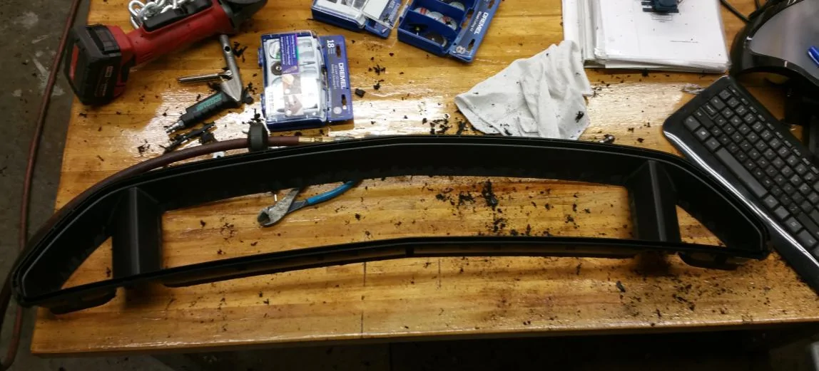

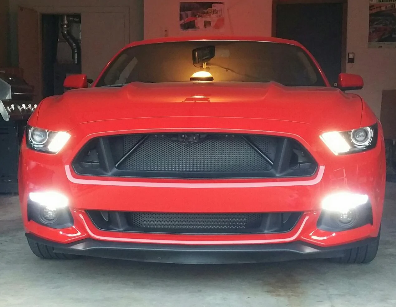

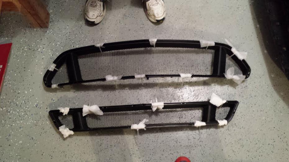

Hey guys just saw this and thought maybe someone would appreciate the write-up versus a $300 vendor alternative. I did mine for about half the price $100 for upper and lower grilles from NewAutoParts.com
http://www.newautoparts.com/ford/au...ine/body-cat/bumper-and-components-front-scat
and $40 for a nice piece of expanded metal that doesn't look like the "chicken wire" i found alot of other places,
http://www.amazon.com/gp/product/B000H9TJFQ?psc=1&redirect=true&ref_=oh_aui_detailpage_o09_s00
also some VHT Rollbar paint (satin black) for the metal that I had on my paint shelf.
http://www.autozone.com/paint-and-b...erature-roll-bar-and-chassis-paint/60045_0_0/
As the pictures show I used a dremel to remove the honey comb but unlike others, i actually took an hour or two and between the cutting disc and sanding wheels i cut the honeycomb clear from the inside because i didn't want to lose the depth of the grille. A bit of a PITA but if you're a bit OCD like me then its worth the extra effort in the end. I recommend wet-sanding at the end and then I taped off and resprayed just the part where the honeycomb use to be with matte black paint from local auto parts store
http://www.oreillyauto.com/site/c/d...475&categoryRedirect=N0474&pt=N0474&ppt=C0171
That is what I used and it blended seamlessly but of course use whatever you like. I did spend a good hour or so on custom fitting the expanded metal (once painted) so that it was bent at the top to mount into the same holes as the support brackets and then smoothed and rounded off on the bottom to fit the bottom brace holes. This way I can run my hand along the whole thing and not get cut on future work. The metal I bought had a front and back to it, there was a bit of a bevel to the holes on the front side and mounting it like I did still allowed for around 2 inches of space between the intercooler and the metal and also used the frame of the car and mountings to give the metal rigidity against big stones extra. I have had it on the car for about a month now with no issues whatsoever and have had numerous compliments about its unique look. This definitely makes it standout as you can see the intercooler etc through it yet the holes are small enough to catch bugs etc and the metal is strong enough to protect.
*****O one thing I forgot to mention, I also removed the 2 large clips holding the wire loom to the back of the bumper support and tucked the bundle into the conveniently placed channel in the back center of the support and then used the holes that were previously for the bolts holding the air vents to run black zip ties through and trim off facing down. This eliminates being able to see the ridiculously large clips and loom hanging out of place and also protects it a bit better from the elements. 2 minute alteration with great results*****

Looks fantastic. :headbang:

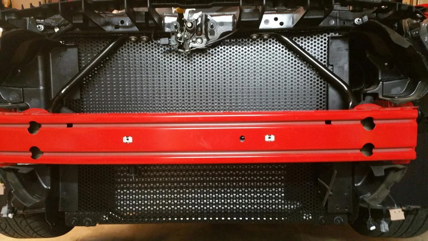

How did you guys get the metal to stick to the grill?
Midnight_LMR
Sep 10, 2015
431
90
Edmond, OK
Chris
2017 GT PP
Mine is stuck to the grill, its bolted to the frame supports. sits about 2" off the intercooler

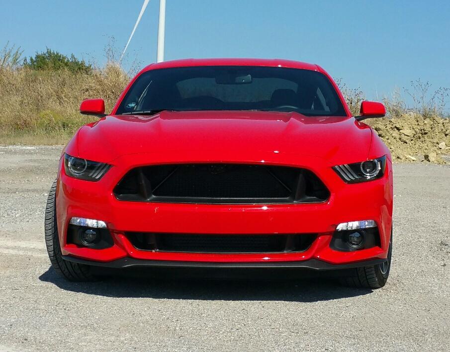

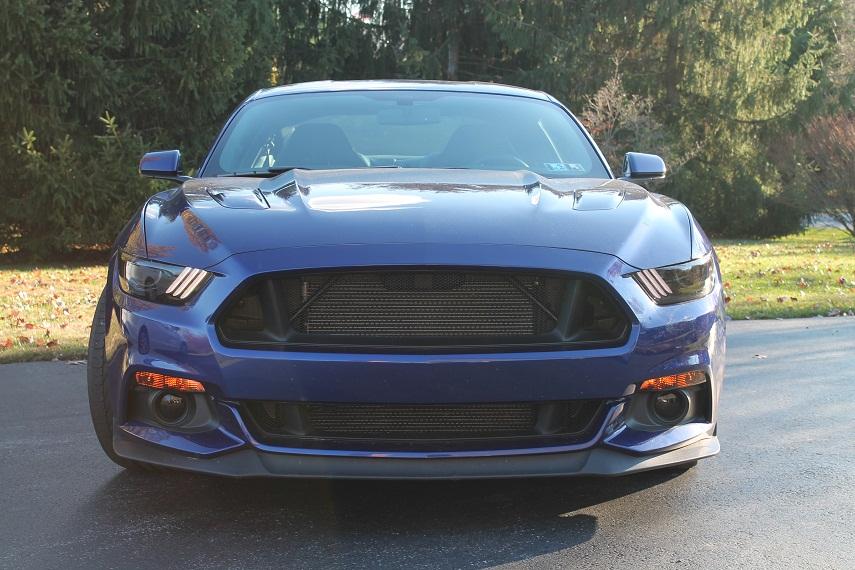

This may not be pure DIY, but I installed the customcargrills.com upper and lower mesh grill. About $100 including 2 tubes of GOOP. The kit was great, the finish on the grill(s) was flawless. When you order from customcargrills.com, the grill pieces come pre-cut and pre-bent, ready to go out of the box. Saves time and effort of cutting and bending and the frustration of cutting or bending incorrectly and starting all over again. Initially skeptical, the glue actually works well, similar to hot glue in application, only its cold. There is an online video showing how to install. [ame]. He shows a dremel cutting the stock fascia out. I attempted this method but my Dremel was battery operated and kept bogging down. So I said F it and grabbed a SawzAll and went to town. Results were excellent. The mesh is finer than stock, more protection from birds and stones. Customcargrills also has different patterns and colors. Go check them out. http://www.customcargrills.com/Ford-Car-Grills.asp

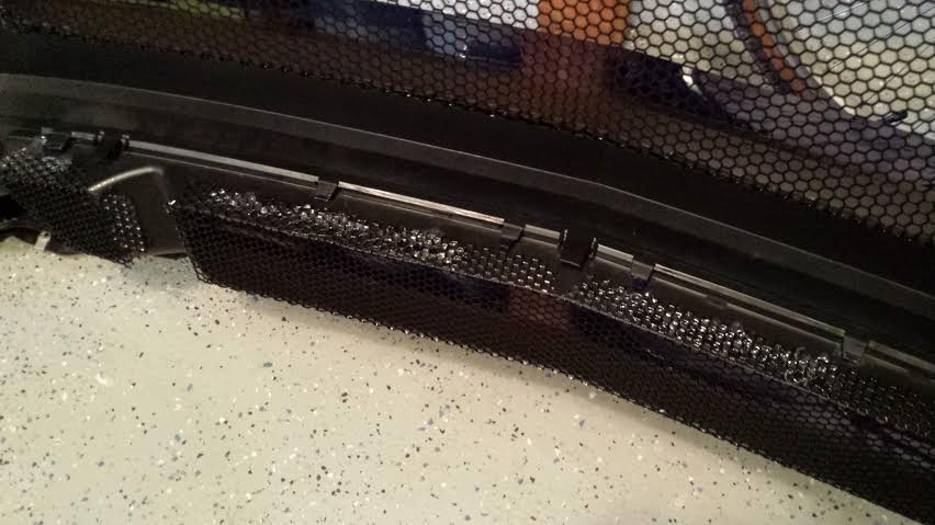

Here is how mine turned out when I used that eBay ABS honeycomb sheet. masked off the frame and sprayed the ABS with Krylon MAXX in satin black after I used plastic epoxy to "weld" it together.

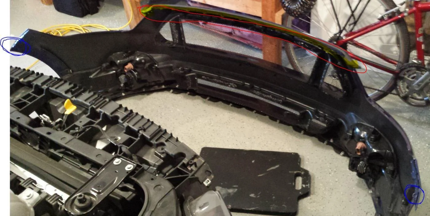

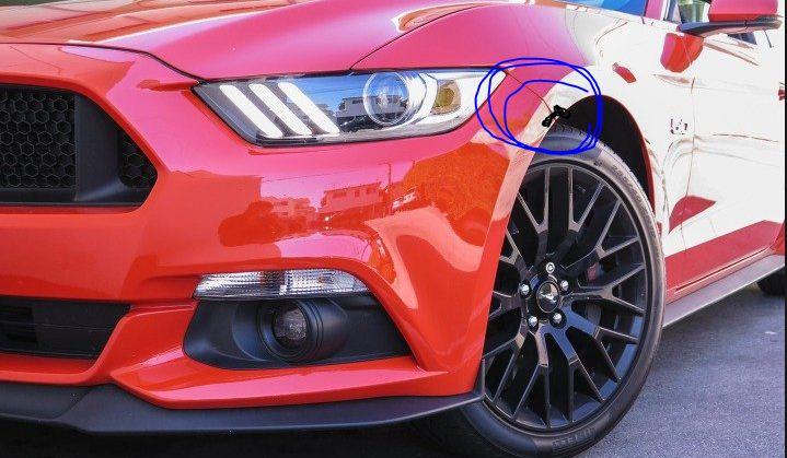

How hard was it dissemble/assemble it all? I am not mechanically inclined and I feel like I might break a clip or something.
For reference, I was looking at this guide: http://www.americanmuscle.com/rtr-grille-1516-manu-install.html
This is doable with minimal tools and experience. However, it does take some patience. There are a number of self tapping screws to remove. Have to be very careful when re-installing. The bumper screws on the top under the cover only get screwed in until they are flush, then a 1/4 turn or so. Circled in red in picture.
If you watch the video Midnight_LMR recommended, you have to be careful. When the guy in the video pulls the side of the bumper out, you have to first remove the 7 mm screws as Midnight_LMR mentioned. If not, you will crack the bumper and there is no way to fix it. See picture below for screw location, very tough to find. Circled in blue in both pics. Drew in black the screw angle on the red car.
Also, I recommend removing the wheels and wheel well cover to gain easier access.

2017 GT PP
