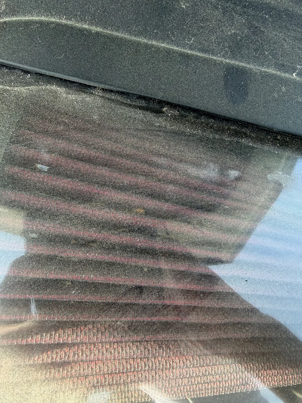

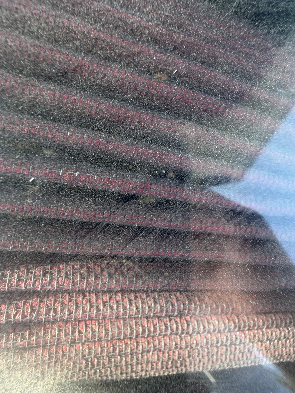

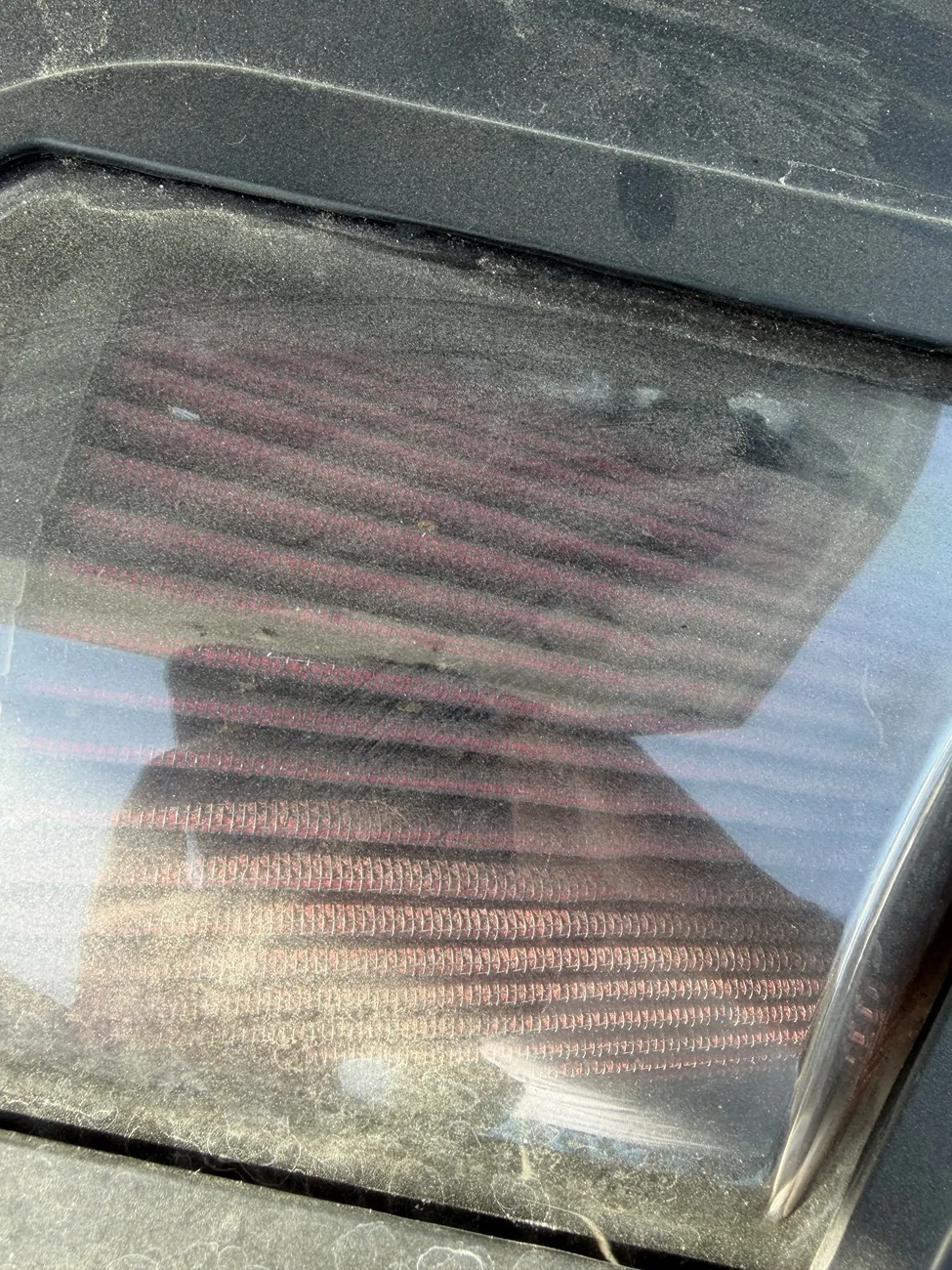

So i have my car with my roush cold air intake closed box for a while now and finally decided to look under the hood and found a lot of debris.
My question is what are my best options?
new filter cone? Whole new intake ( I’ve herd good about JLT & fenderwell) , or is cleaning it an option to save money ?
the oil still seems to be intact but this car is used and came with the filter so obviously im not sure how many miles total the intake has so my best 2 options are new filter cone or whole new intake

Car is healthy I don’t have any issues but I dont like how filthy it looks in there or maybe that’s just normal since it is doing its job

Is this post a joke? You do realize filters get dirty over time and you need to either replace them or if they are washable filters, you wash them. Google if you have a washable filter.
And why in the world would you replace an entire intake because the filter got dirty?

Performance is suffering if it’s extremely dirty. Your engine will breathe a sigh of relief once you clean it.
Spray each pleat with the cleaner, let it soak in and dissolve the oil for about 15 min., rinse filter from the inside out, shake excess water off and let it air dry. Once dry, spray each pleat with the filter oil (don’t go heavy), let that soak in for about 10 min. Go back and touch up any light spots and you’re done.

That filter isn't even dirty enough to warrant cleaning. Until the metal mesh can't be seen anymore, you're good. And before anyone wants to give me shit about that, take it up with K&N first. Straight from their website.

He's got a Roush dry filter. No oil.
Ahh, ok. If that was me, at the very least, I would soak it in Dawn dish soap for 15 min., rinse from the inside out and let it air dry.
