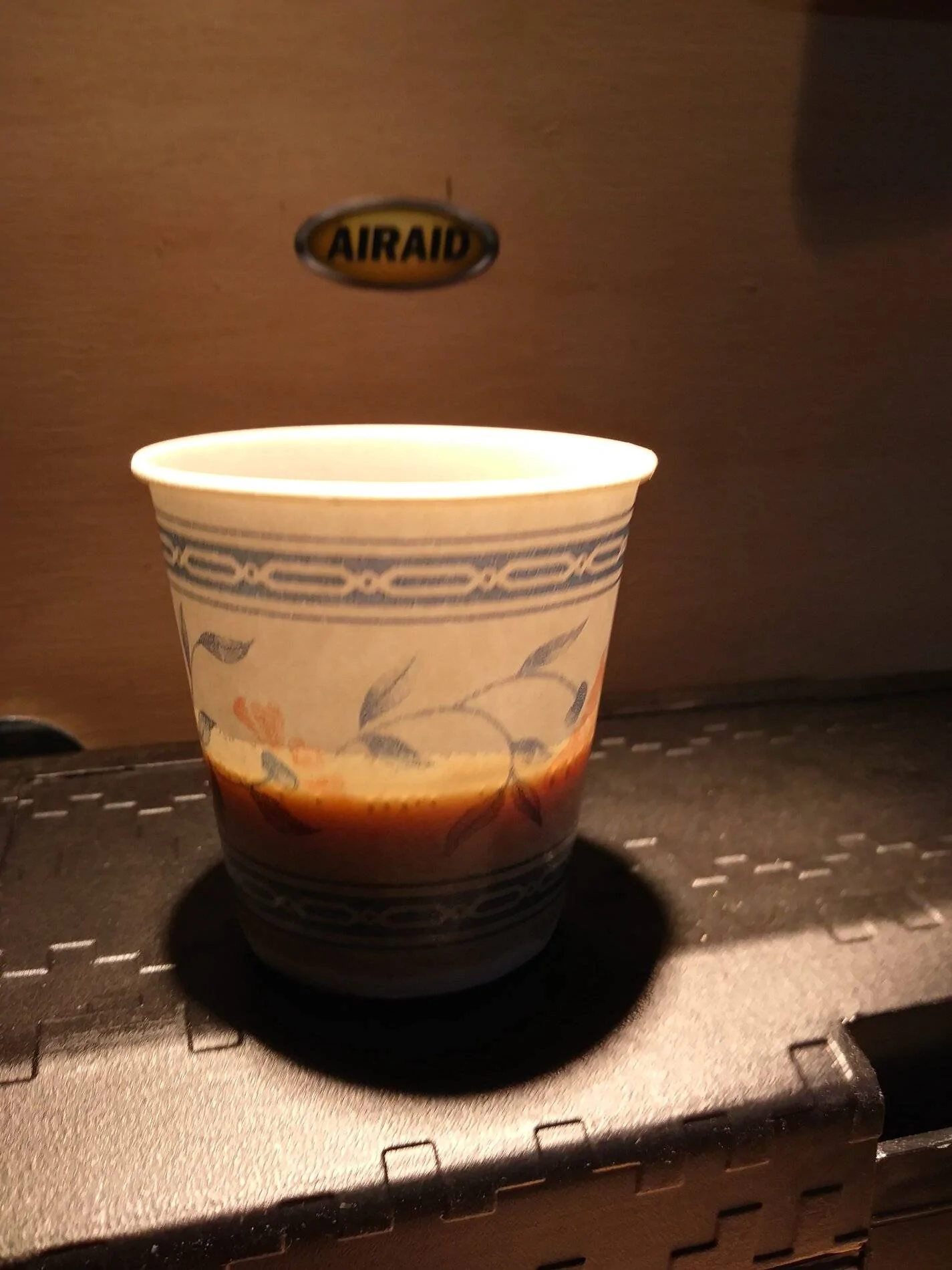

I have fewer than 2,500 miles on my naturally aspirated GT. I haven't even tracked it yet, but today drained a couple of ounces of oil from a catch-can.
Your amount seems exactly in line with his numbers

Well, I'm happy to keep that trapped oil from going back into the engine. It's not a "scare tactic," just information for anyone who wants it. I haven't even given the car a decent workout yet.
I had catch cans on my supercharged 2011 and my 2017 GT350. I expect to trap greater volumes in this car when I get back on track next year.

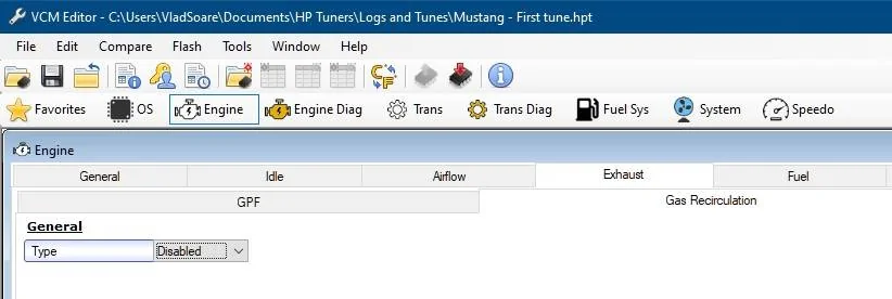

Speaking of the EGR and the way it's implemented in the Coyote, here's what I see in my car:
The options you can choose from are these:
Does this mean that it doesn't actually do any kind of exhaust gas recirculation? Or maybe this option is just for external EGR types, and it's disabled because the Coyote does it internally?

Those acronyms all refer to an external egr system. I haven’t seen anything in the program that seems to control cam timing for egr, except maybe emissions reductions vct but that appears to just work during cold start. That said, at cruise the cam LSA in old-school terms is about 115 deg which is pretty tight for oem so maybe that’s how it gets it.
