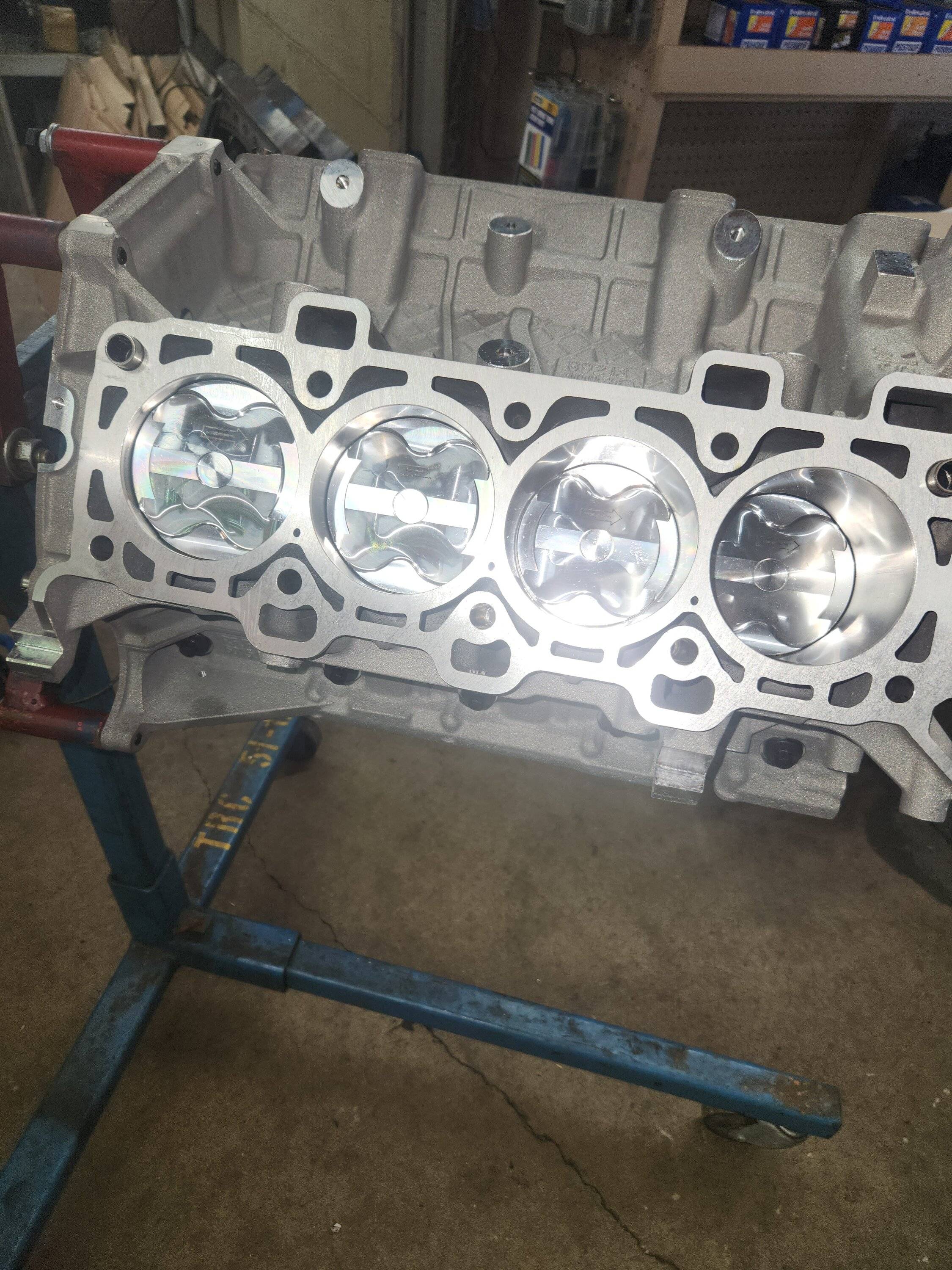

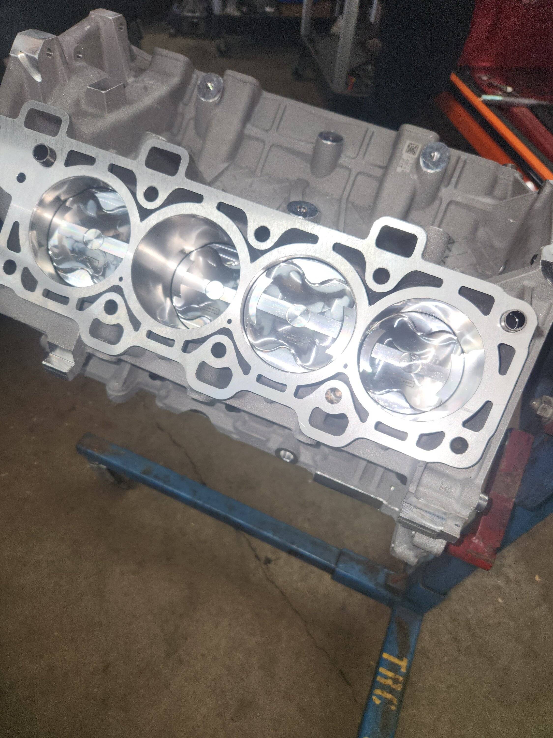

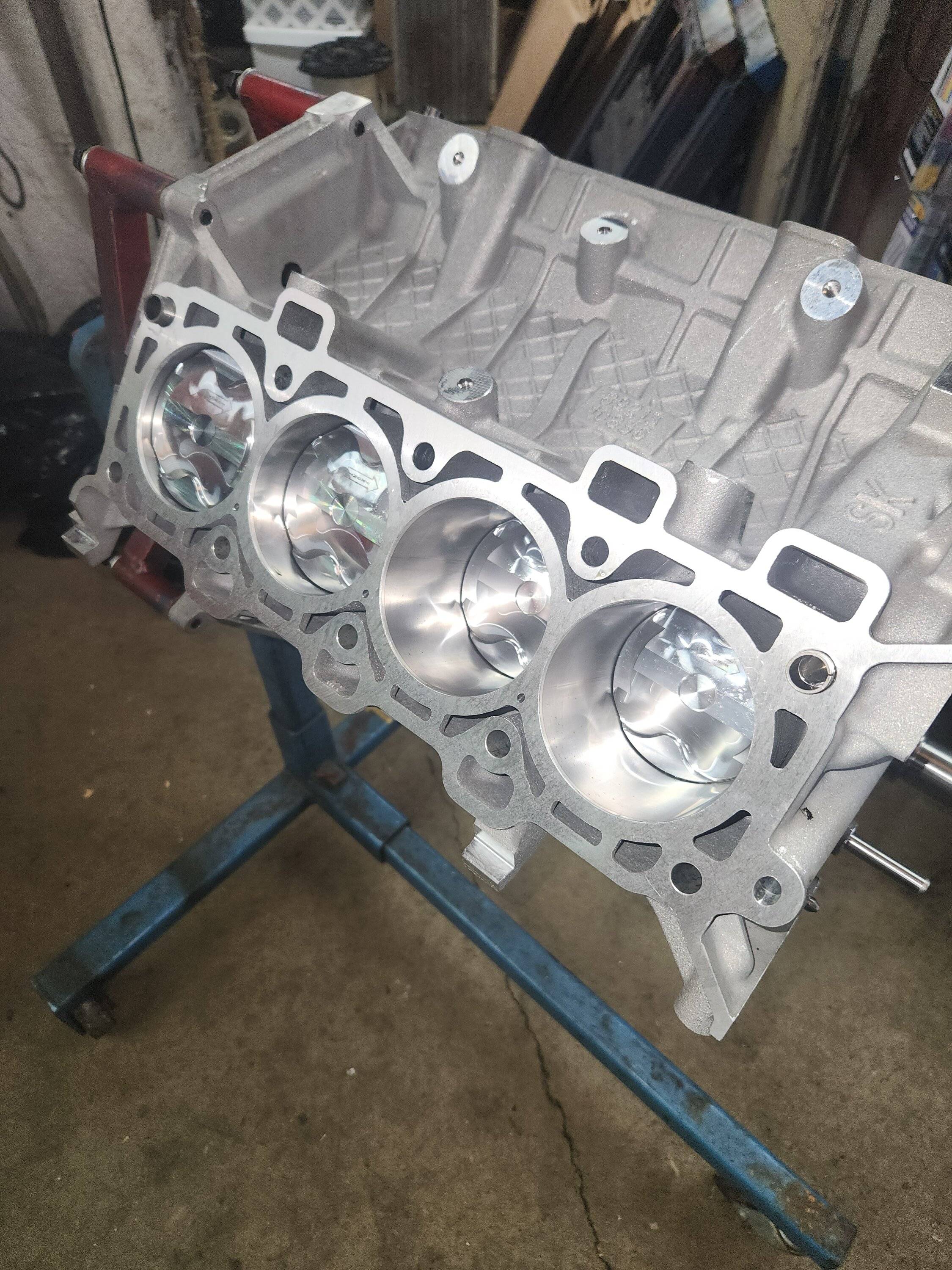

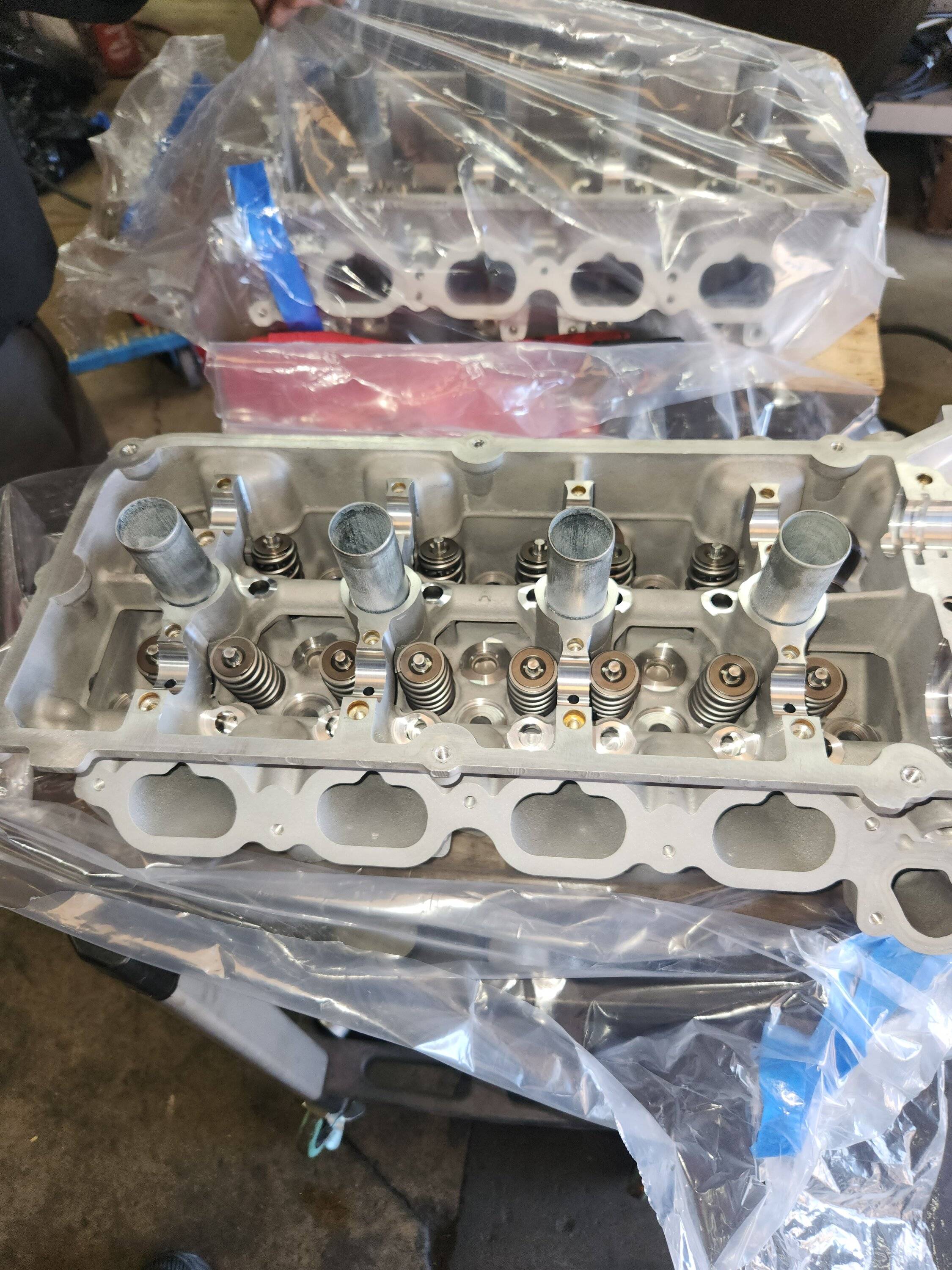

I am in the process of putting a built shortblock and ported heads together and re-installing it in my car. Is there a reinstall kit for those direct injectors? Or do I just reinstall them as is?
And here is some engine porn, for those so inclined.
