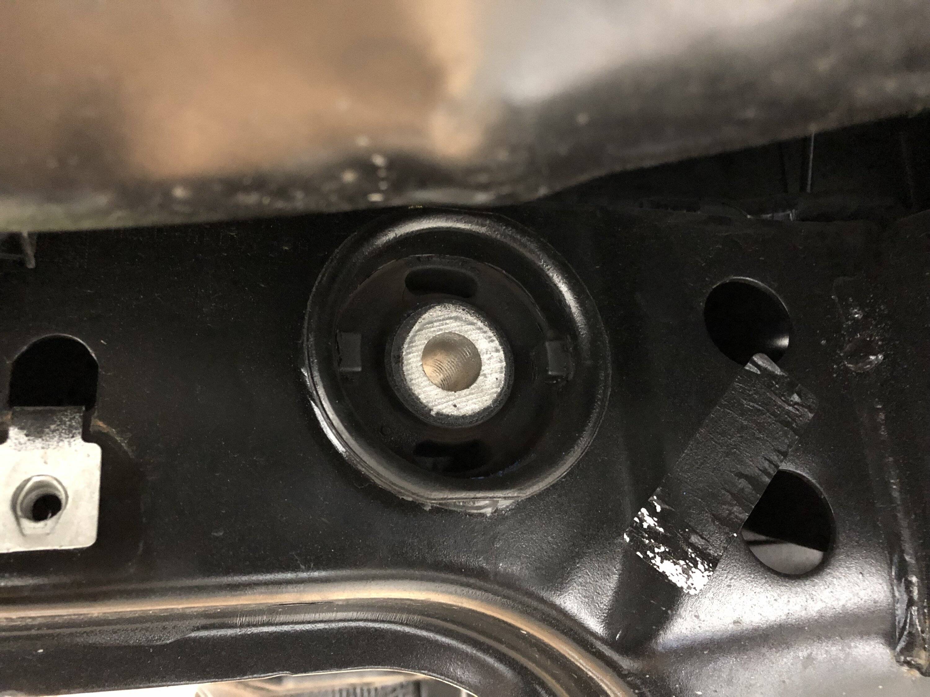

As there seems to be a lot of uncertainty, stick your head under the back and grab a photo of a rear bush.
If it looks like this (but with a flange head bolt in the middle - and note the spacing of the rubber tabs) :
Then it might be worth a trial fit of one of the standard Steeda inserts - just give us a shout if you think it’s worth giving one a try :like:
