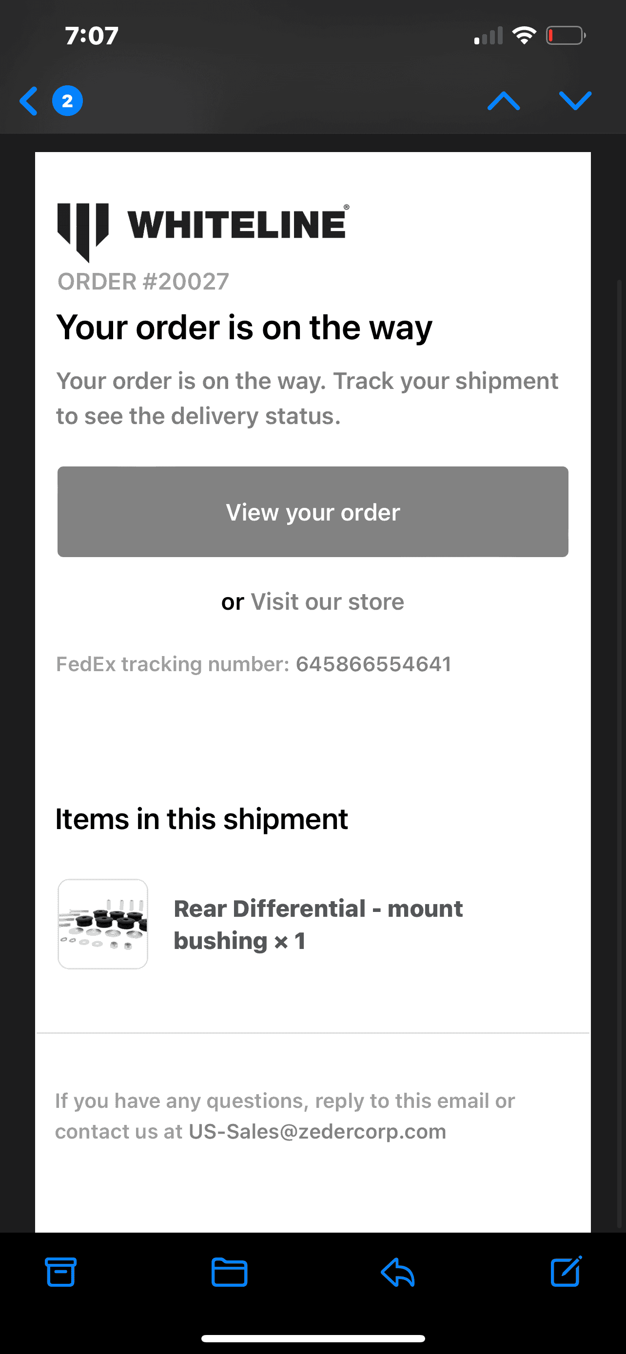

I just got this shipping notice, they much have the bushings back in production.
Cory S
Dec 10, 2019
3,355
3,751
Bradford, NH
Cory
2016 Mustang GT Premium
Yep! My bud just took out his BMR diff mount bushings because the rear end noise was insane. He bought the Whitelines and installed them this weekend. Noise has been reduced by 60% and the rides so much better too.
shogun32
Feb 8, 2019
92
16,223
14,019
Northern VA
by all means let us know what actually comes in the mail. I called California and they re-confirmed, no new production, no inventory, still discontinued with no plans to resume.
