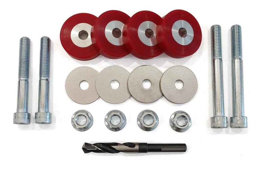

Hey everyone. I’m getting ready to install the red Steeda diff bushing inserts.
on the rear ones, with your car off the ground, the CjPonyParts video says just loosen the subframe bolts a little, and do the bushings with the car in the air. (Their video shows the car in the air on a 2 post lift with no support on anything)
the Steeda video and install instructions call for you to support the front subframe after you loosen the subframe bolts.
what do I need to do?
I only plan to do the rear bushings for now. Thanks.
I was working on jack stand's and had to drop the whole sub frame down to get the front one's in but the back one's are easy and almost don't even have to lower sub frame for them. Not sure how that will work, only doing the back bushes.

It would be a wise move to do both front and rear yes, the front are difficult, but if you are on a lift use a screw jack to lower the diff and subframe with front subframe bolts removed while keeping the rear only loosened the front differential bushing inserts are much easier to access that way
I have done this but not put to the test as I am seriously considering the bolt upgrade whatever the cost
A sheered bolt in a differential bushing would be a huge and expensive problem. Btw the differential bushing inner sleeve is aluminum (at least mine are), so be careful when tightening
Whatever you decide to do, good luck.

So whats the go-to soultion for a bolt on car on street tires that gets the gears hit correctly from time to time? I hear thuds ons shifts in the rear now, assuming a torn bushing, i have the steeda inserts in the garage. What's the recipe here?
Thanks all
GTP
Deutsche Pony
May 27, 2015
267
6,120
4,102
Indy
www.BambergAudio.com
Philip
Start by inspecting your bushings. Then add the pucks and gap sleeves. The fronts are difficult as many have reported. Either blow those off, put them off, or have a plan to drop the cradle quite a lot to get them in. (Applies especially to 2018+ cars with heat shielded fuel tank.)
