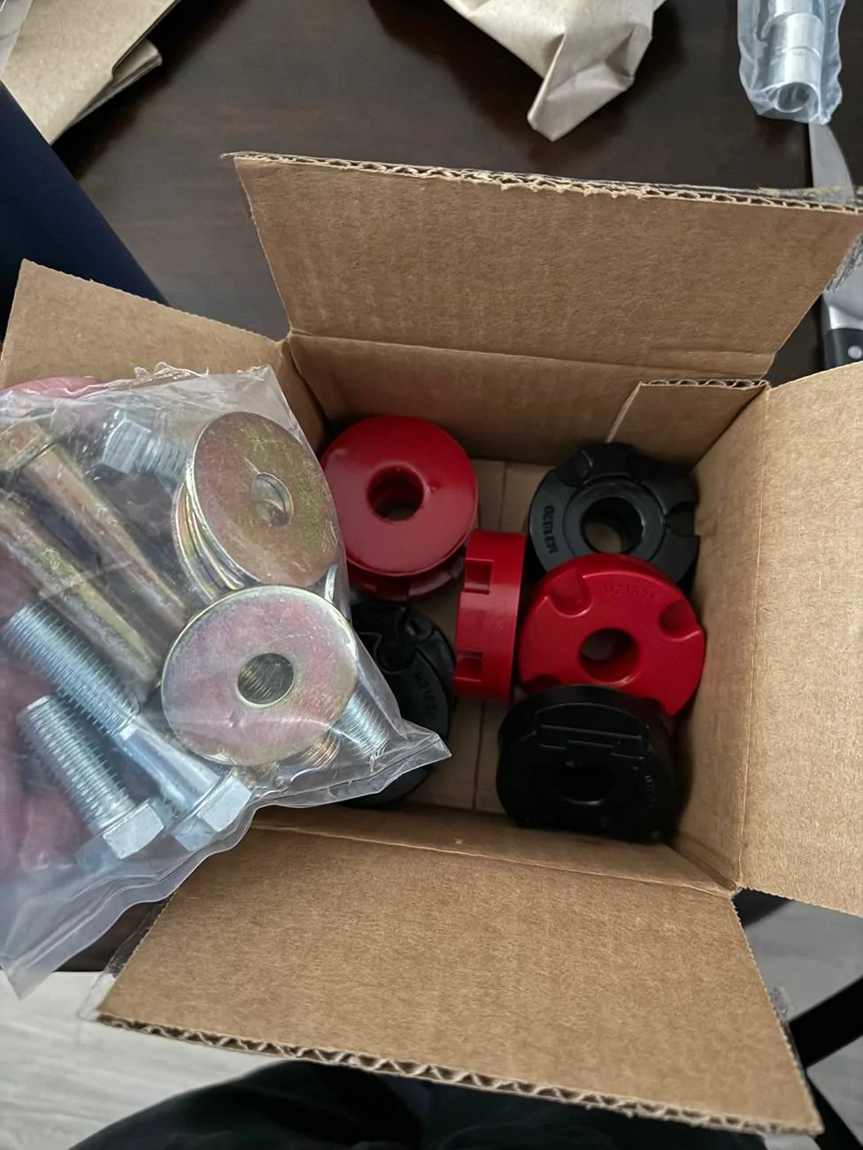

Hey everyone. I’m getting ready to install the red Steeda diff bushing inserts.
on the rear ones, with your car off the ground, the CjPonyParts video says just loosen the subframe bolts a little, and do the bushings with the car in the air. (Their video shows the car in the air on a 2 post lift with no support on anything)
the Steeda video and install instructions call for you to support the front subframe after you loosen the subframe bolts.
what do I need to do?
I only plan to do the rear bushings for now. Thanks.

What? I’m talking about the rear differential bushing inserts from Steeda. They come with supplied hardware. There’s no reason I wouldn’t be able to do just the rears, many people on this forum have done just that.

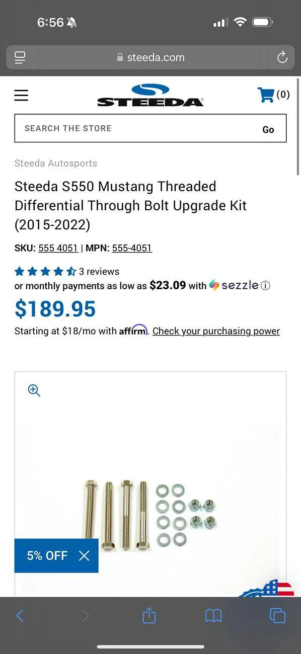

This???
NGOT8R
Jul 19, 2020
154
9,366
7,867
Adrian
2019 Bullitt
What if I just buy the upgraded bolts?
I’m afraid a shop isn’t going to want to throw them over the torn bushings and I certainly don’t want to/can’t do it myself.
If you’re set on doing just the rears, I would at least get the upgrades bolta.
Metz3020827
Metz3020827
Apr 25, 2024
423
72
Arizona
Connor
2017 Mustang GT
Can you link which bolts I exactly need to get? It’s not the 180 dollar ones right?
also I don’t launch my car at all. $180 seems excessive for 2 bolts
