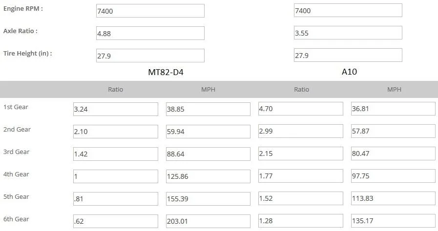

I really think he hit the nail on the head when he said it may be better for the overall everyday driving experience. 5th in the MT82-D4 is a great highway gear without the total overdrive feeling of 6th (in both the MT82 and MT82-D4). 5th to 6th in the MT82 really falls off, but 4th to 5th in the MT82-D4 isn't nearly the drop off. You can cruise around all day at 80 in 5th in the MT82-D4 without feeling the need to shift to 6th. 1st gear in the MT82 can also feel too quick and almost useless in everyday driving.
Now on the track, the MT82 is better with 2nd, 3rd, and 4th where you really only have 2nd and 3rd in the MT82-D4 (speeds up to about 115). However, on the 1320, you can trap the MT82-D4 in 3rd saving you another shift over the MT82.
So there are pros and cons to both gearing setups. It really depends on how you use the car. Personally, I don't mind the gearing in the MT82-D4 since I don't track very often. But, with the 305/30/19's on the PP2 only being 26.2" tall, it effectively changes the 3.73 rear gear to about 3.94 compared to the stock 27.7" tires on the PP1, which seems to help a little.

With the longer gear ratios of the MT82-D4, 4.88's are comparable to the A10 with 3.55's and makes 6th usable at highway speeds
