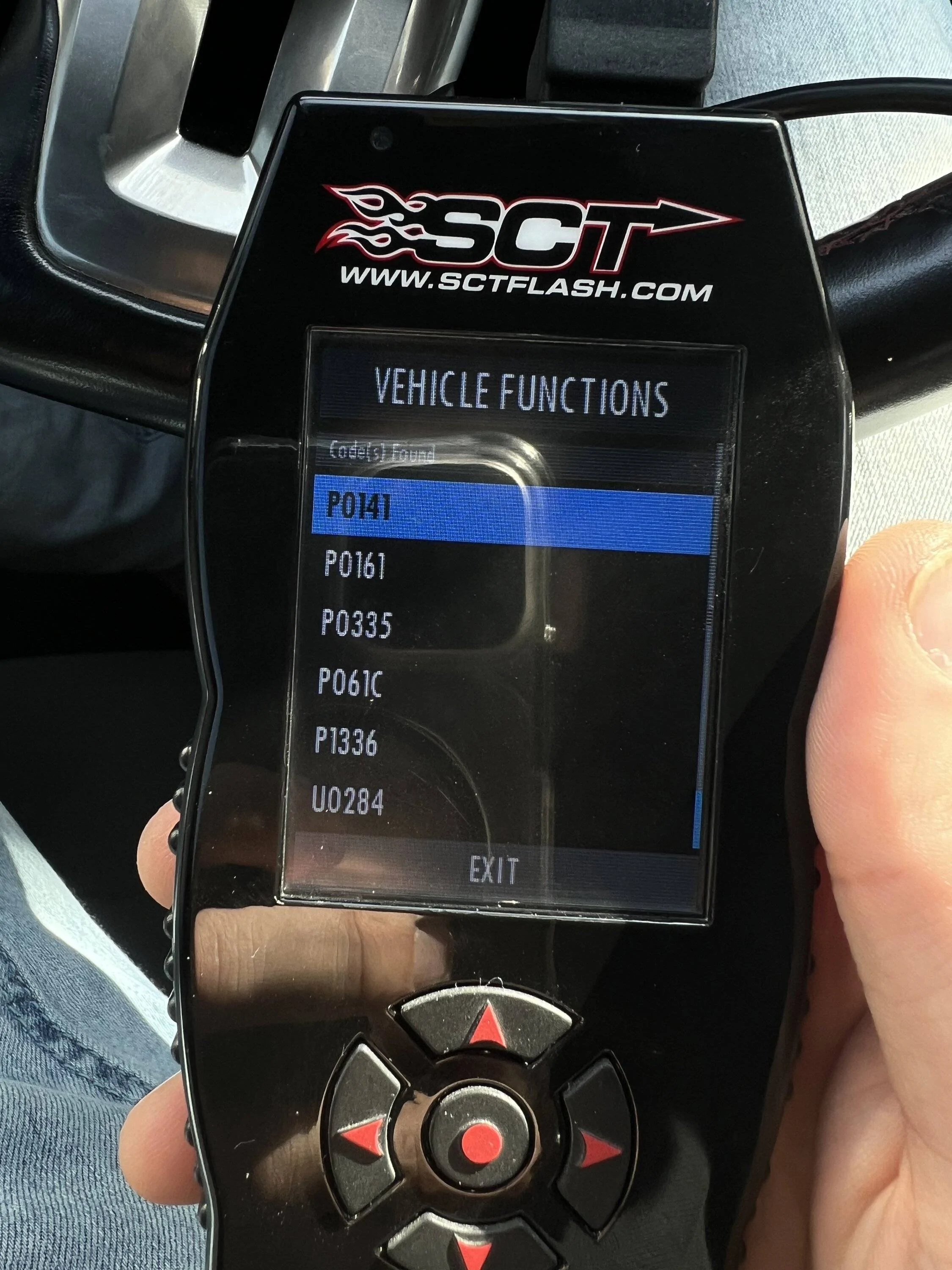

Put it in Neutral and rolled to the side of the road. Plugged in my scanner and got Crankshaft positioning sensor codes. What do I need to know about these codes? I’m towing the car back home, can i fix it in my driveway or do I need to send it to Ford?

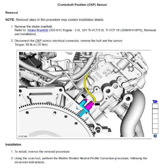

It's on the back of the engine. I don't know if you can get to it with the IM on but I'd think it is easier to get to if you take it off. Should be able to do it in the driveway.
Just looked at some diagrams online and I should be able to get to it if I take out the battery box. I just hope my timing isn’t off.

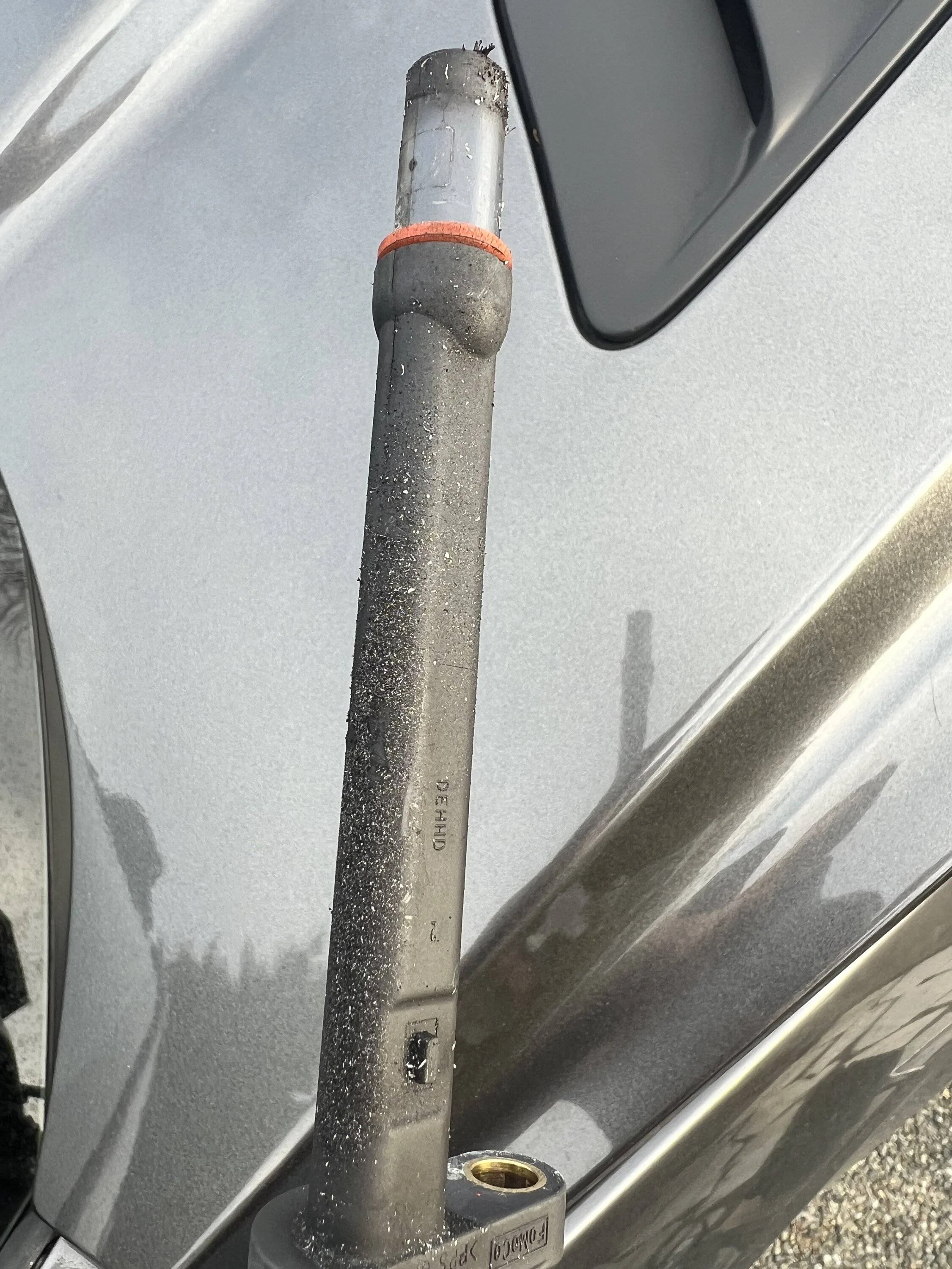

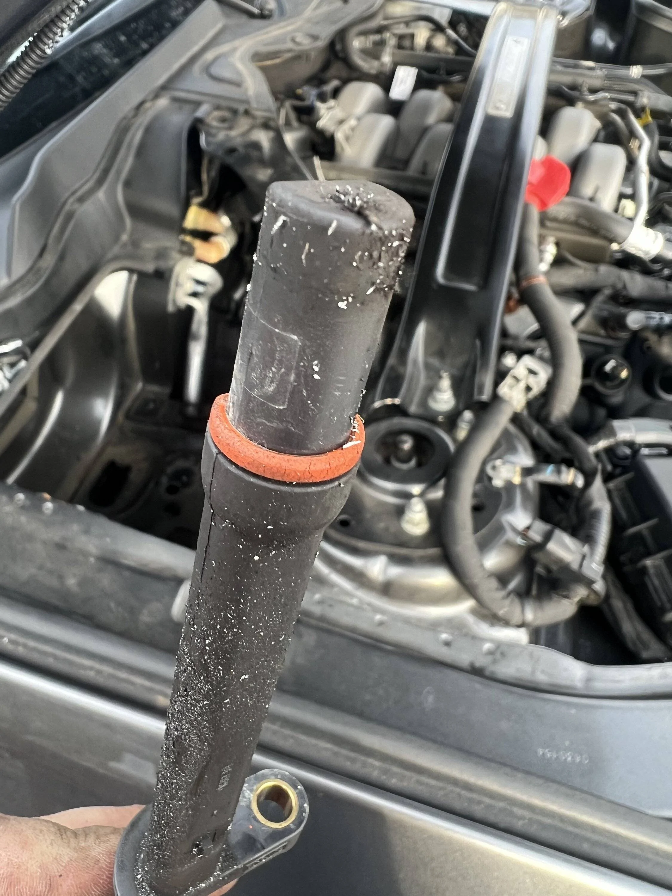

Alright, those who know and aren’t speculating, how does it look? It has metal shaving on the crankshaft sensor (Yes I’ve grinded a gear or two in the past) Are these shaving normal wear and tear or something worse?

Something letting go in the clutch is very likely, based on the issues you describe (getting into gear and the engine dying when you slowly release the clutch). If not that, perhaps a broken tooth on the flywheel or crank trigger wheel.
Tranny is definitely going to have to come out now for sure to get to the bottom of it. I don’t see any other way around it.
