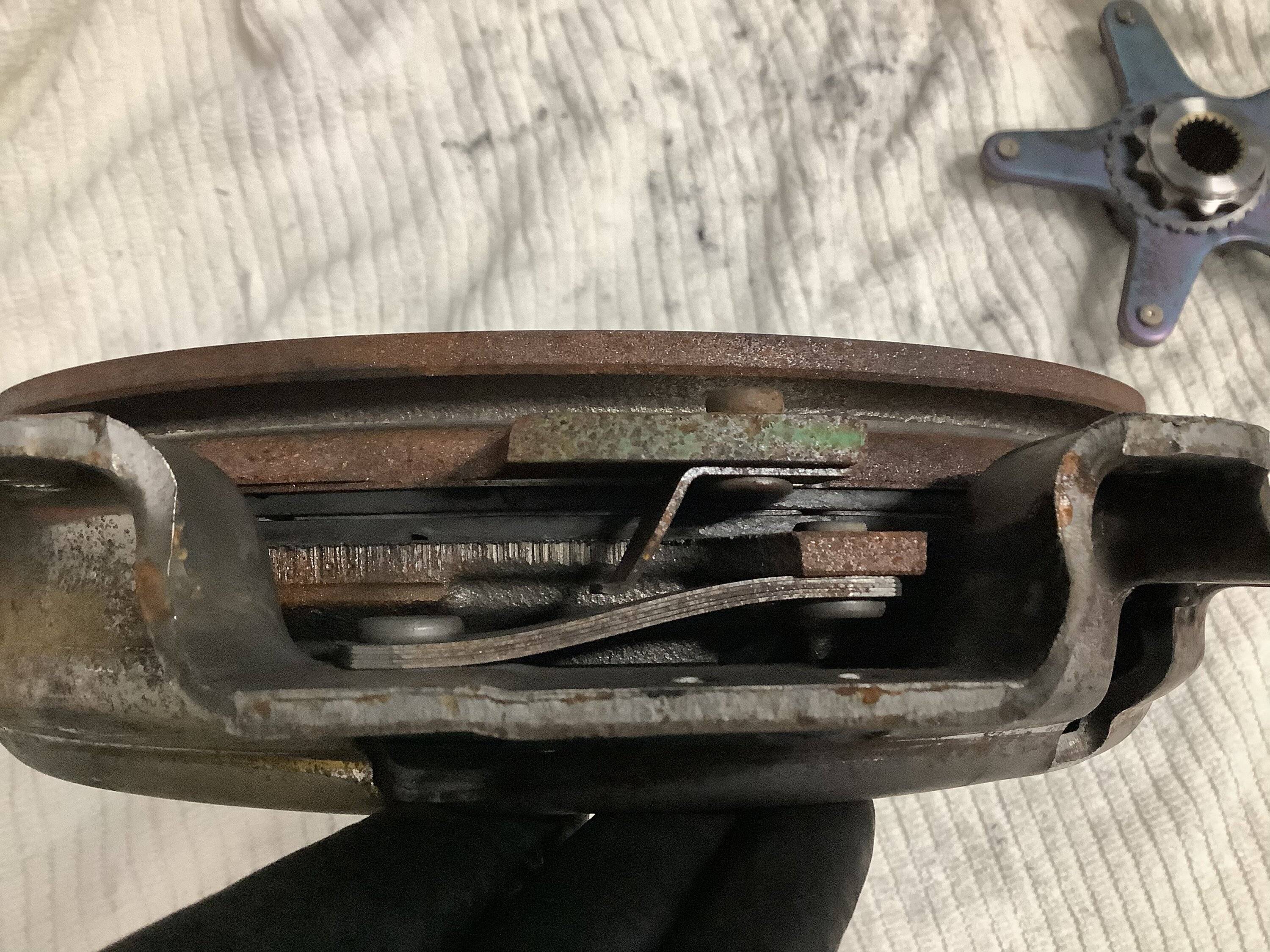

Something letting go in the clutch is very likely, based on the issues you describe (getting into gear and the engine dying when you slowly release the clutch). If not that, perhaps a broken tooth on the flywheel or crank trigger wheel.
Tranny is definitely going to have to come out now for sure to get to the bottom of it. I don’t see any other way around it.

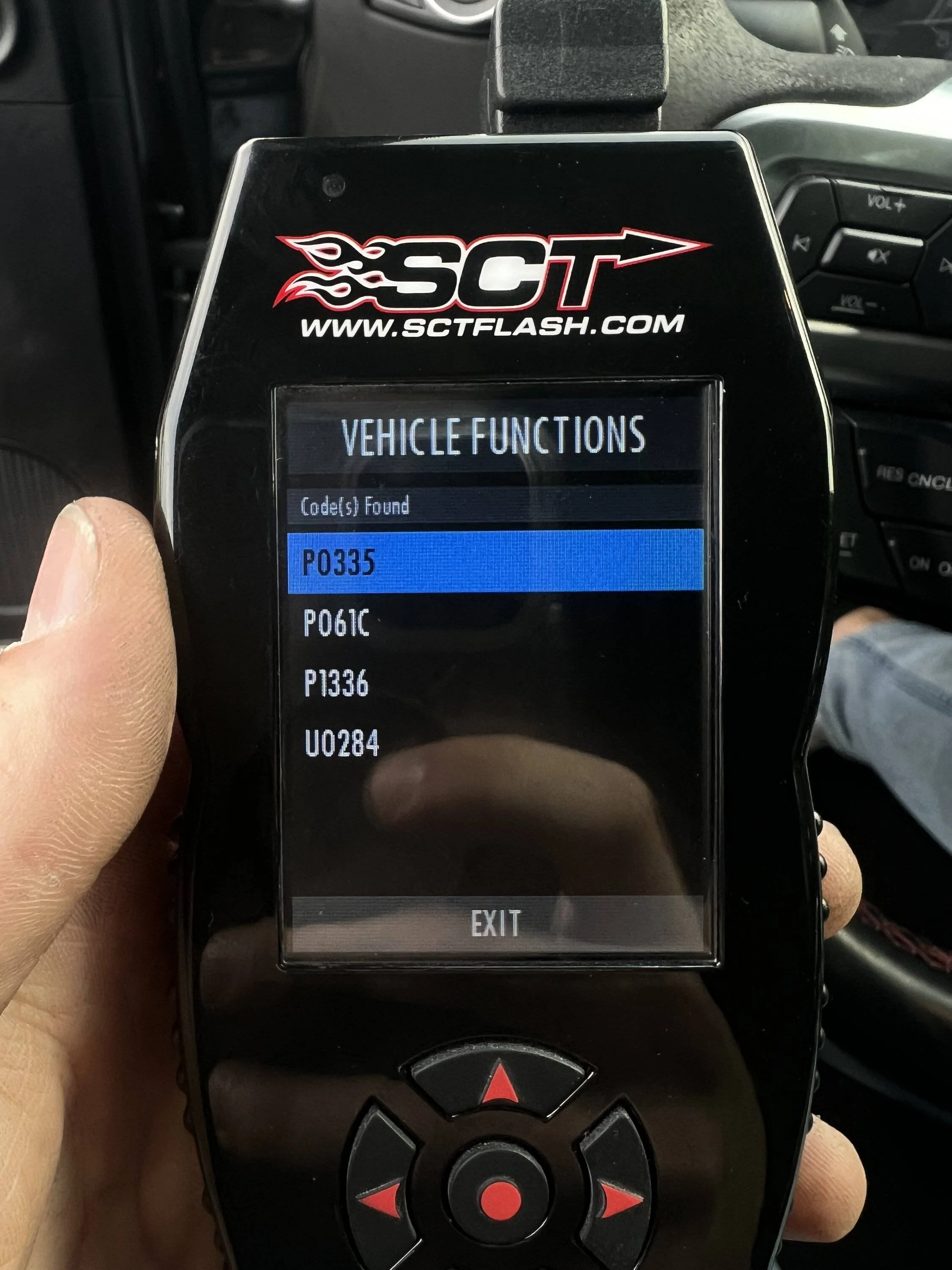

After pulling the Crank sensor, cleaning off the metal shavings and reinstalling it (just to test if it’ll work), the car still has the same issues but the misfiring codes went away and these codes remain.

The factory clutch (assuming that’s what’s in the car now), is open on the sides, to where debris has an avenue of escape and can be easily picked up by the magnet.
P0335 is a Crankshaft Position Sensor "A" Circuit Malfunction
P061C I believe is related to the P0335
P1336 is also related.
Is the timing off now?
The U0284 is active shutter?
Deleted member 69311
Guest
Yeah I took out the active shutter grille. Temps actually went down.
I’m aware of what the codes are I just don’t have the knowledge of knowing if it’s just the sensor or the car is out of timing.
I also want to know what crank relearn is and if I should do it when the new sensor comes in?

The metal is very concerning and is clearly the result of a failure of some
sort. As much as it might suck to remove the tranny to get to the clutch and crank trigger wheel, I recommend doing it. I wouldn’t trust driving it until you can locate and address the problem.

The metal shavings can also be from the starter engaging and disengaging the flywheel over and over. Pull the starter out and look into the hole and make sure there aren't any broken pieces, damaged teeth on the flywheel etc. If the clutch failed, you would feel it in the way the pedal feels.

Clutch pedal feels smooth still. Shifting as well.
