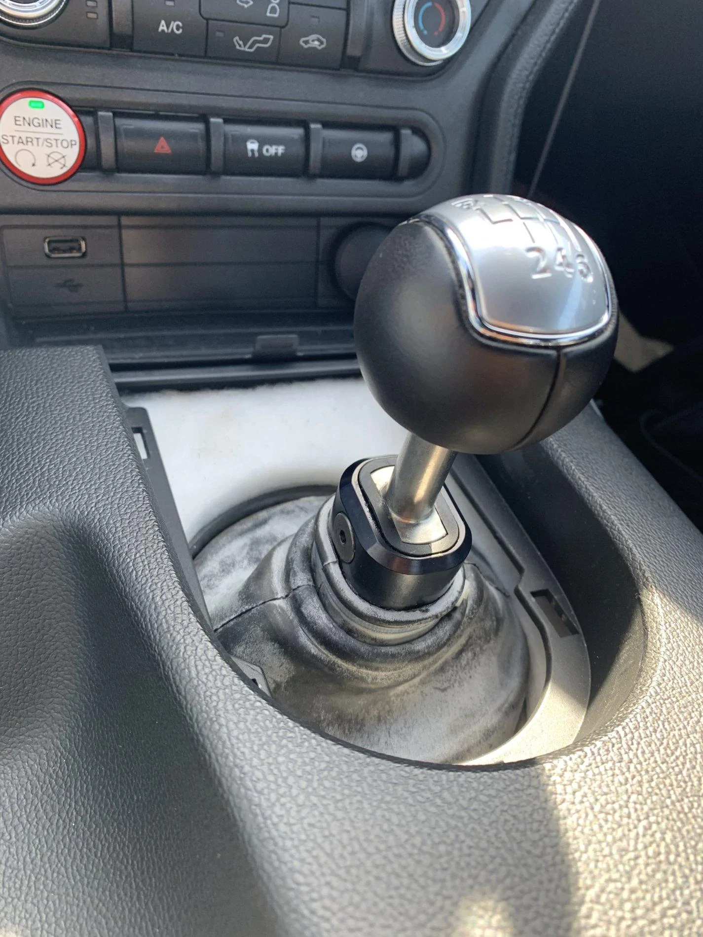

Holy crap... This shifter is AMAZING. I don't experience the jerkiness of the stock shifter and this feels so reinforced to the transmission. The weighted knob paired with it makes shifts feel really solid. I pushed it a bit and the shorter throws are outstanding. I went with the race spec, low-profile if anyone is curious.
I didn't have to adjust my shifter either. It was spot on from MGW with the reverse lockout and hard shifts to 1st and 2nd.
Pics attached of course. If anyone is contemplating this upgrade, absolutely do it with a fluid swap. I feel like I'm driving a different Mustang that's how drastic of a change it feels like and the change is for the better.
Thanks guys for helping along the way too.
Looks good! Congrats!
Besides the solid feel, I think my favorite part may be the 2-3 upshift. Love those centering springs!
