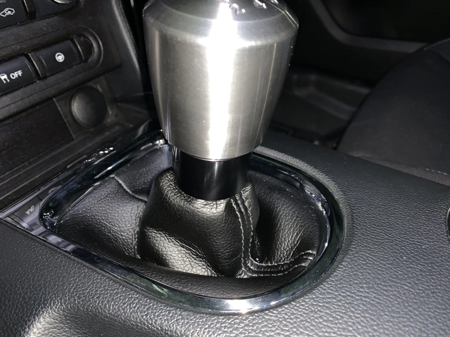

So I got the shift boot today and everything together. Without the reverse collar and big hands and the knob sitting lower, I wasn’t comfortable with the grip length so I added a spacer to give me for grip and it’s perfect. Very happy with how everything turned out

^ looking good!!
Glad you like it! It's a world of difference, eh?
