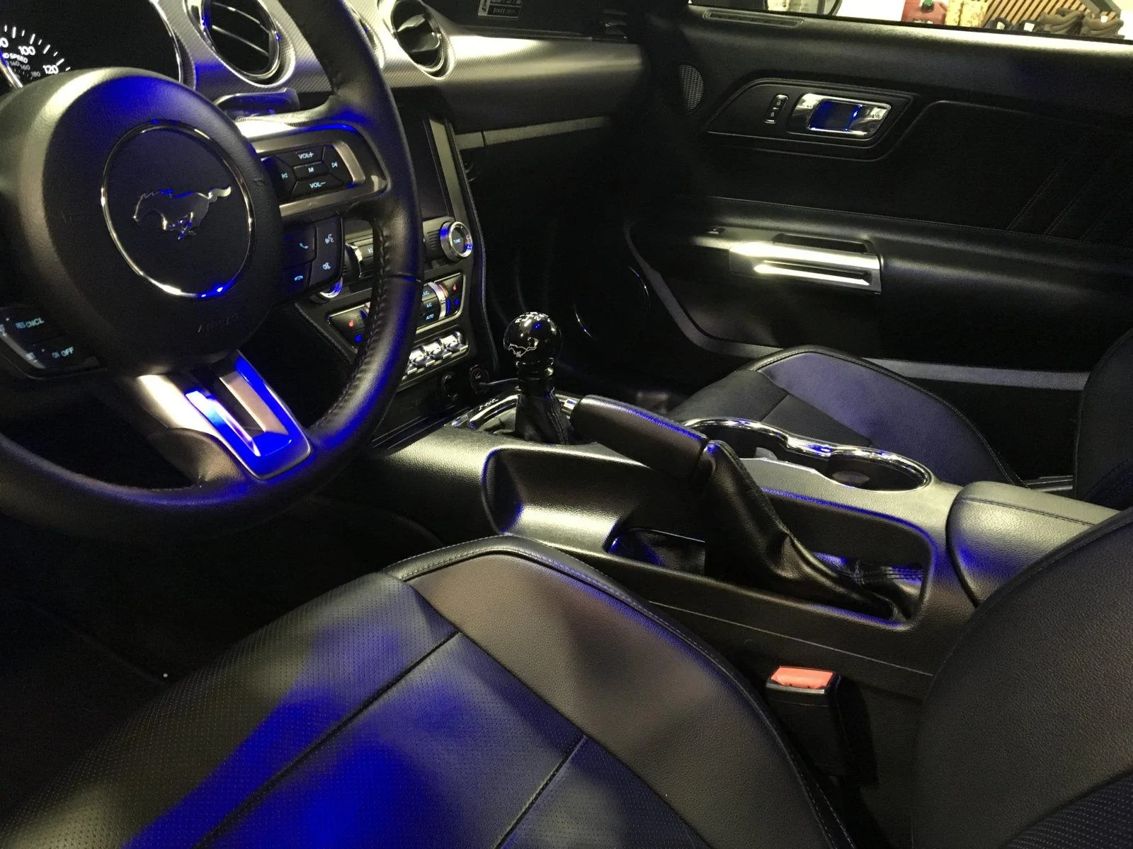

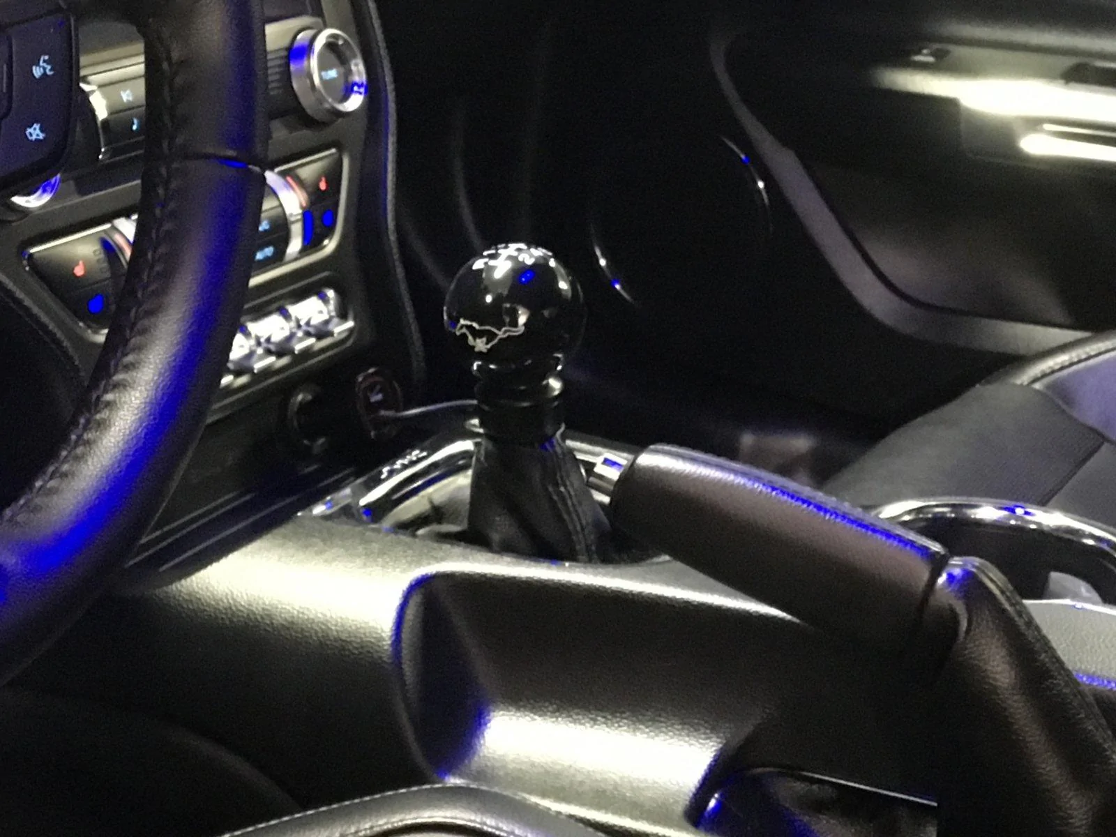

I love it. Shifting is easier/smoother than the regular round knob, which I had first with the MGW, and like you said, the shape is more conducive to how I like to shift (same as you pretty much).

I have the x-spec standard and love it, definitely not to low but again it may depend on the knob you get. Mine is just the ball and I’m glad I didn’t go any higher.
EDIT: but then again if I didn’t have the collar it would be lower which I might like better.
