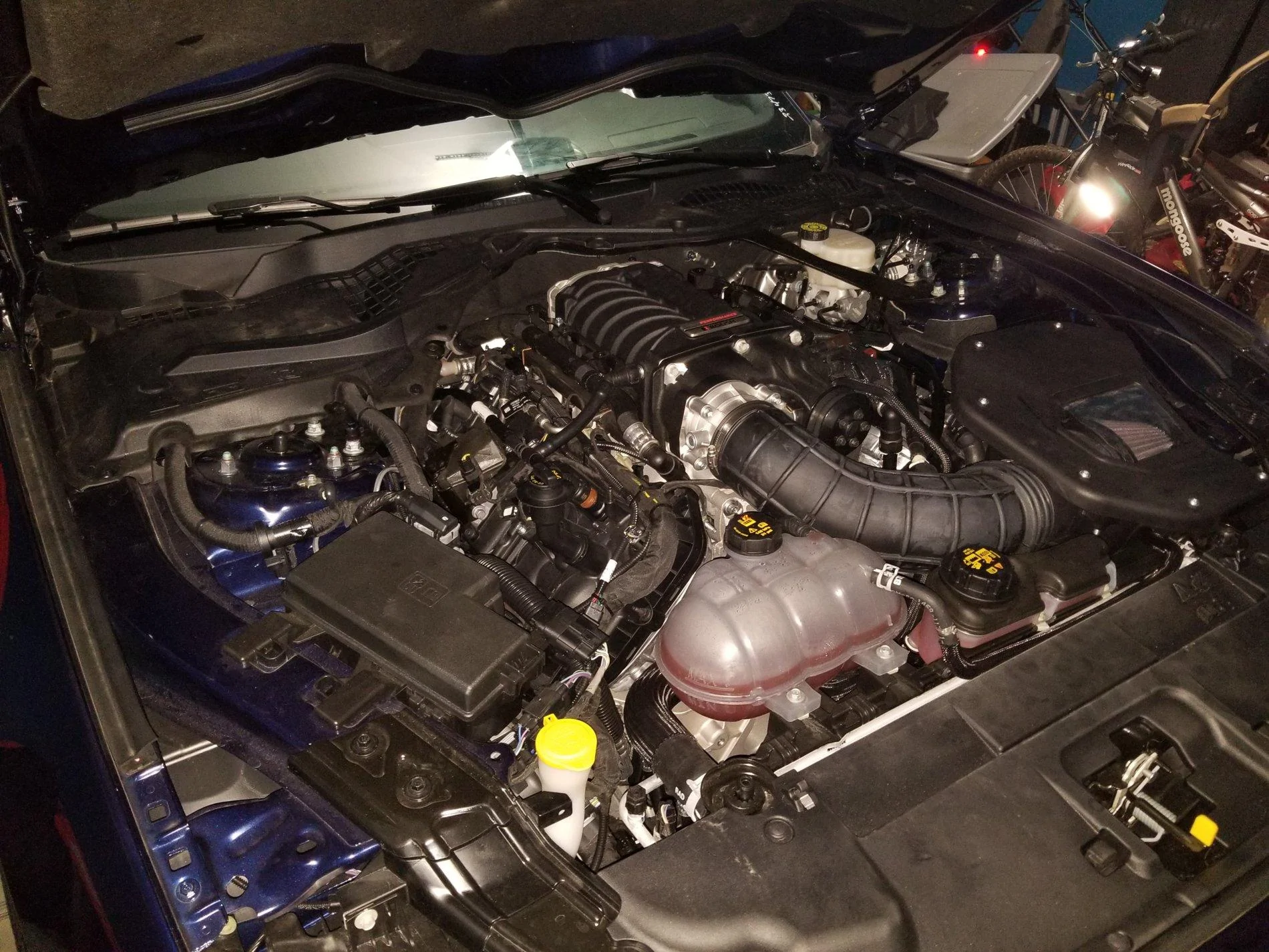

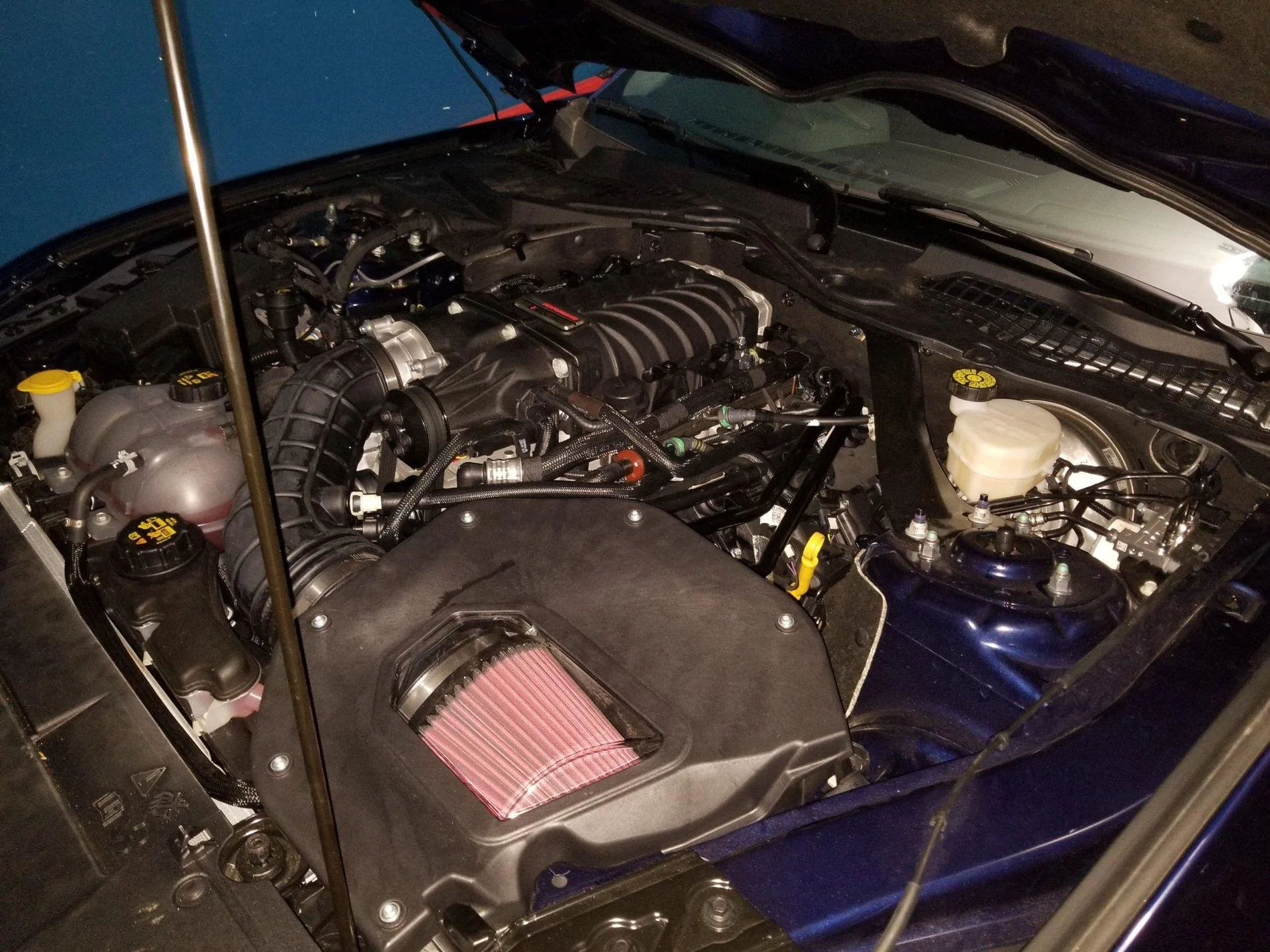

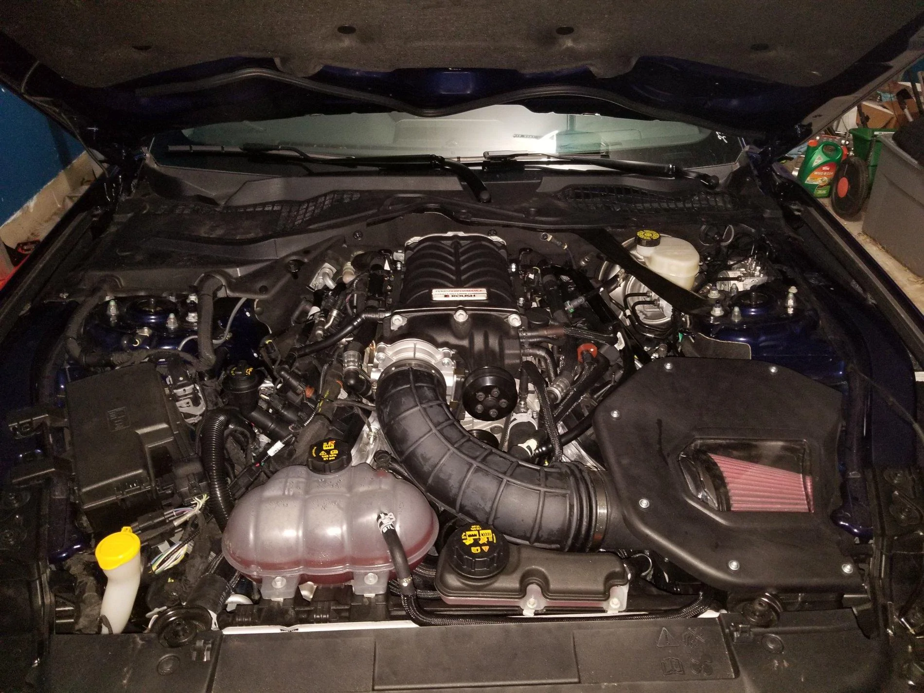

Can you share a pic of the your engine bay?
