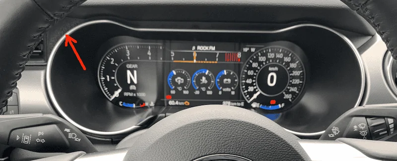

Another source of rattles (actually, it's more like a buzz than a rattle) is the silver border of the instrument panel trim.
This is on my to-do list, but I keep procrastinating because that trim seems to be very difficult to get to. You must remove a lot of things before you can even think of removing the instrument cluster trim, and I fear that removing so many trim pieces, which are all held together by cheap and flimsy plastic clips, might do more harm than good. I'm afraid I might end up with even more rattles than I started with.

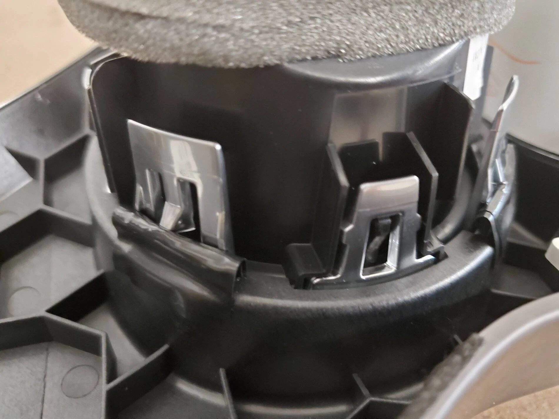

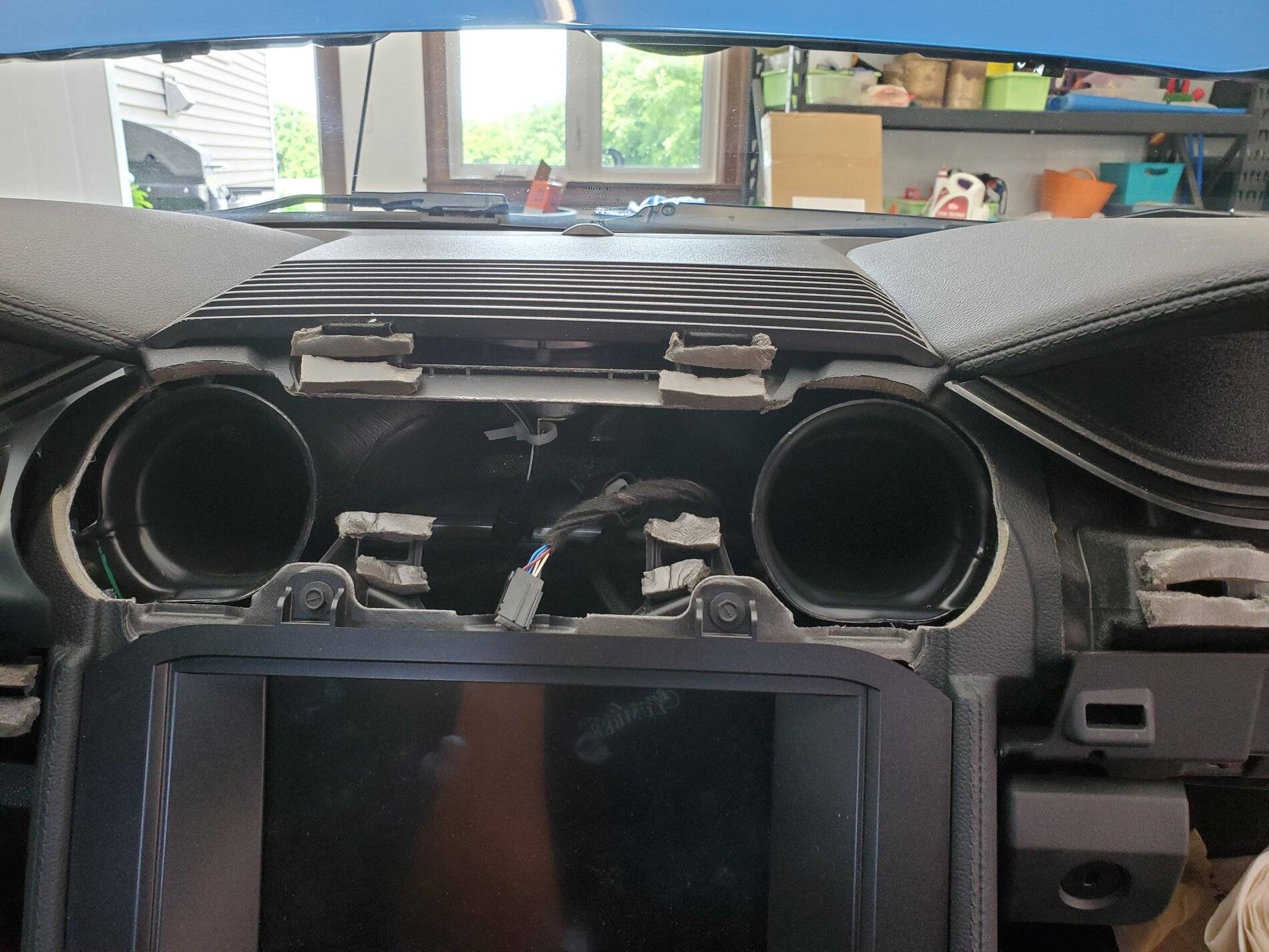

I took the dash plate off a few days ago and put on about 200 miles today - the dash rattle is fixed! I am pretty sure the rattle was coming from the left hand center stack air vent. I took it out and layered a couple pieces of electrical tape behind the tabs to hold it tighter to the trim piece. Then I also wrapped tape around the perimeter of the vents. I also put some foam weatherstripping behind the dash clips before snapping those back in. It is working well so far.
While I had the trim off I disconnected the center speaker. It actually does sound quite a bit better without the center! I used navigation today and the phone without the center speaker and had no issues whatsoever.
Just wanted to close out the thread - thanks!
