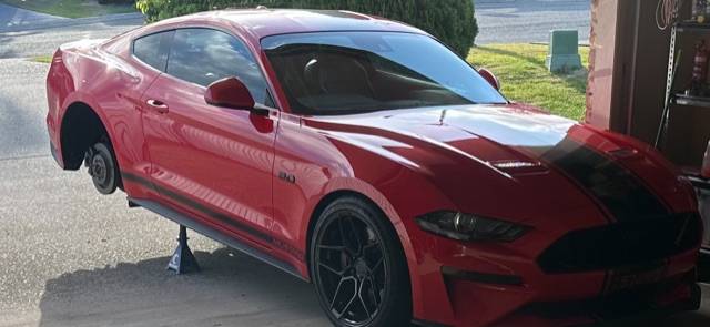

Ok I’m officially going insane, got the ass up again looking for that elusive rattling!!!
geez I hope I find something…. Something easy and cheap…
