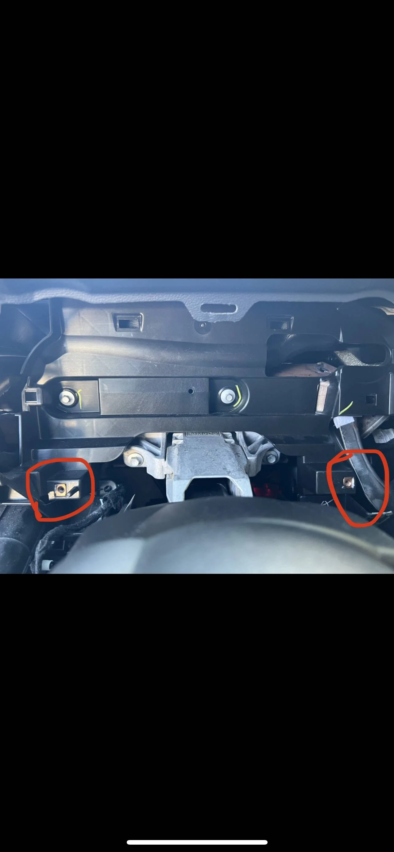

ether0
New Member
Nov 8, 2022
MIAMI
Someone
21' Ecoboost Premium Convertible
Okay guys - I had this same issue on a BRAND NEW stang. Was driving me insane, ended up being these metal tabs that support screws for the instrument cluster. If you have a trim kit, takes a few seconds to pull panels from both sides of dash and unscrew everything. I literally stuck a piece of paper between the plastic and the metal tab and noise went away.
