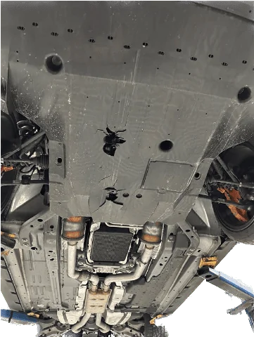

Hey guys hope everyone is doing great . Few days back when i was driving on highway i25 suddenly big rock came in my way and i couldn’t get chance to change lane because of other traffic. That damaged my cars underbody splash shield . Should I replace it or this damage is fine? Let me know your p

Check or ask around for a body shop or plastics shop, that can weld plastic. It could probably be plastic welded and patched enough to do it's intended job and would be cheaper than a whole new underbody panel. I've seen some guys who can plastic weld really well!

The main risk IMHO is that the cracks get worse over time and you end up losing chunks of it. You could just run it for a while and try to inspect it from time to time.
The airflow isn't as clean over those damaged sections, but its hard to say you'll notice.
My car, I'd probably replace it.

In the interim - go to Home Depot and pick up the black roll of Gorilla duct tape.
The Gorilla tape won't come off in various weather conditions like other duct tape. Tape over the large impact holes so while driving, the airflow isn't trying to pull the pan down through the holes... Last thing you want is that pan cracking more and coming apart at speed.

I seen worse in WW1 but I would change it. I don't like things to be broken, cracked or just not perfect as OEM or better. But that's just me. Im picky, Picky, PICKY!!

I would replace it if the vehicle was mine as well . I don't think I'd want to do any plastic weld, however, I would do what was suggested about gorilla tape in the mean time just to prevent it from getting worse until you can replace it.

I also recommend going through the dealer, so the correct one is ordered based on your VIN.
I know the PP vs no PP under cover is slightly different for the GTs.
Before ordering.. take a look for missing or broken screws and clips. There's over a dozen mounting points on the stupid thing. My local dealer keeps none of this hardware in stock.
Another reason to consider replacing it would be of you use jack stands to work under the car. With low clearance, those jagged corners will snag stuff like skin and clothing as you drag the cover across yourself uninstalling and installing it.

Thank you and yes I did order with dealership and he gonna replace it for me as the car already in dealership and stuck for few days because of winter storm here
