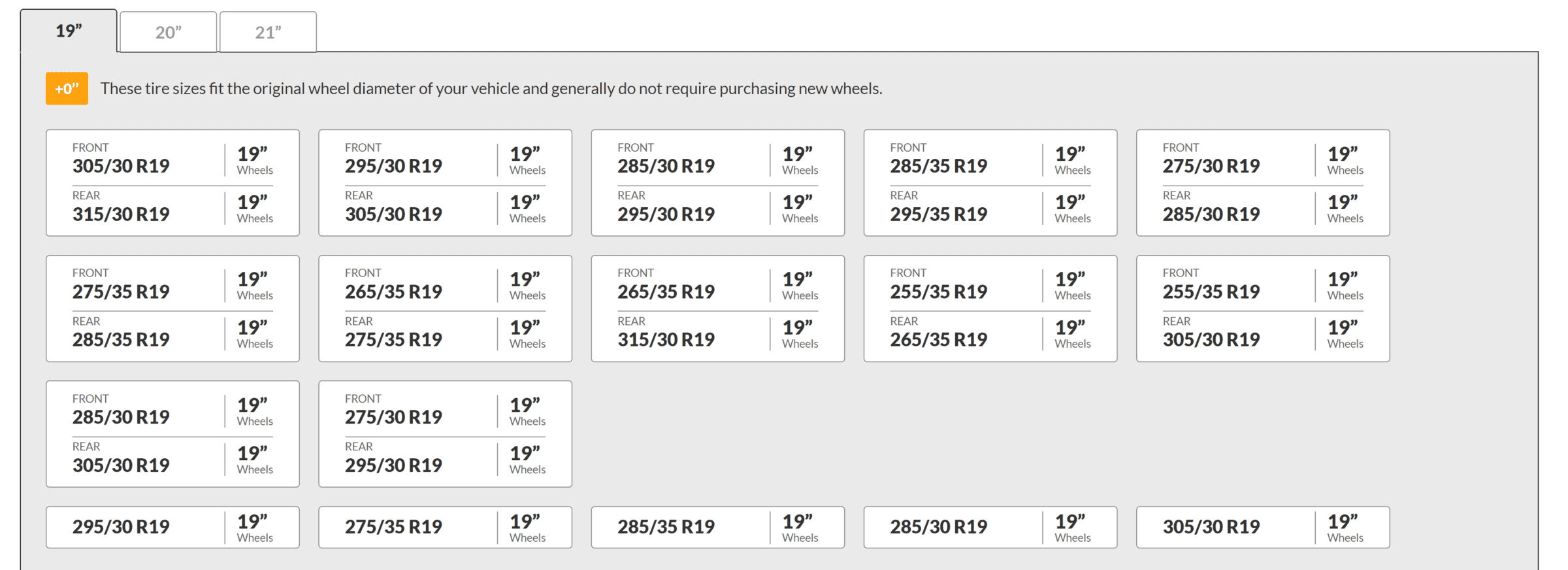

Since I am in the north east my biggest concern for me is hydroplaning. So far I have come to the conclusion that Pilot Sport 4 S is good enough to put my life in. The standard 305/315 look great but are a big difference from the 195-225s you'd find on normal cars and will hydroplane more. Tire direct has a nice tool that can show you different setups.
I've come to the conclusion 285/35 front, and 295/35 rear would be my best bet. I can do a staggered side to side rotation when the time comes. Another is 285 all around and figure out rotation from there. I wonder how much it would be in added costs to unmount all the tires and do a proper rotation. I'm looking to hear other people's opinion. How much WORSE or BETTER would wet handling/braking be with this setup compared to FWD vehicles.

Unfortunately the max size of the All season 4s is 285. Now it's a question of should I go 275/30 front and 285/30 rear, or 285 all around. Fit wise I think 285 on 11 wide is doable. But maybe I should go 35 aspect since they aren't as wide as 305-315
I had 285/35/19 on my last GT on a square setup with 19X10's and it worked out well. I think they'll fit on 11 inch widths with a slight stretch. 305 would probably be better for 11 inch width but you said that's not an option.
In order to maintain tire diameter you need to go to 35 series if going from a 315 to a 285.

Got my wheels but now seeing that 285 tires on 11in wide wheels causes excessive stretching of the tire. Need an all season/weather that goes to 295 or higher
