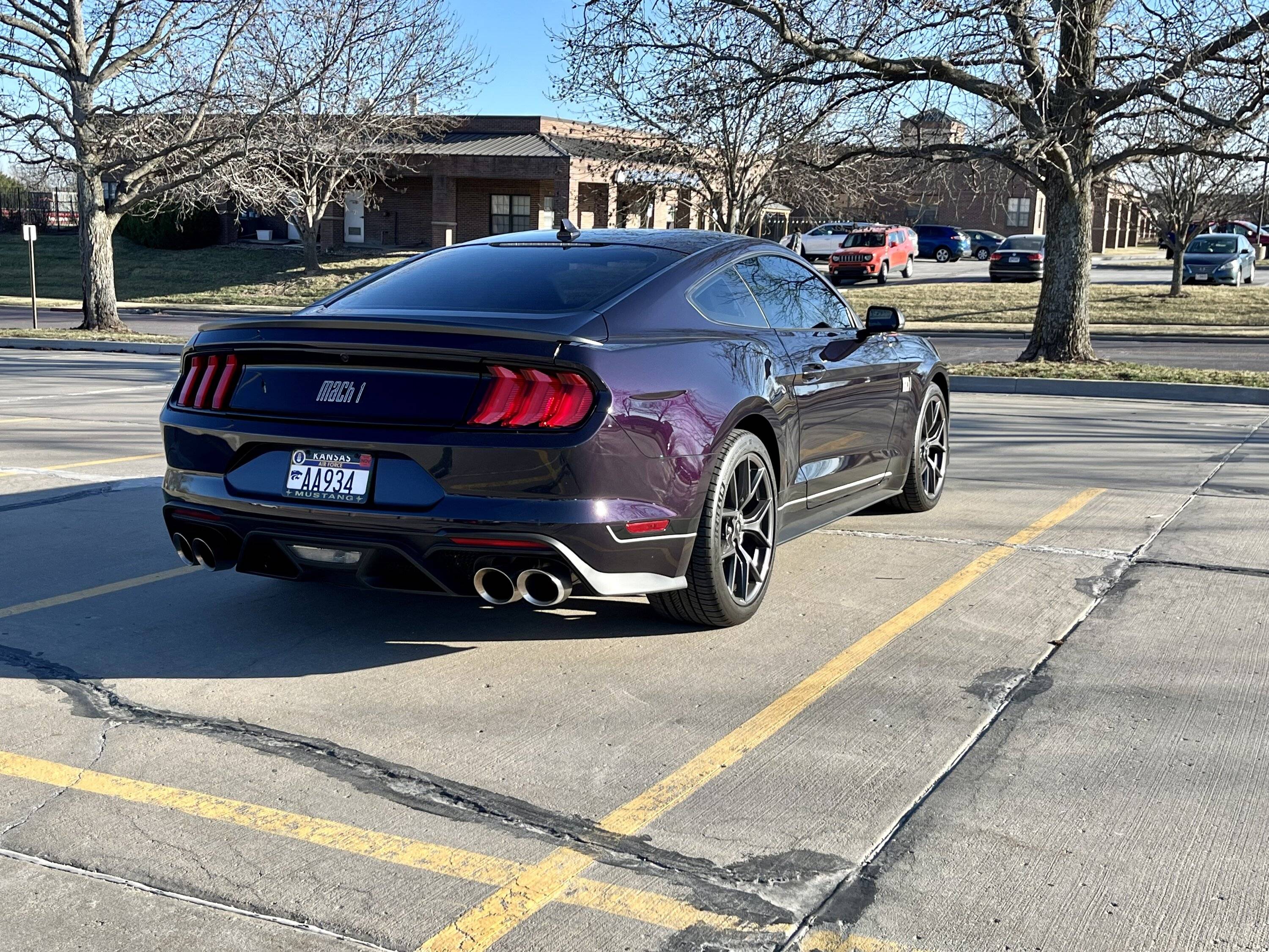

For all seasons I did 275/35 front and 285/35 rear but I wish I had 295 rear. Michelin pilot all season 4 doesn’t have that size.
Beautiful Mach !
I do notice that there is a larger gap in the rear for sure though

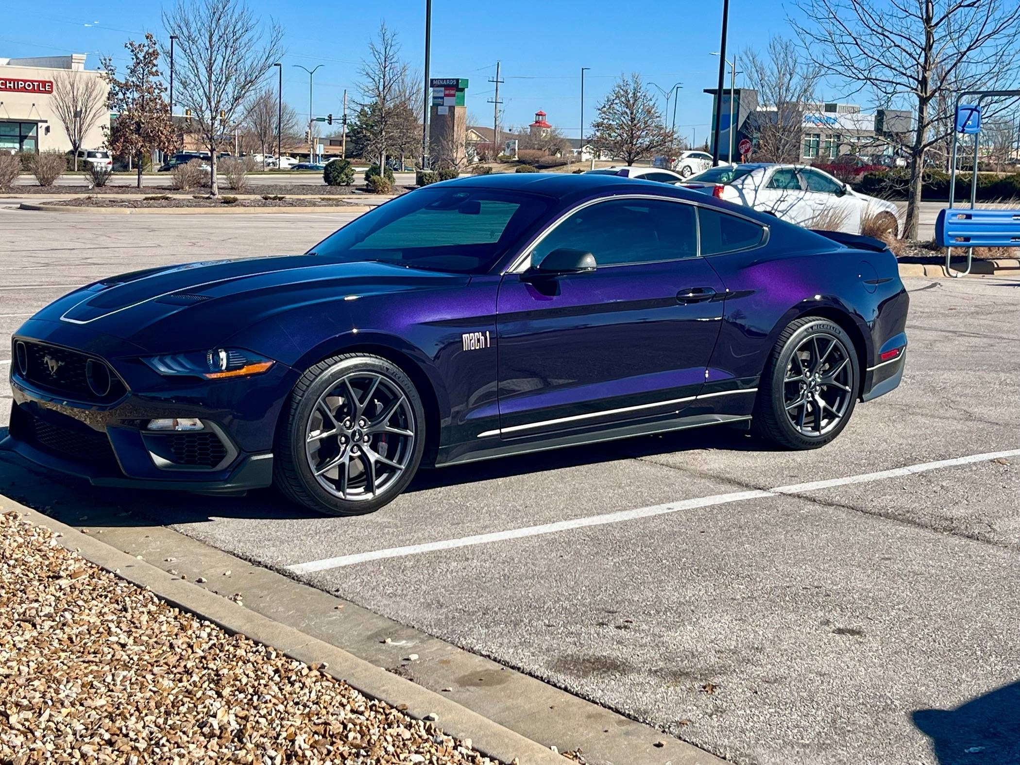

Another angle of 275/35 front and 285/35 rear. Doesn’t look bad but 295 in rear would look better. I wanted Michelin Pilot all season 4’s is the reason I couldn’t get bigger sizes.
from that angle it's not as bad. I was contemplating 295/35r19 27.1"diqameter in the rear and 255/40r19 27" diameter in the front. Do you think that's too much of a difference in width from front to rear? the rake would still be good
