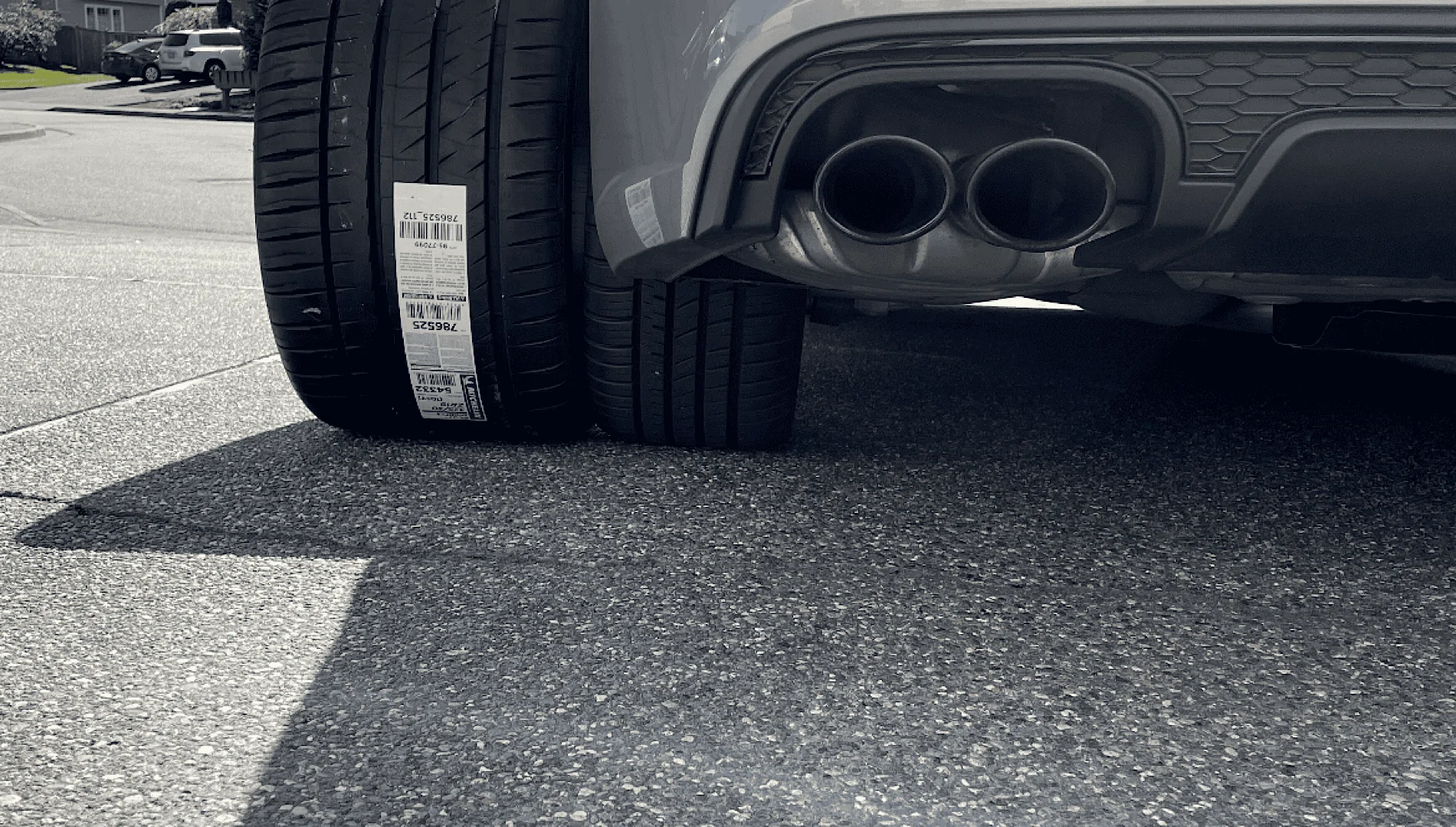

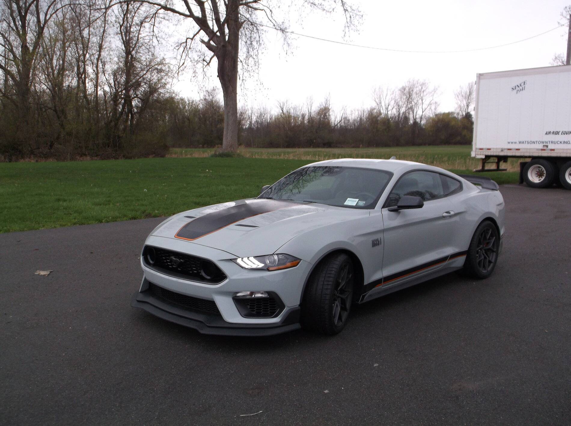

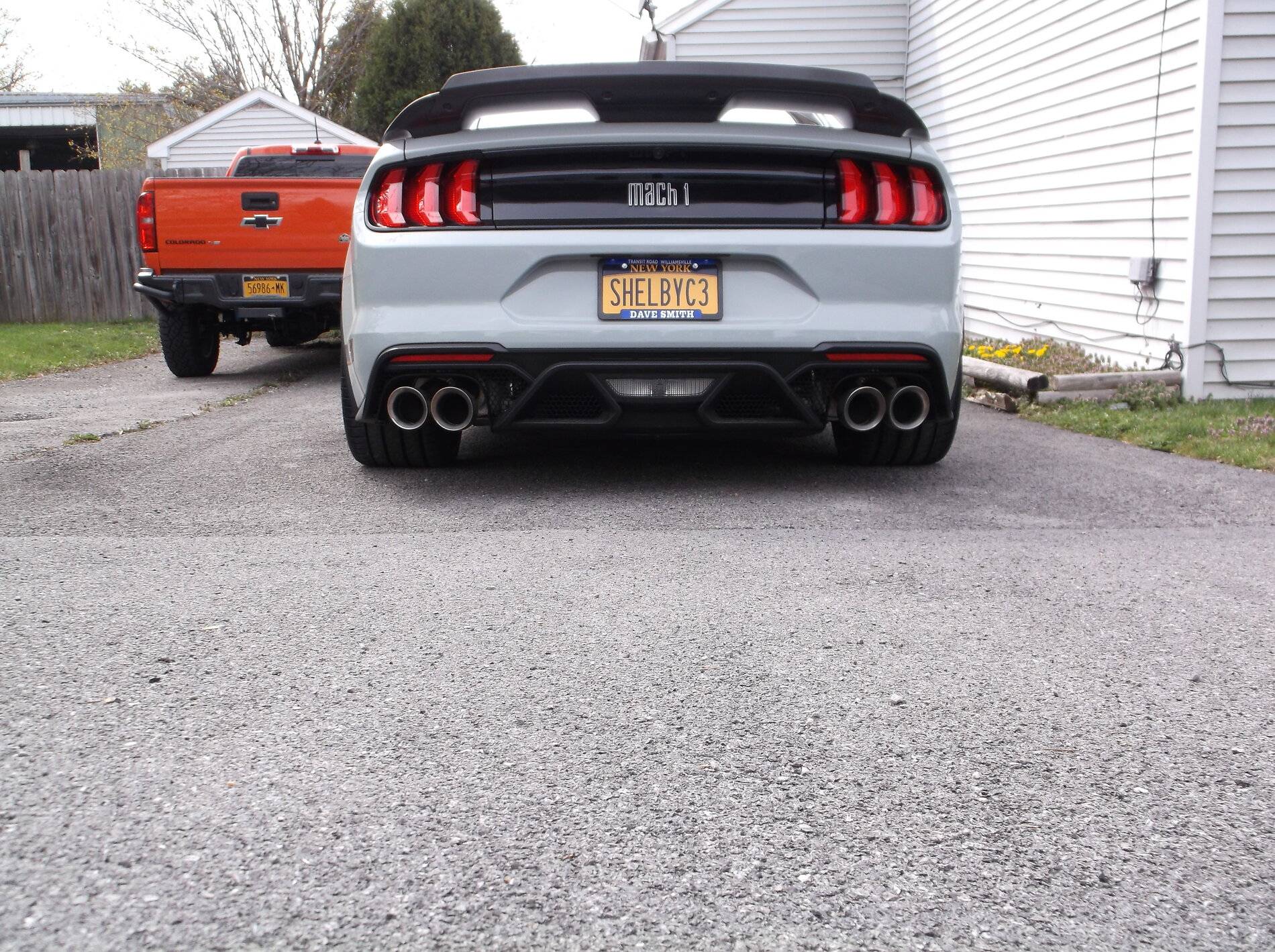

You be right, drove my HP on Thursday 39 Degrees and rain. (Had no choice) They held the road very well. Just take it easy in the rain, that car is no slouch. 305's on the front, 325's on the rear, Michelin XL Pilot Sport 4S.
How is the fit on the HP wheels? Have you had any issues with the electronics of the car with tht new rear size?
Nothing that I have noticed, still a 30, 315 vs. 325 only .394 of an inch difference in width.
The 325’s are sooooo wide!
