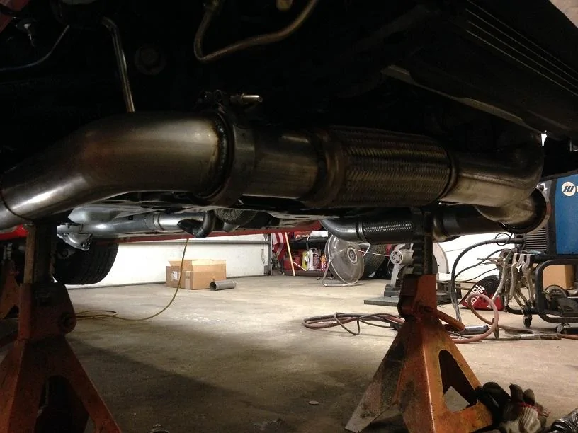

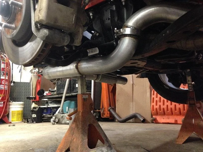

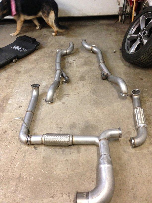

Got some work done this weekend
I got all the exhaust done with electric cut outs! cant wait to get this running again...... :headbang:

Hey I like the cutouts. I want to install a set on mine.
If you ever need a hand let me know. Looks like you got everything covered but if you ever need an extra set of hands.

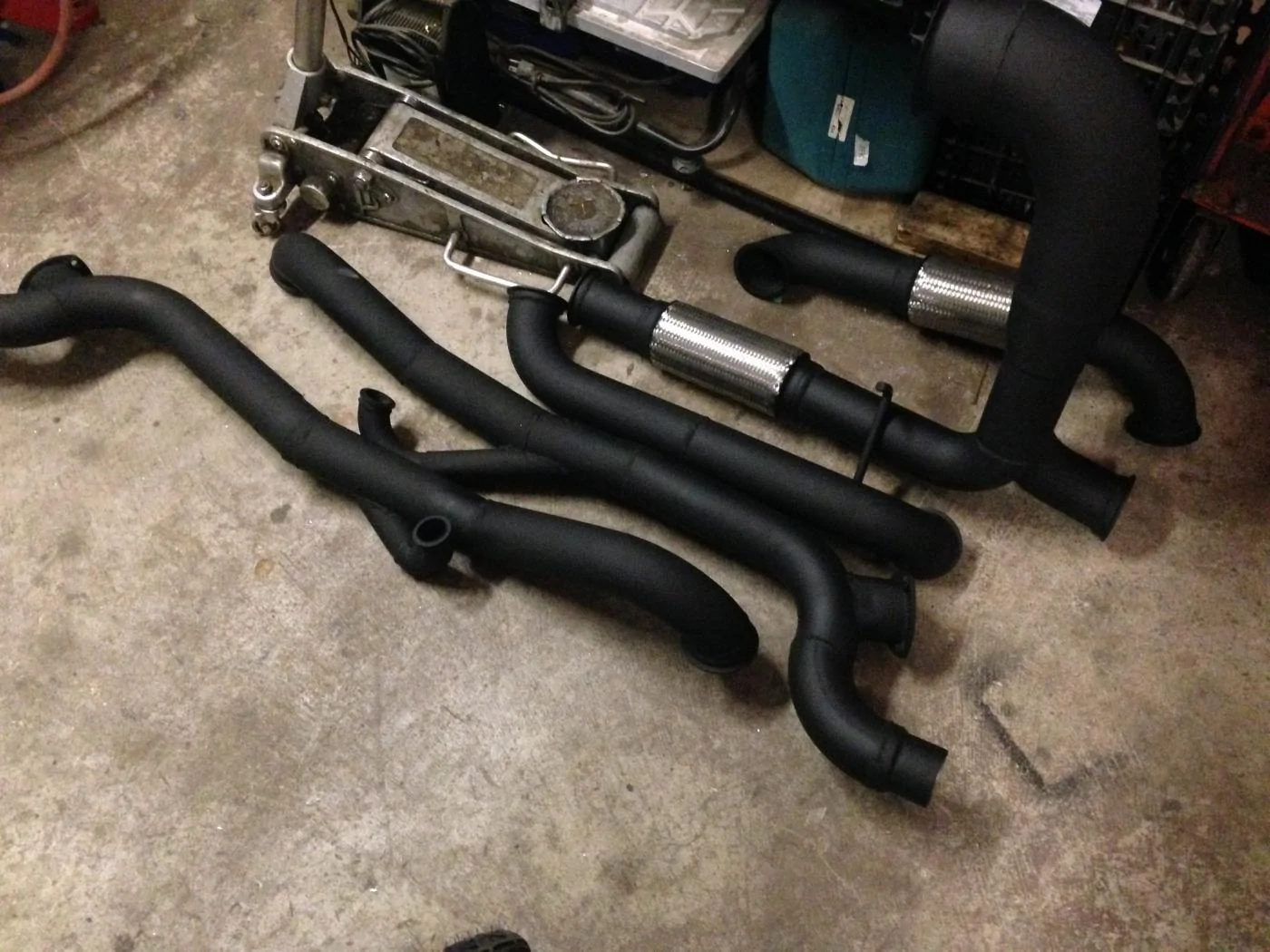

More progress
I got the n gauge and boost controller installed. All my exhaust was painted with vht header paint and will all be wrapped shortly. I received my base tune as well:hail: just need some time to finish it up !!!! Hopefully a video will be next :thumbsup::thumbsup:

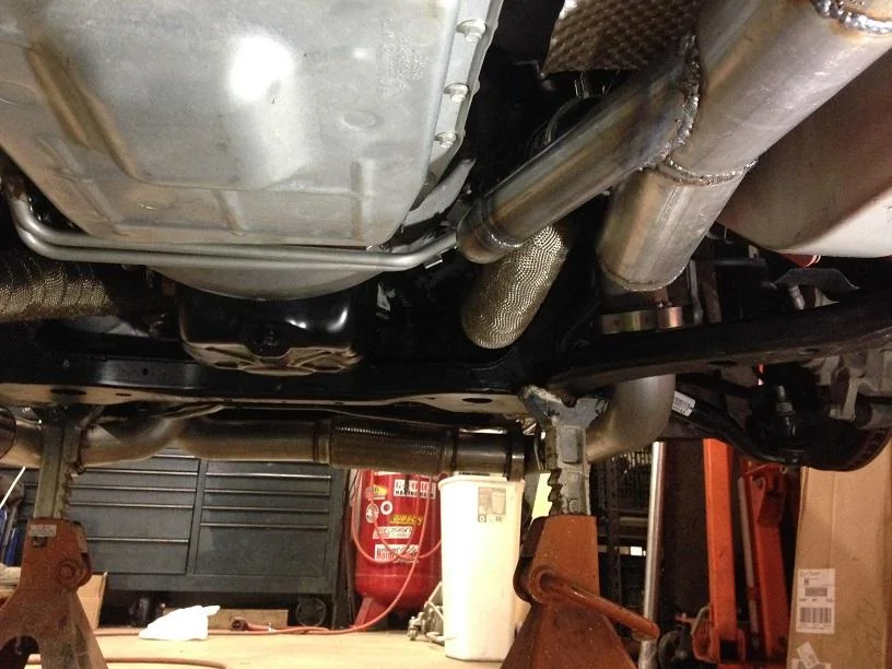

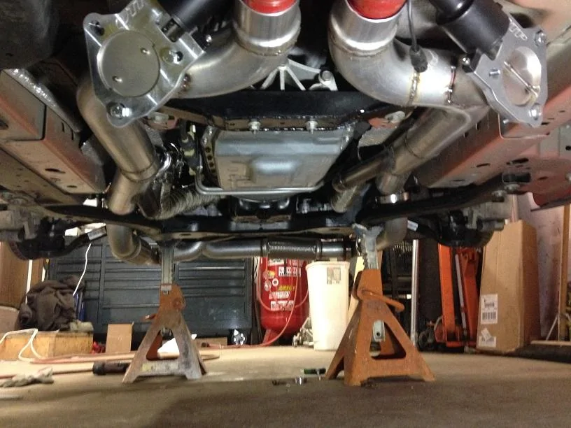

Exhaust

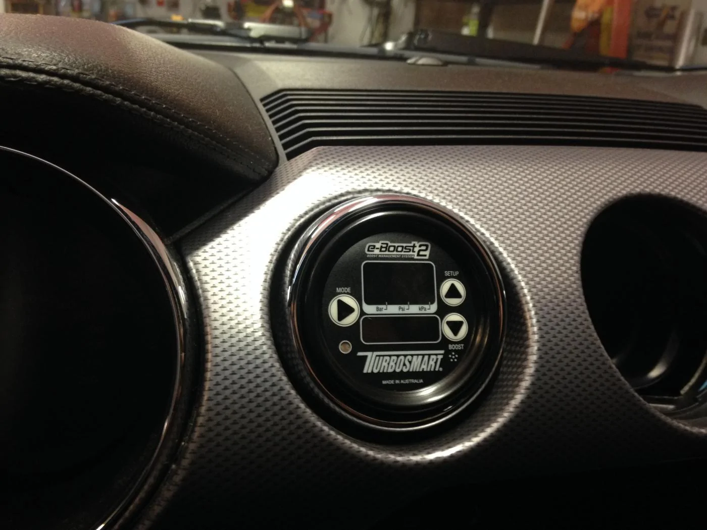

What did you do for a boost controller and where'd you mount it?
Eco85
Eco85
Mad Scientist
Oct 6, 2015
90
742
216
Northwest IN
Justin
2015 mustang
Eboost2 turbosmart vent mounted post pics of that later
Eco85
Eco85
Mad Scientist
Oct 6, 2015
90
742
216
Northwest IN
Justin
2015 mustang
Here is the boost gauge , its the 66mm one. All i did was take the vent out and remove the shutters. Then i cut a slit right down the black housing so it could open up enough to accept the gauge , then snap the chrome ring back on and wire it up. The ngauge was easy , i just removed the vent next to the boost controller and applied some velcro around the outside and it fits snug :cheers:

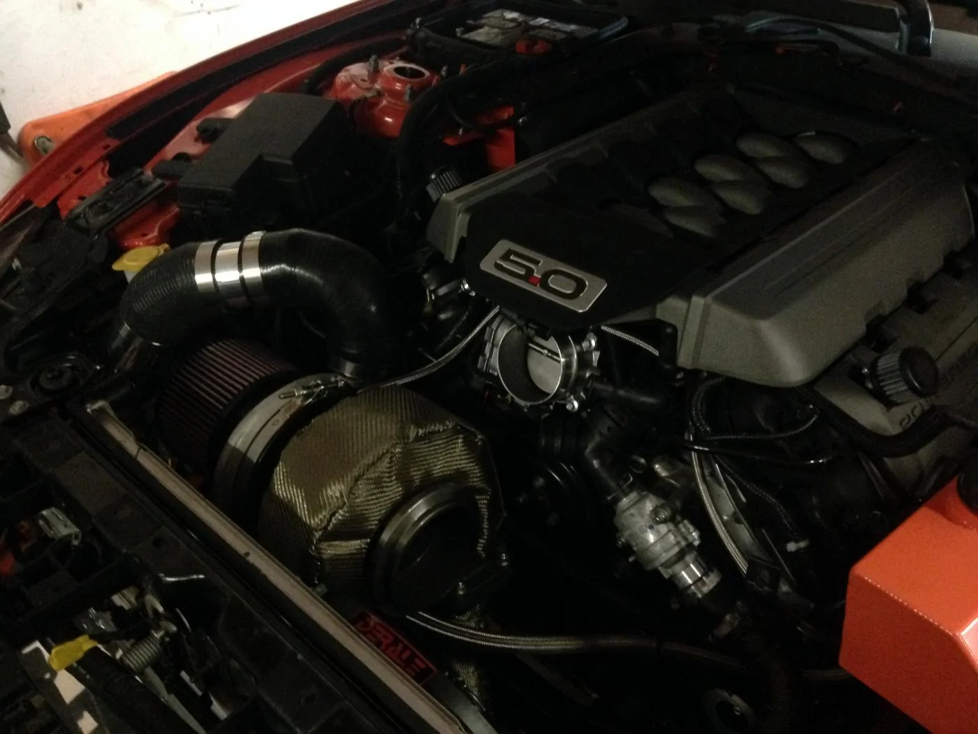

First start up
First start up , runs good so far ! Two things i dont like that I might redo is the hot charge pipe and cooling fans.
