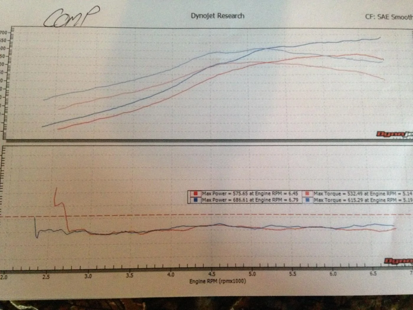

Finally got the car on the dyno !!
Just got the dyno done !
93 pump gas
575hp on 6.8 lbs
686ho on 10.6lbs

Graph
