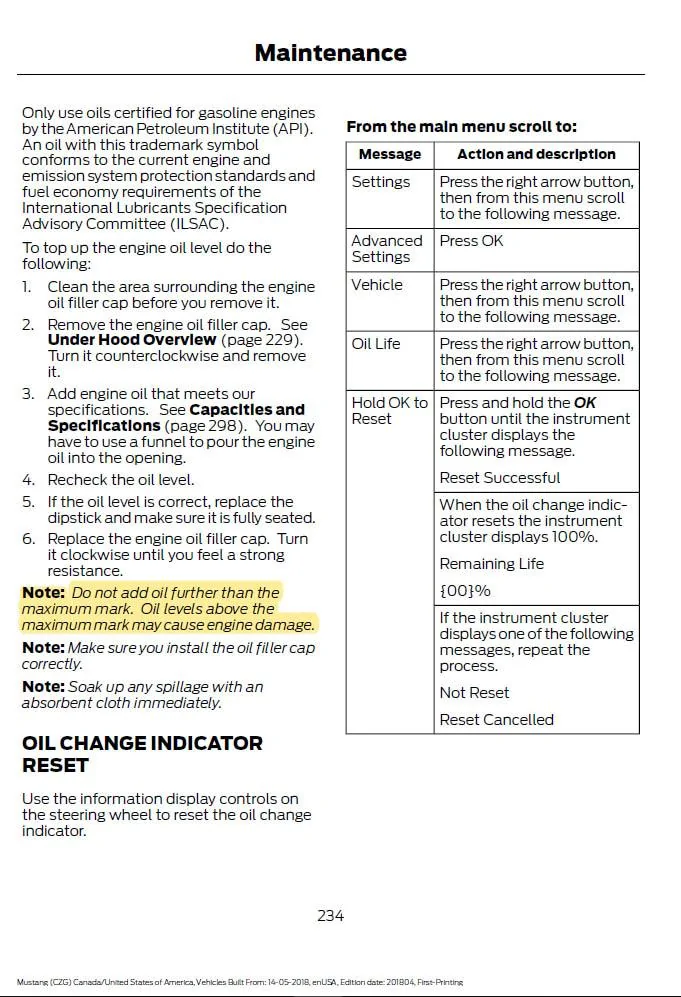

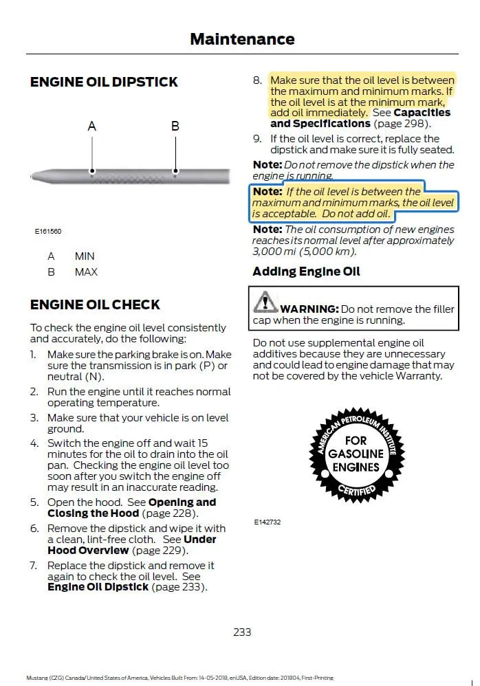

Not trying to beat a dead horse with this, but screenshots from the manual:
"Make sure that the oil level is between
the maximum and minimum marks. If
the oil level is at the minimum mark,
add oil immediately."
"If the oil level is between the
maximum and minimum marks, the oil level
is acceptable. Do not add oil."
"Do not add oil further than the
maximum mark. Oil levels above the
maximum mark may cause engine damage
I know this seems exceptionally trivial, basic, etc. Since it became a concern for me personally in context of circumstances and this thread was already started maybe it deserves discussion. To me the manual suggests that the biggest concern is to not overfill the engine with oil which was one of my concerns. I'm not reading this to indicate that the upper mark is 'full', but rather 'maximum' and the lower mark is 'minimum' - which implies a range of 'safe' fluid level in between and the manual very specifically states not to top off the oil level if it is between those indicators. Maybe that is specified just so dumbasses won't try to put an entire quart of oil in their engine if it is lower than 'maximum.'
I have a concern that following the instruction of what is the 'safe' level for normal driving possibly left my engine slightly enough starved of oil that it was the source of the odd rattle like sound that I was hearing, but I don't know that. It might be something for others to be wary of in context of the current question of what is causing engine problems.

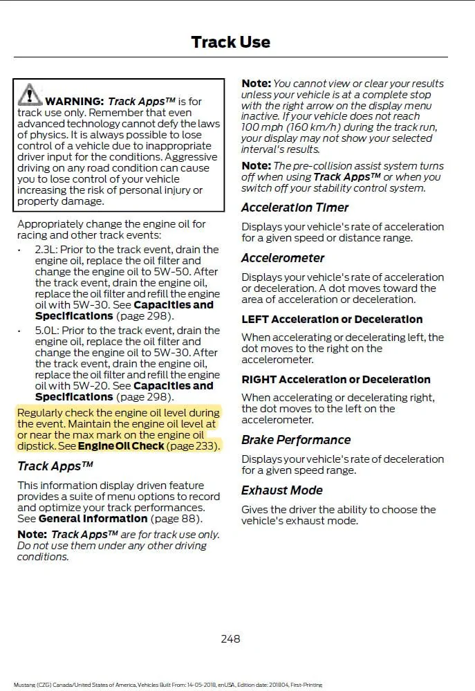

The manual does have specific instructions for 'Track Use' advising to maintain the level at or near the maximum mark.
"Regularly check the engine oil level during
the event. Maintain the engine oil level at
or near the max mark on the engine oil
dipstick. See
(page 233).
Engine Oil Check"
I haven't taken my car to the 'track', but you might presume these instructions are the best advice for any hard driving or if you tend to drive hard even on occasion. I would personally feel better about it if I had taken the greater care to keep the level at the 'maximum' regardless of intended use. Daily driving or otherwise. I will from now on.
dipstick. See
(page 233).
Engine Oil Check"
JASON,
you do have a point. In short, that is what pushed me to start this thread.
As I mentioned before, - "After decades or car ownership, I have always done like this: Pour in the recommended volume of oil and the dispstick
HAS ALWAYS SHOWED FULL MARK (upper mark).
This 2018 Mustang GT is the first car I have that reads "right in the middle" of dipstick.
THAT IS THE PURPOSE OF THIS THREAD."
You see, the book says that when the dipstick shows level between the lower and upper marks, is is ACCEPTABLE,
it does not say IDEAL.
Then it comments on tracking the car...
Once I asked Scotty Kilmer the same question concerning any car and he sad to keep it at the full mark, maximum volume, not exceeding the upper mark, of course.
I see you have been thinking just like me: To be safe, fill it to the upper mark.
Because when using the car in a track THEY do recommend that, for safety reasons, so why not to do so in every ocasion?
I am keeping mine right in the middle, for I fear the risk of too much oil.
But inside of me I do feel like pouring in oil up to the full mark.

JASON,
They recommend the higher oil level for “track use” because when a vehicle is being driven on a track, *specifically for Road Racing or Auto-X*, not only is the vehicle being hammered on at higher RPM’s for sustained speeds and lengths of time, but when the vehicle is hitting the curves at such speeds, the oil is being sloshed around in the pan and cativation can occur rather quickly. Having an “acceptable” oil level for daily use (ie: between the hash lines) would not be acceptable or safe while driving the car during such a track event.
While keeping a higher oil level would also apply if using the car for drag racing, it’s really not as detrimental if the owner had an “acceptable” oil level because although hitting high RPMs, it’s for a shorter amount of time/length and the car is staying in a straight line as opposed to extreme side to side ‘lean to’ when whipping it around during a Road Racing or Auto-Xing event.
If the car is used daily for normal driving, the oil level at the “acceptable” level is more than safe - otherwise Ford’s Legal Team would not have allowed the print or example to exist in the Owner’s Manual. Any docs put into publication by Ford (or insert any Large Corp here) always goes under legal review before its released to the public or media.
I don’t feel there’s any concern for any daily driven S550 to have an oil level that is between the hash lines.
