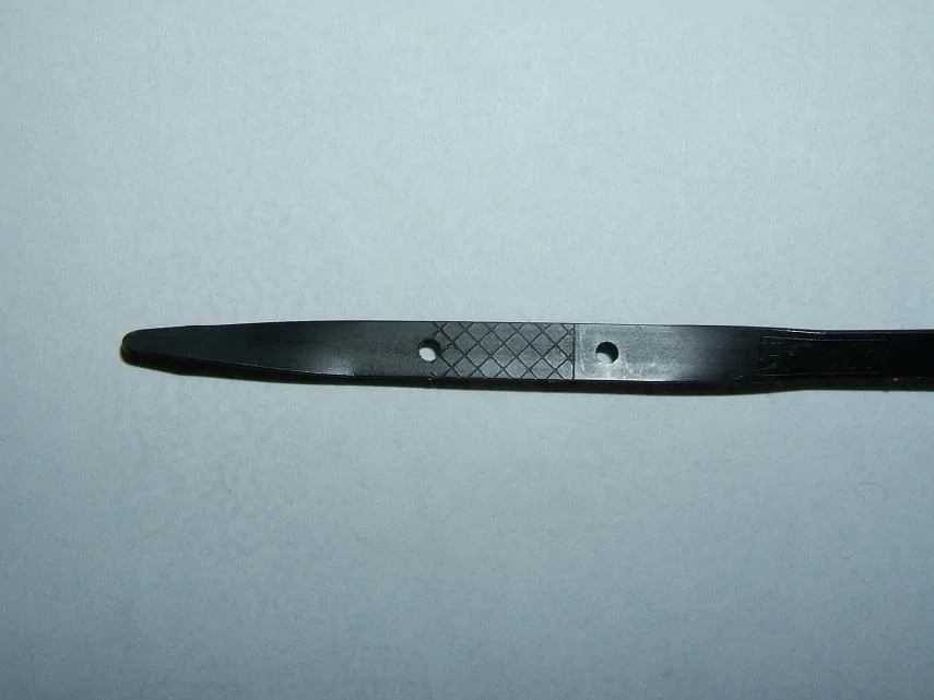

That's why I always check my oil level when the engine is cold and the car is always in the same parking spot in the garage. It makes for very consistent oil level checks.
This is a photo of the dipstick on my 2015 GT, but I'm betting the Gen3 Coyote works the same. The top line on the hashed area is "Full" with cold oil, and the top hole is "Full" with oil at operating temperature (~200F). I've verified it many times on my GT. It's also 1 qt between the bottom of hashed area to the top of the hashed area ... also verified many times on my GT.

But the manual says that that top of the hash is the maximum when engine is hot after 15 min cooldown, not when the engine is cold. Why do you say otherwise?
My OM doesn't say that. Check your OM again and please post a screen shot of that page so we can see what exactly it says. I'm betting your dipstick has a hole located above the top of the hashed area just like the photo I posted.
My manual says exactly what post number 20 says in this thread. Now that I look at it more closely, it shows that the maximum while warm is the hole, not the top of the hashed area - my bad. Strange - why even have a hashed area if your not going to mention what it’s for in the manual? I mean, it says the minimum is the bottom of the hashed area, and the max is the hole? Then what is the top of the hashed area for? If you’re right about it being the max while cold, why not mention that in the manual?
Good question, but IMO either that info didn't get passed on to the OM writers, or Ford didn't want to confuse people on oil level checking. Do a few hot vs cold oil level checks in the same flat parking spot and verify youself.

so i believe-
the manually mentions only checking the level while hot- meaning 15 minutes after engine turned off once it hits running temp- ~200F.
with that said, the holes/dots represent the min and max marks. The hash is not mentioned.
if i were to guess, i would guess like others here, when checking cold, your level would be lower and in the hash zone. So the upper hash mark means full COLD. The lower hash mark means add more when COLD.
I check mine when cold. it's easier and more convenient.
on my 2019 gt on the 1st oil fill- it consistently read in the middle of the hash zones, hot or cold. one was lower than the other- prolly hot was lower in the hash but it's been always in the hash zone which is safe.
i will check it again after the last change and compare cold to hot and report back. I did this once already but i forgot what i found. LOL. I do remember cold VS hot was so close, and in the hash lines, that it seemed to not matter when you check it as long as if you check hot, you wait that 15 minutes to let it settled down!

so i believe-
That is correct. On my 2015 I've verified this about 5 times and in every case it was repeatable.
Full cold is the top of the hashed area, and full hot is the top hole. I'm sure it's the same way on the 2018+ Coyote too.
I also check the oil level cold ... it's much easier to see the oil level on the dip stick.

Yes, with 10 qts you will show the oil level right in the middle of the holes on the dipstick when COLD. Once you have brought the engine and oil to operating temp, shut off your car and wait 15 mins, your oil level should be at the top hole on the dipstick.
So I checked the oil this morning after it sat overnight - middle of the hash mark. I just checked it again after driving home 30 min and waiting 15 min - BOTTOM of the hash mark. That seems opposite of what everyone is saying. I'm gonna check it again in a couple hours.

I'm assuming you checked the oil both cold and hot with the car in the same exact parking spot. I always go by the level on the side of the dipstick with the deep hash marks in it. Got to use the same side every time to get consistent levels.
Yes same parking spot in the garage.
So does the dipstick self-orient when inserted or is it possible to have it flipped 180 degrees? Are you saying the hash mark always ends up in the same position regardless of how the dipstick is rotated when inserted?
I put the dipstick back in the same way each time. I use the position of the handle and the side with the hash marks to ensure it's going into the tube the same way each time, then always use the hash marked side to check the level.
