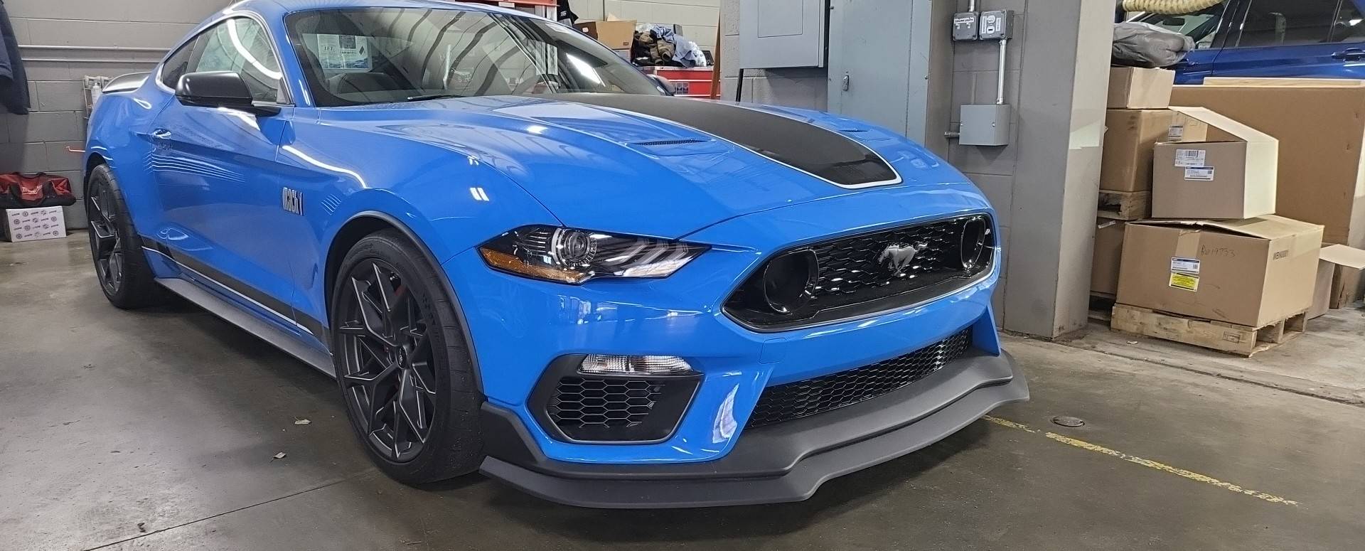

When I picked my car up in Detroit I specifically instructed the dealer to stash the car in the service bay, so no others test drove it. They sent me a picture of the car stashed with an odometer showing 6 miles. I joked with the sales manager that if it was moved before I got there the deal was off and I'd turn my Benz around a head back to BAMA with all that cash in my pocket! LOL
Anyways when I got there the car was stashed as pictured. I inspected the car to include pulling the dipstick to check oil level. It was dead center on the top hole on the dipstick. That was the factory fill.
