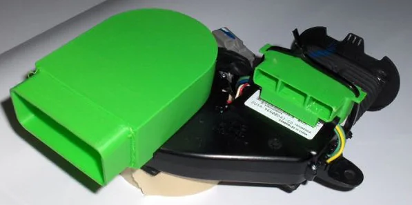

Since everyone's talking about it, I figured I'd share. I've been contemplating how best to do this and working on the 3D models for awhile now and decided it would be a fun adventure to get a 3D printer. A bad stepper motor derailed me for a bit, but I got it up and running yesterday and was able to do some prototyping.
My goal was to create something simple for the intake and the waste exhaust that could be installed without removing the blower unit from the seat and could also be easily removed should an official fix come along. It would still require a little blind, one-handed work to put them on, but would hopefully still be easier than taking the blower out. The one downside is that the current deflector on the intake side has to stay attached. It seems like it's somewhat obstructing of the airflow, but hopefully not too much. It does give something for the attachment to hook onto though.
See photos attached for where I'm at with them. Excuse the green – I'm doing the rough stuff with it before switching to black. It is better for the pictures though. I haven't bothered to clean up the stringy pieces of plastic, so please excuse those as well.
They still need some refining to get the best fit, but are pretty close. I've only done the pieces that attach to the unit itself and haven't figured out what I want to do about the tubing out of them. The guy over at the F150 site finally shared an image of what he's done and he used flexible hoses (I think it's around page 166-167 – looks like pool vacuum hose). That idea is kind of appealing since the space in the back of the seats is an odd shape and I don't think we can have a tube that just drops straight down. I'm going to try and do it with the hard plastic though.
The intake attachment is pretty much what Droid Junky has done for his. It won't be as airtight, but I'm thinking that neither the intake or exhaust needs to be. Maybe some rubber/silicone edge trim would help, but they aren't really sucking or blowing that hard that it will make that much of a difference. The exhaust attachment will definitely need to be zip tied on. I'm hoping the intake won't need to be.
I haven't actually tried attaching either to the blower inside the seat, so might need to adjust once I see how that goes. The intake might not need to be as deep as it is. The exhaust just needs a support added to keep it from tipping back and some minor sizing tweaks. I'm going to drive home tonight with the passenger one outside of the seat with these attachment to see how it goes.

Great work Darko, very impressive!
Do you plan tubing only the intake, and let the hot air inside the seatback - even if probably getting the air from outside the seat will higly reduce the amount of exhaust hot air ..
....Snip..
Why isn't this man on Fords payroll?

I wonder if Darko could get with the F150 guy who is making his own fix and they can collaborate, fine tune and make a better product. Possible save cost by sharing resources and being able to market to both crowds. (that is if the seat layout is the same)
