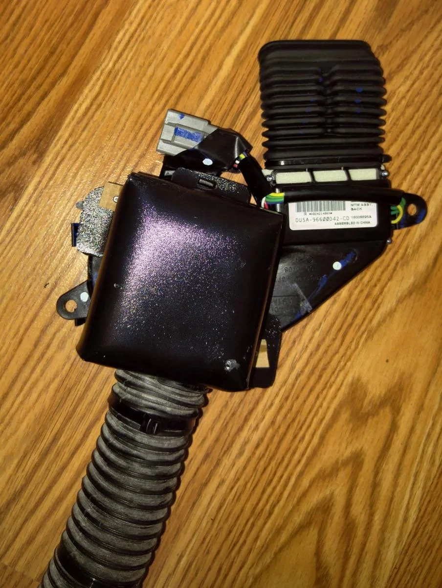

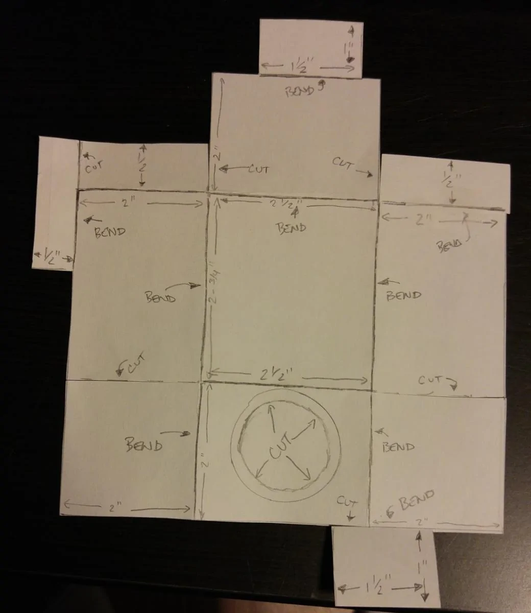

So here is my upgraded mod made out of plastic!
I purchased the sheets from amazon for $10.00. I only built the driver's side but it would take both sheets to build two. http://www.amazon.com/gp/product/B00CBWNUR0?psc=1&redirect=true&ref_=oh_aui_detailpage_o04_s00
I removed the unit from the seat. In case someone asks the question this post explains how to remove it: http://www.mustang6g.com/forums/showpost.php?p=654492&postcount=299
I actually used the cardboard from the amazon box and built another template. Then I copied all of the bends and measurements over to a sheet of paper. The only piece not shown on the template is a strip of plastic that I left at the bottom to the left of the 1.5" x 1" square. That strip is behind the duct of the second pic. I wrapped two tie wraps around it to secure the duct to the box.
The depth of the box doesn't have to be the same as my measurements if not using a shop vac hose for the duct.
I used a Dremel for all of the cuts and a heat gun for the bends. I probably could have made the bends more precise if I had taken the time to build a jig but it turned out good enough.
I didn't take pictures of each bend. I basically just picked a spot and started shaping the plastic. Heat up one bend at a time if using a heat gun, shape it, hold it for a few seconds and it won't bend back. Repeat until all of the bends are complete. Warming the plastic in the oven would take some more planning ahead of time because the plastic cools quick.
The hole for the duct obviously has to be cut to fit the tube size. I cut it a little small and the shape of the shop vac hose allowed it to stay in place.
Once the box was shaped I sealed the bends with silicone to prevent air from leaking in the cracks on the sides. The entire bottom of the box is open to the fan.
The last step was to drill the two holes for the screws and the slot at the top for the hook. I screwed up and used the Dremel tool for the holes. The screws are extremely tiny so I had to make some washers to hold it in place. It does not move around at all.
It definitely improves the seat. I don't feel the seat warming anymore. I can actually feel cool air but it still isn't equal to the bottom. It's still better than what we were given!
