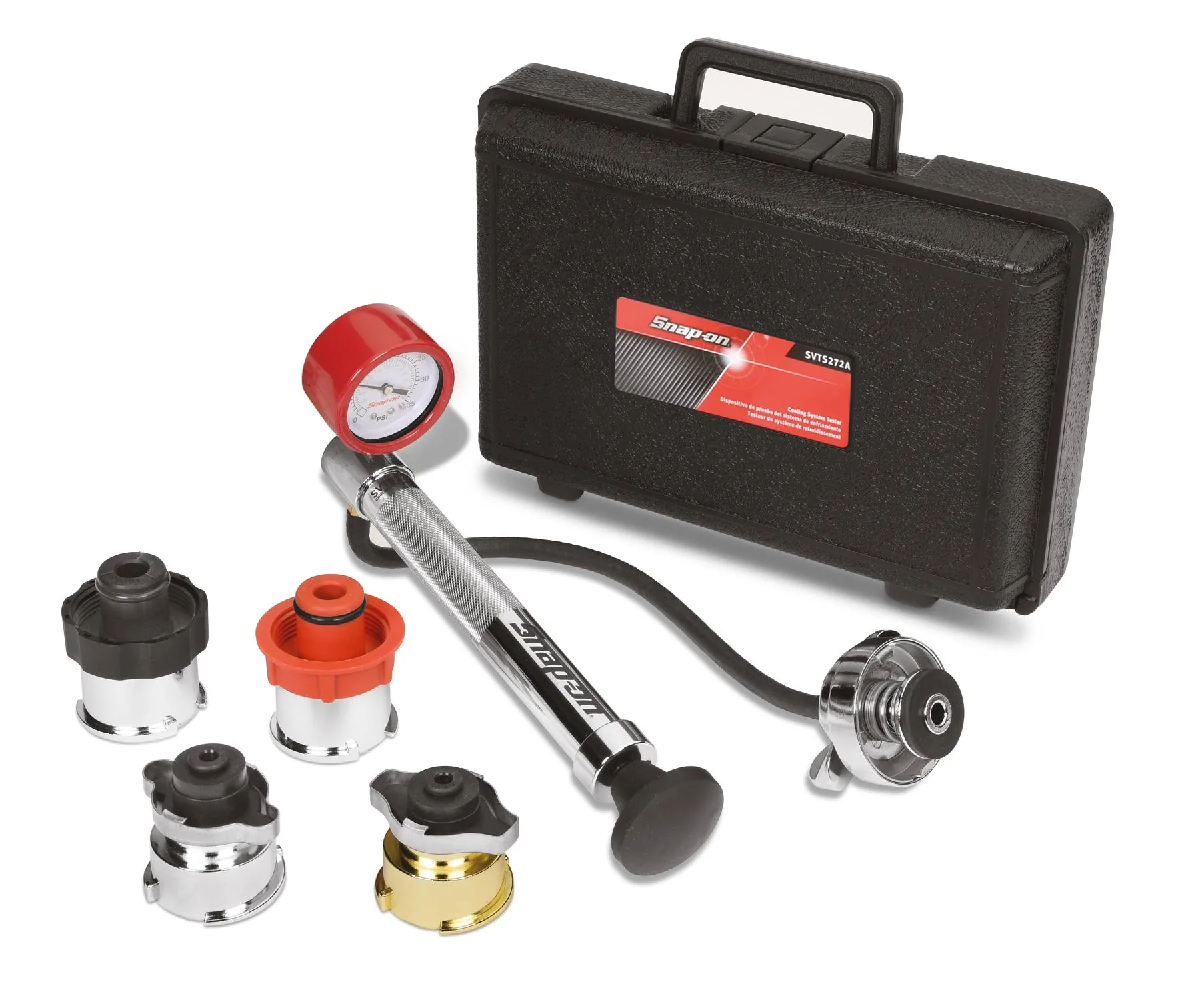

Well i can confirm that M52x2.5 (black) adapter does not stay on and the correct adapter is M50x2.5 (red) which both came in the SnapOn test kit that i bought. The stance adapter could be the M50x2.5 size im not sure as there are none available that i could find.
SVTS272A – COOLING SYSTEM TESTER
