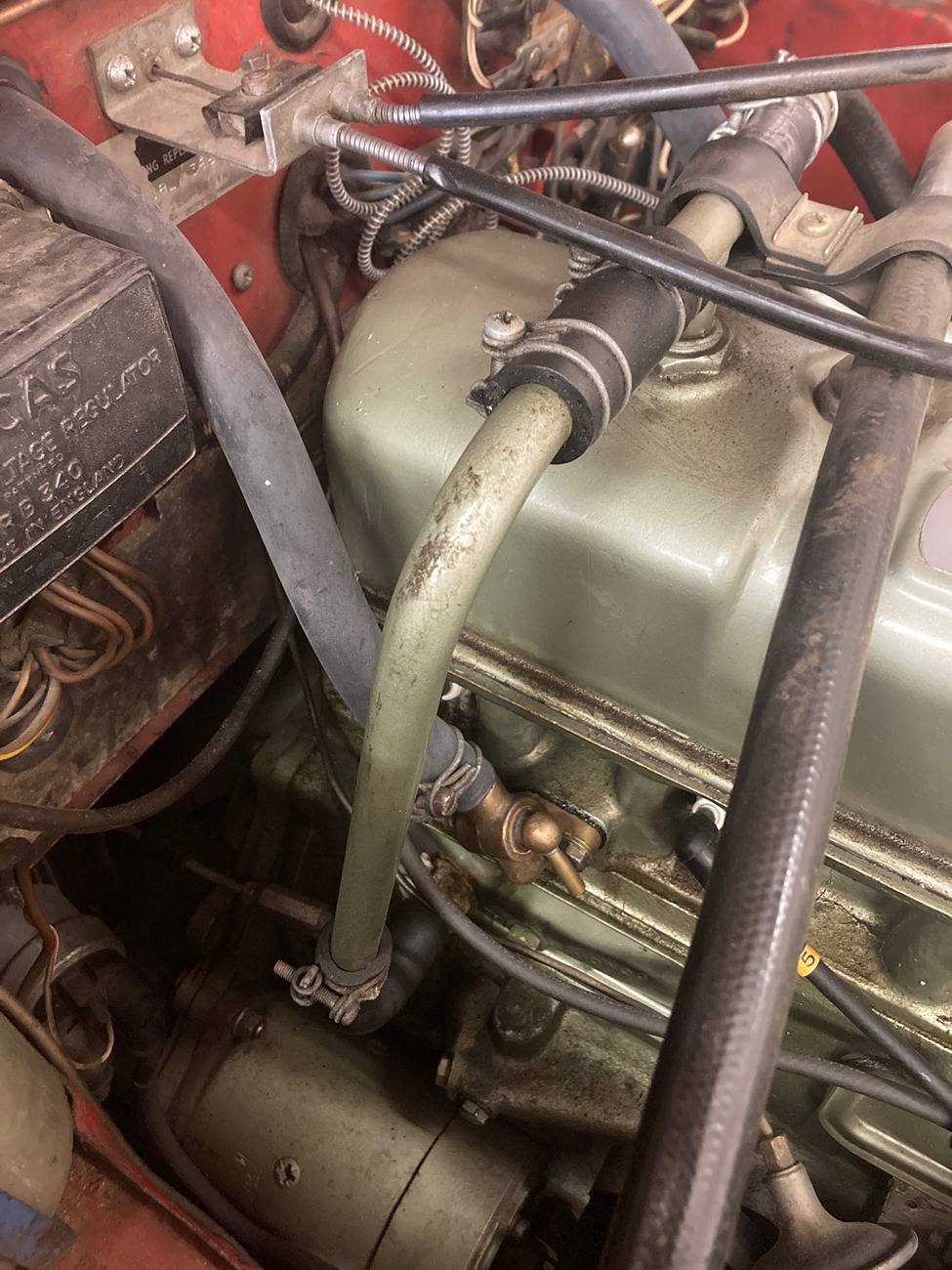

Coolant to heater core valve on my '67 Austin-Healey 3000. Note it's on the outlet side, the valve on my '56 Healey is mounted on the return side of the water pump; not as useful when your heater core or valve--I've had to replace it twice--starts to leak.

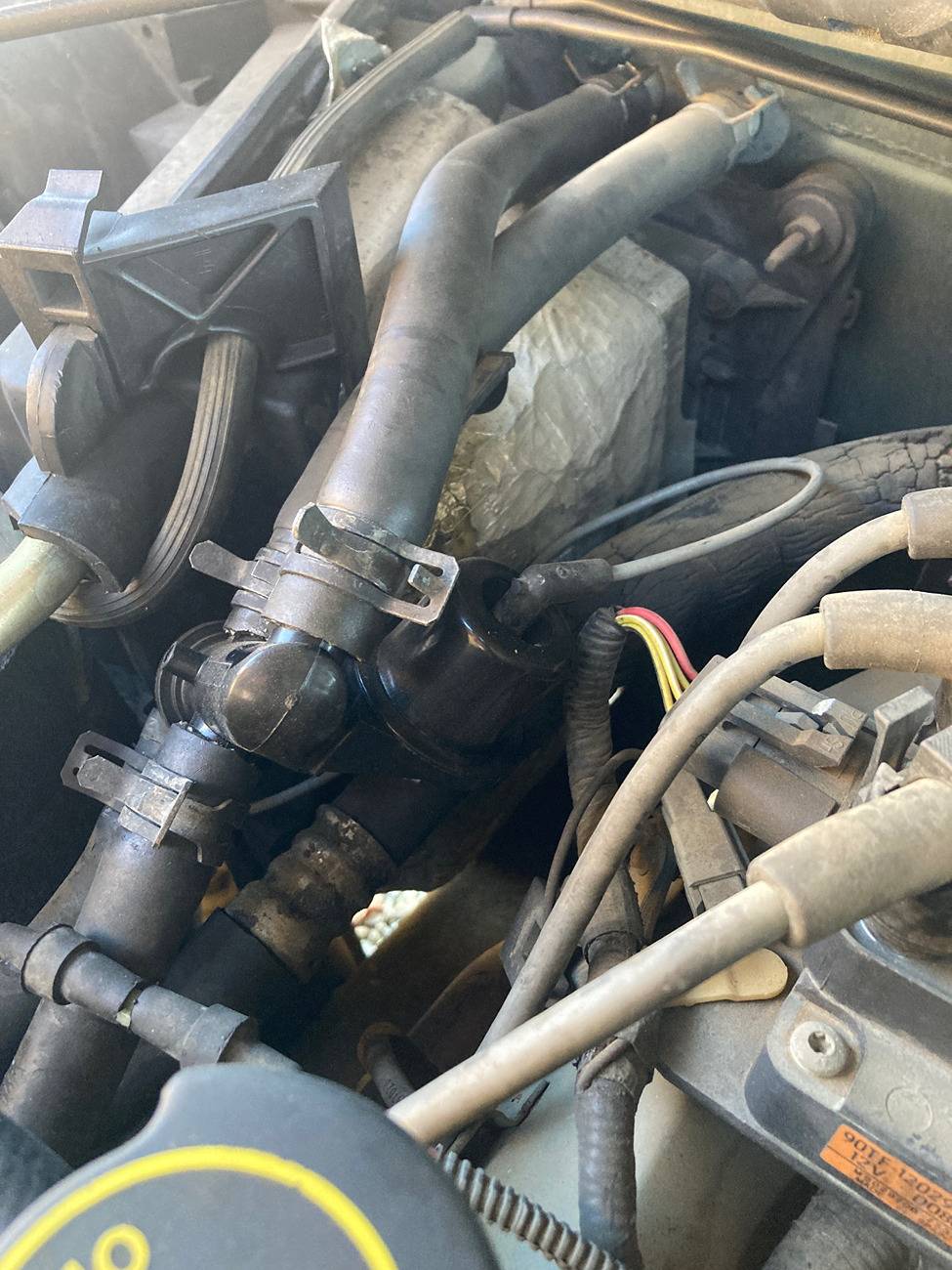

Heater control valve on my '96 Ranger; this one is vacuum operated (and fails regularly; next time I'll spring for OEM-$$$):

Replacement voltage regulator with original cover. Actually, the Lucas electricals aren't bad, it's the wiring; the Healeys have the same bullet-type connectors my dad's Model As have. They corrode and get intermittent.
