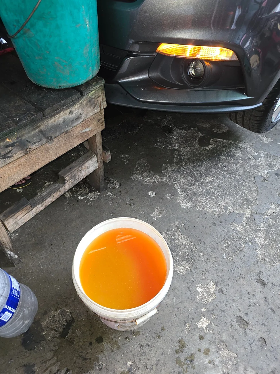

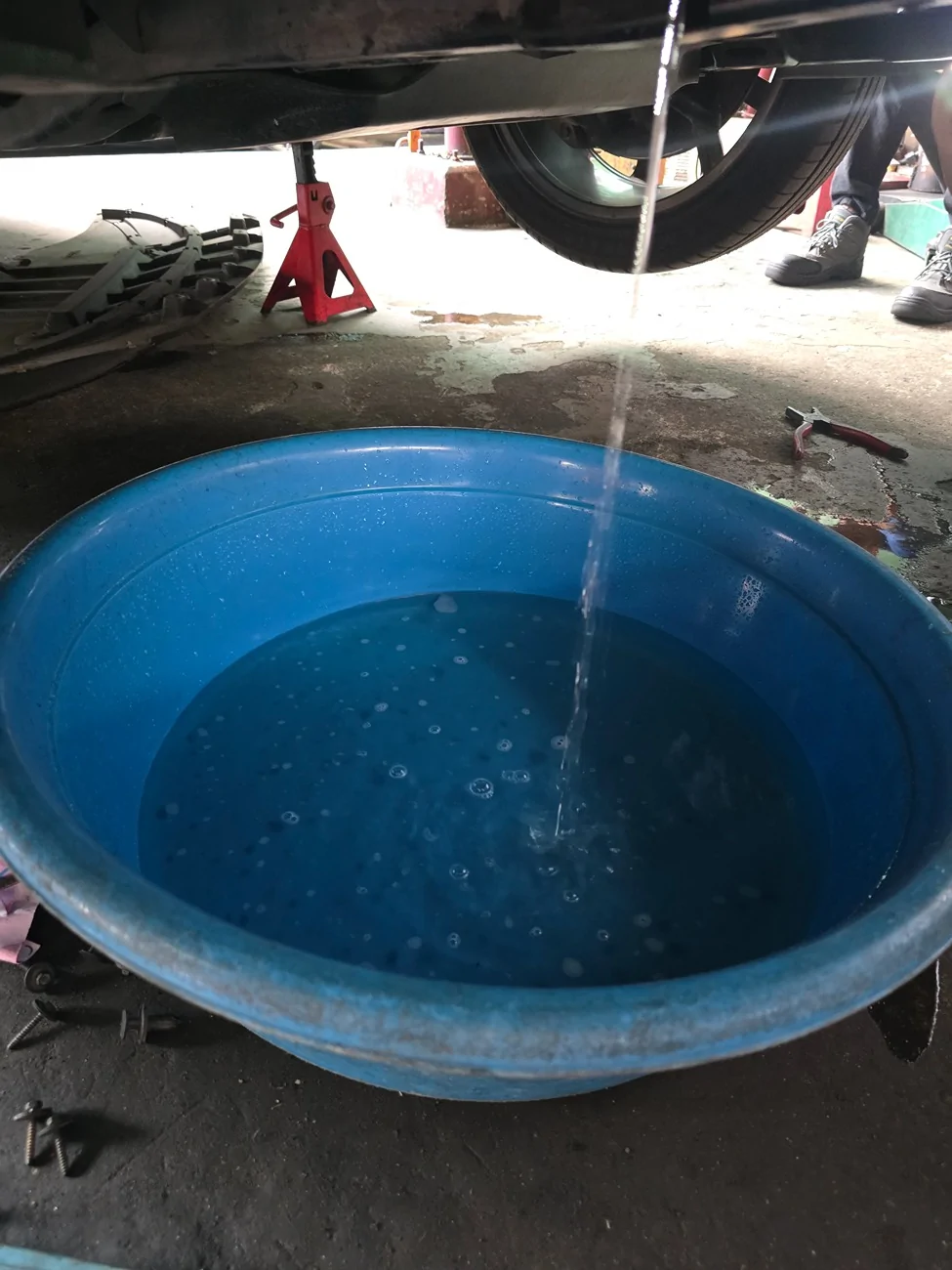

Previously I'd already done a drain fill with distilled water, then drained again and put in a gallon and a half of yellow premix 3000km/2 years ago.
Reservoir turned pink after a while as the old coolant mixed with the yellow.
I wanted to get all of that orange out after seeing pics of additive fallout sludge from that orange dexclone stuff.
So following bankyf's procedure we ended up running 14 gallons of distilled water through it before I was satisfied it was clear.
Then we drained the rad and put in straight yellow coolant concentrate. I dont have a refractometer so going by listed system capacity of 3.6 gallons, putting in the 1.5 gallons of concentrate I had on-hand puts me at about 41%. Very hot and no winter season here so will try this ratio for a while.
First bucket:
Final rad drain before adding concentrate:

Thanks again @bankyf for posting this, I finally got around to doing this the other day.
First bucket:
