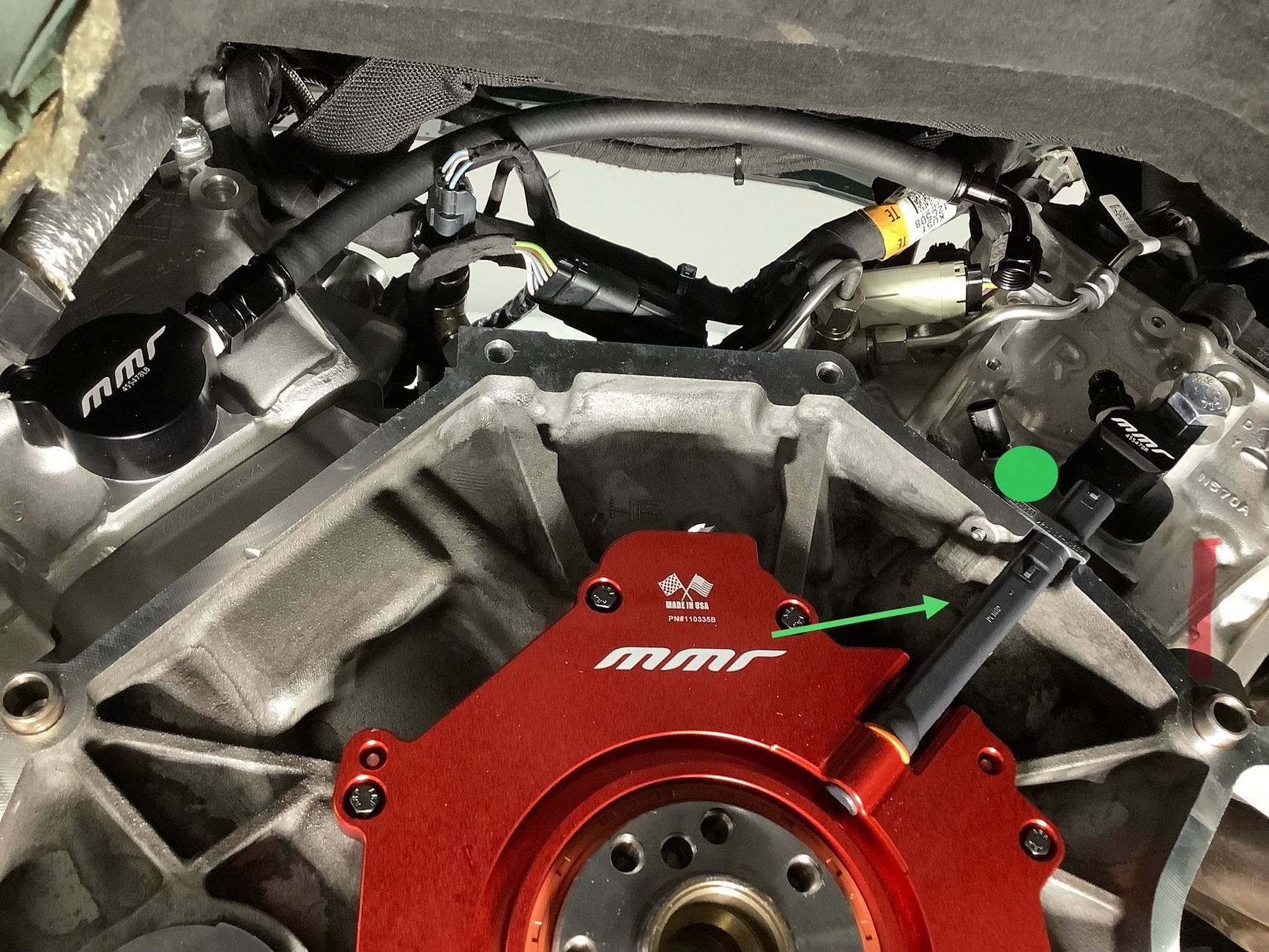

I should note that I also removed my freeze plugs and got all of the fluid out of my heads that way before installing the MMR Head Cooling Mod. I never thought to remove the thermostat as you mentioned. It’s actually a good idea.
Is that the crossover hose at the back of the engine?

Don't you have to pull the engine to do that?
What method did you use to pull the plugs?
The engine doesn’t need to be pulled for this mod.
I did mine when the tranny was out for a clutch upgrade and tranny build. I used a hammer and long flathead screwdriver to knock the freeze plugs loose, to where they were sitting at an angle and then pulled them out with a pair of pliers.
There are some people, who claim to have done the install with the tranny in place. However, I personally think it would be too tight with the tranny in and believe it’s best to do if/when the tranny gets removed.
Thanks..
Sounds terrifying.

I have a mod friendly dealer. He would probably approve this mod if I had to have the trans out for some reason.
They also make a cylinder head oil mod. I bought that one too, but didn’t install it, as it does require the engine to be out of the car (or the cylinder heads off) because there is no room to knock out the even smaller freeze plugs and press in the fittings.
