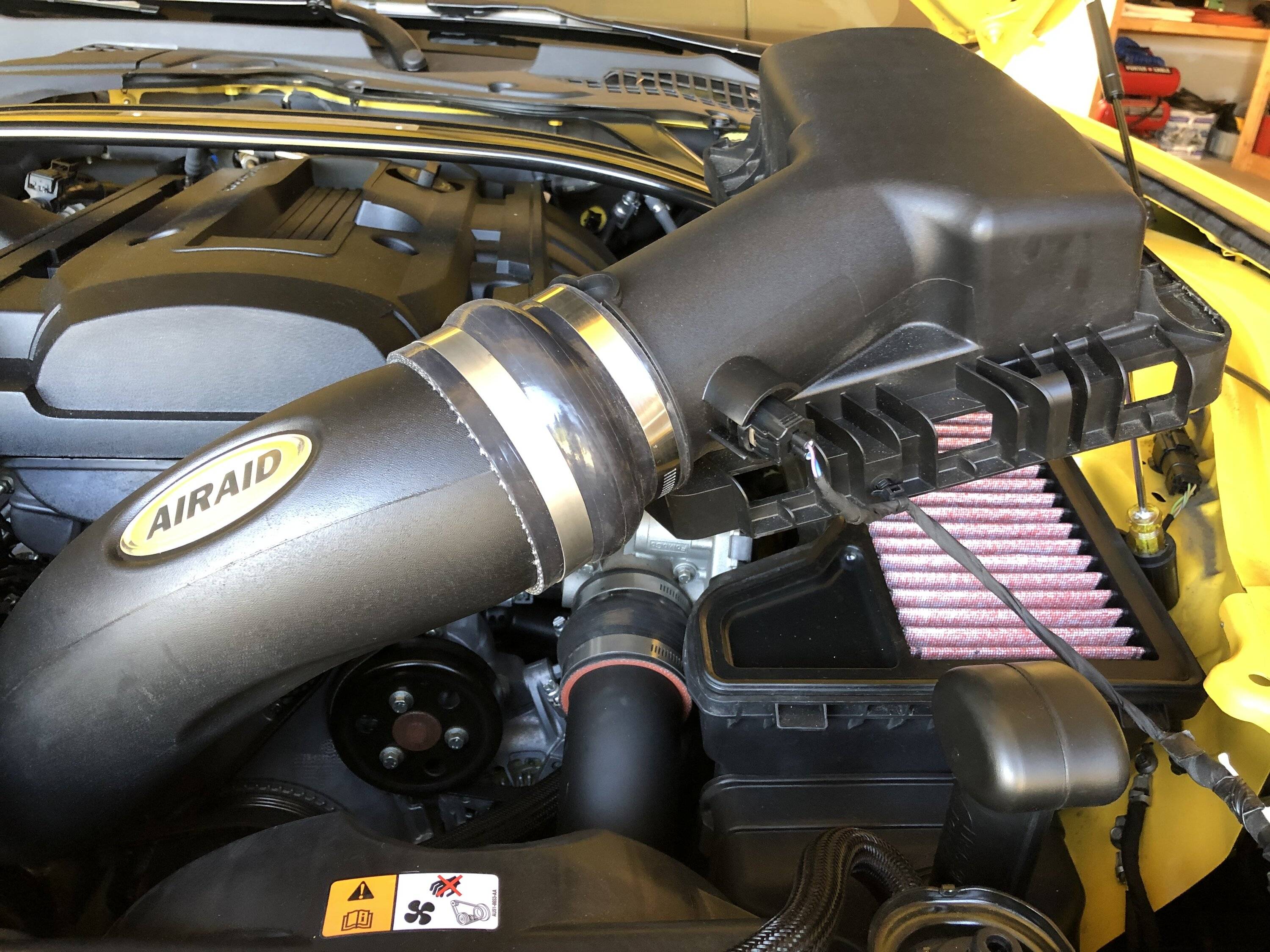

Stock box, AEM filter and Suess-a-phone.

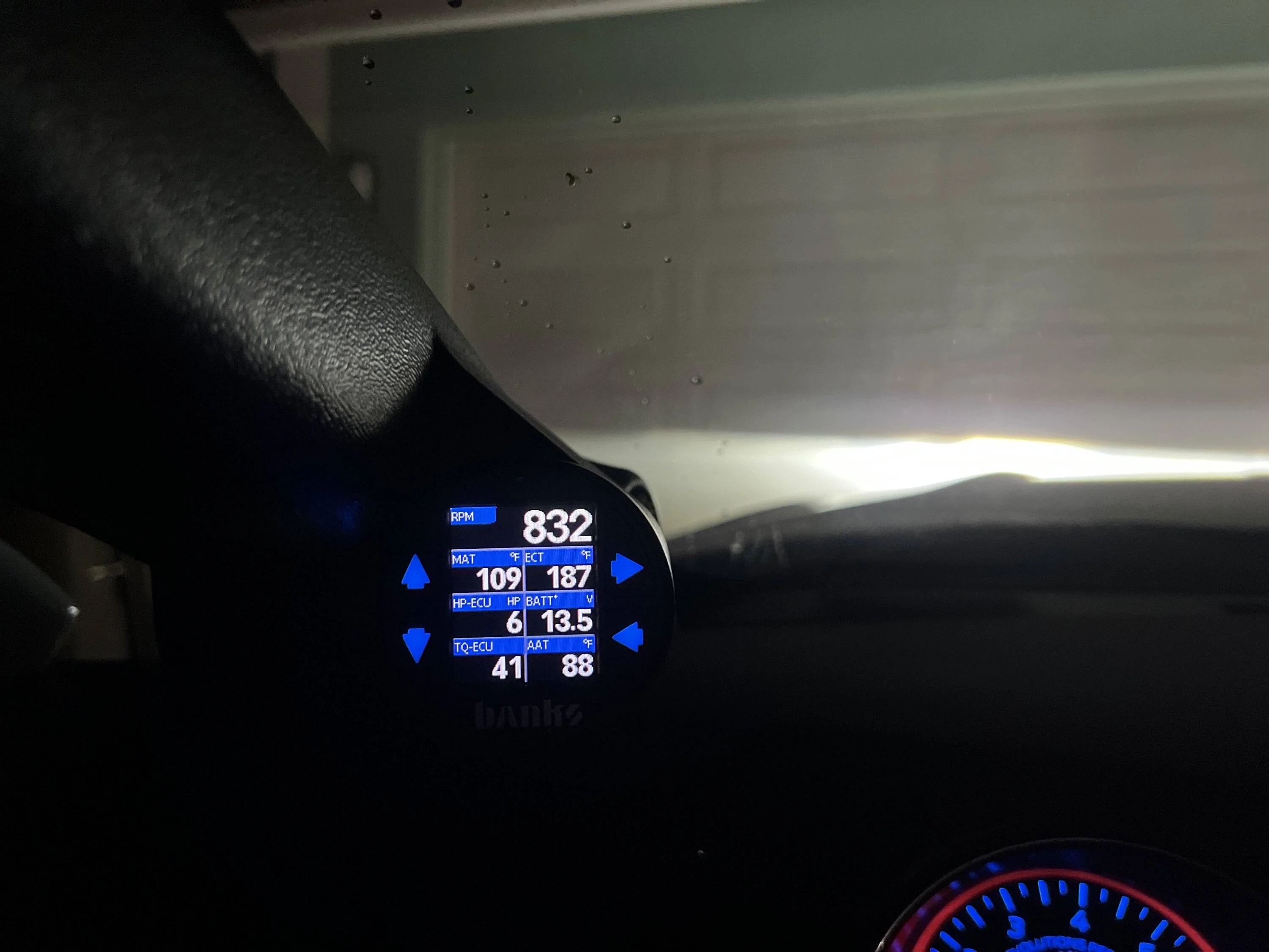

I have a Roush closed cold air intake on my 2021 2.3 High Performance Package and it does not make a lot of noise, the only time you hear it is on a cold start up for about the first minute then it quiets down. You don't hear a rush of air noise other wise. I also have a Turbosmart EM Kompact Dual Port blow off valve installed along with a CNC machined MAP intercooler. The engine also has a Cobb 2.3 HPP OTS tune in it. I also installed the Autometer single gauge A Pillar with a Banks Power iDash Super Gauge to monitor different items.
