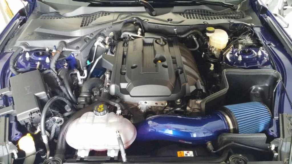

I have the K&N on my car and while the sound is absolutely awesome, the IATs are not. With the stock intake my IATs were usually 1-3 degrees from ambient, but with the K&N I have never been able to get the difference to be less than 15 degrees. It's even worse in stop and go traffic. I've seen my IATs rival coolant temps now.
I think I'll be trying something else soon.

So on my 20 mile drive home from work the coolest I saw it was 116f (on the freeway at 75mph). Ambient was 93-94f.
Once I got off the freeway onto the surface streets at 40mph it crept up to 135f. Ambient went down to 92f. By the time I was pulling into my garage it was at 151f.
The stock airbox assembly draws air from behind the grills, the K&N draws air from the engine bay (despite the half-assed attempt of a heat shield).
I think I will switch to a true cold air style intake and I will wrap the piping with heat wrap to help keep it cooler.

The airaid on my car keeps the temps right around ambient temp, and on cooler nights i have seen lower...

The MAP cai I have goes right in front of the drivers side wheel so it seems to avoid all the extra engine heat. :headbang: MAP!

Unless you drive in the city. 90 outside saw 145 temp.Freeway and cooler weather it stays around ambient though.:thumbsup:

Most gains are from the filter itself. As for the AIT>that's also depending on how the sensor is mounted.

As for the IAT's yes they will increase at slower speeds and sitting in traffic over the stock sealed box. However they will also cool faster once you are moving. With the stock box you are restricted to the single inlet for all of the air flow and a relatively small filter. Gains are gains, and well it looks a hell of a lot better too :thumbsup:

I bought my CAI mainly for the look of it and the sound. Stock the car is soo quiet I started to seriously think I had made a mistake in buying this car at all. After exhaust and CAI I felt much better. I've not noticed any increase in IAT's on my car.
As far as the look... I'm not a fan of having huge filters, boxes, and painted stuff under the hood but I just prefer the look of the CAI.
Stock
Vs an FFtec...
