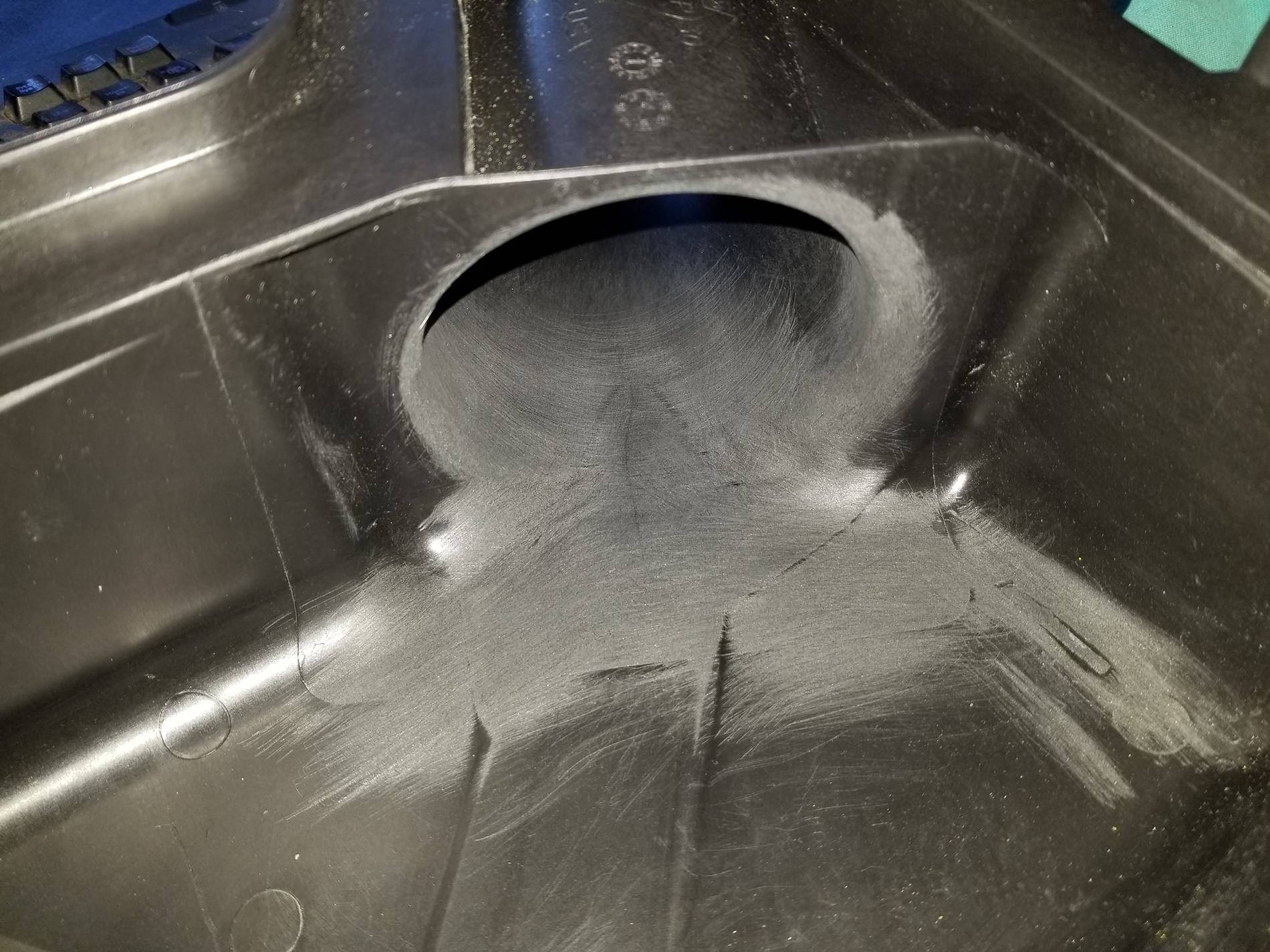

Well, the 2017 Mustang GT4 uses the stock airbox, and that engine makes more N/A horsepower then most of us can dream about. I did back 2 back runs at the track. JLT vs Stock (charcoal filter intact, stock air filter). Stock was quicker (same weather, same engine temps). I took the JLT off and gave it to a buddy of mine who had a hard-on for it. Now I'm running the stock airbox w/ K&N drop in filter, + charcoal filter removed. Now during the winter months, I'm doing some blending inside the stock air box lid. Opened the entrance to 4" to match the exit, and some blending. Little more to do yet. Cheers.
