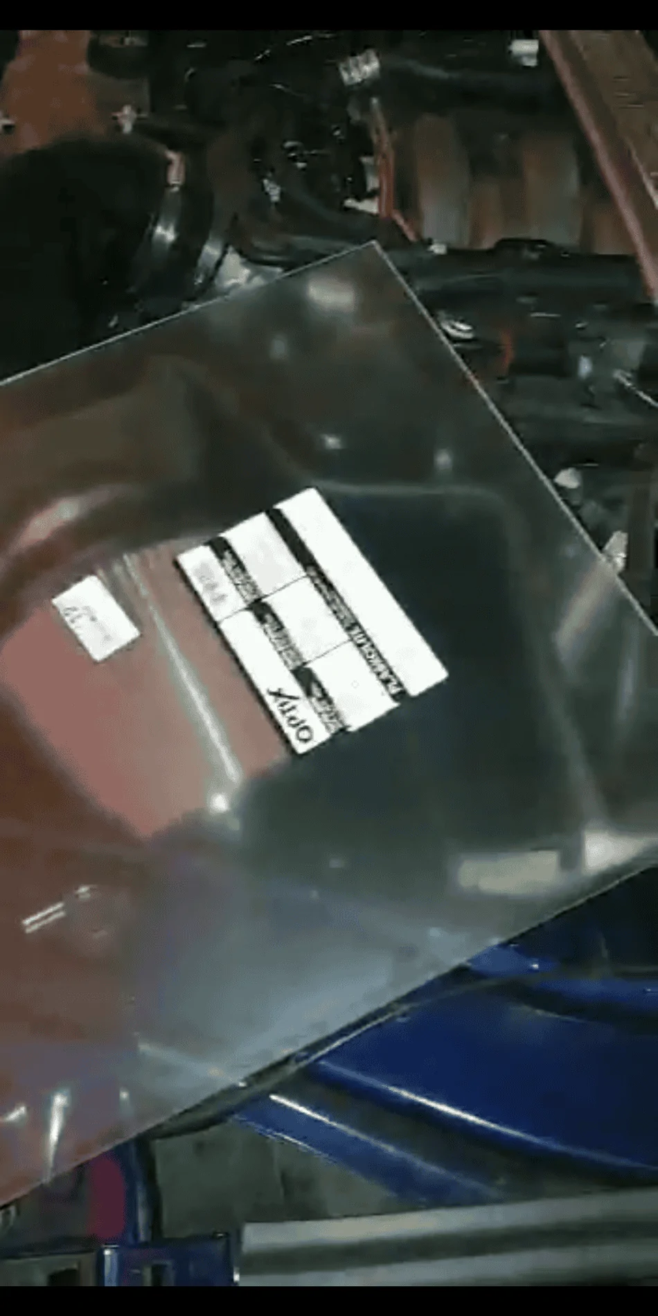

Starting a new project..
Plexiglass cover.
I have a couple of ideas but still a work in progress. Main issue is the topbox plastic is not leveled. So i need to fill gaps and find a way to close the plexiglass cause the plastic width is not much. Keep you posted..

Hi, I tried all that already. Another problem with the JLT is that it sits too close to the engine / exhaust / rad. Heat soak central. But like I said earlier, it'll probably work at the track, but the way I look at it. Ford GT4 Mustangs use the stock airbox. good enough for me ;)
For the plexiglass the easiest way would be to bake it in an over, then while wearing think gloves, after it softens up take it a mold it around the airbox. Old school, but works very well. Then you'd have to attach it somehow.

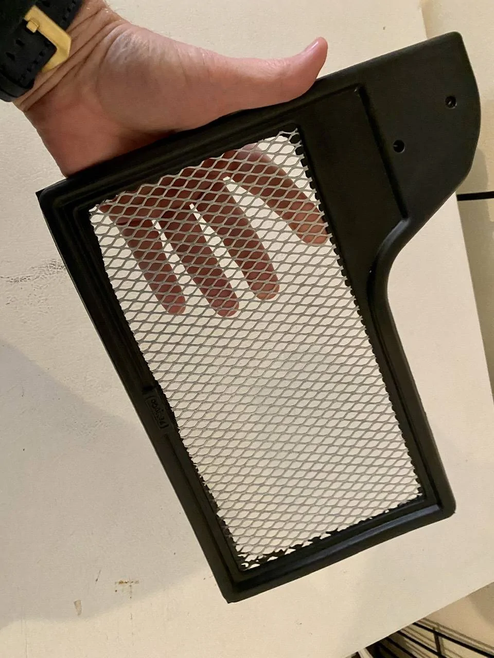

The ultra high CFM CAI guaranteeing zero chance of low pressure reversion and hot air invasion.
You might sleep better with a tighter mesh screen. Or better yet use GREEN FILTER USA to keep track debris out.

The ultimate high CFM CAI guaranteeing zero chance of low pressure reversion and hot air invasion.
You might sleep better with a tighter mesh screen. Or GREEN FILTER USA to keep track debris out.
That is the only filter?
That’s a picture of a home brew concoction I tossed up just for an example what folks will do for more CFM’s. Here’s the thread.
https://www.mustang6g.com/forums/threads/air-in-take-filter.124245/page-10
I
advocate GREEN FILTER USA, highest drop-in WOT CFM currently available.
I’m sure there’s dust issues on your tracks so an open mesh drag race style screen filter is counterproductive and will prematurely grind down your piston rings on a road race track.

That’s a home brew concoction I tossed up just for an example what folks will do for more CFM’s. Here’s the thread.
I
advocate GREEN FILTER USA, great WOT CFM.

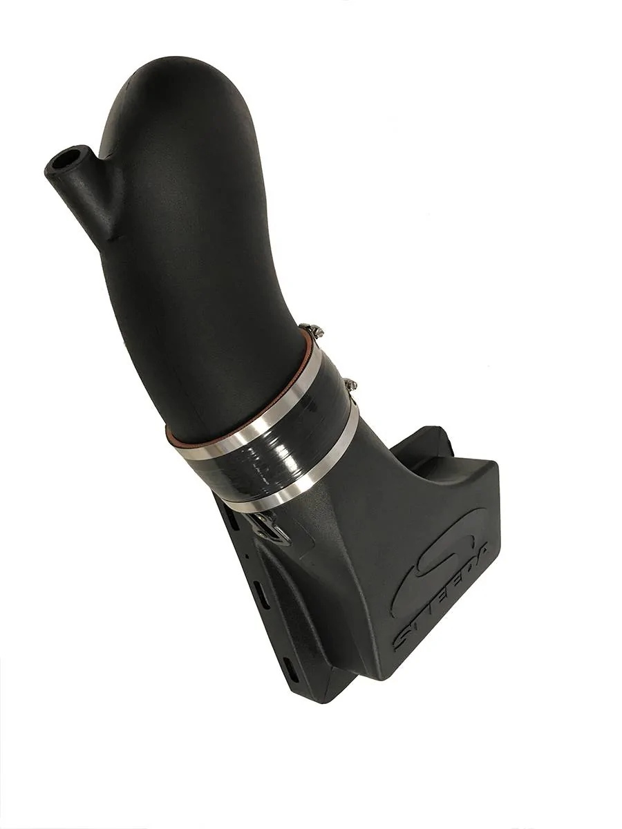

I read somewhere for a gen 2 that using a 2018+ stock airbox is an upgrade as it's a little bigger yet still keeps the IATs low because stock airbox. At the same time though I am very interested in the steeda CAI but haven't found enough info on it from non steeda sources
