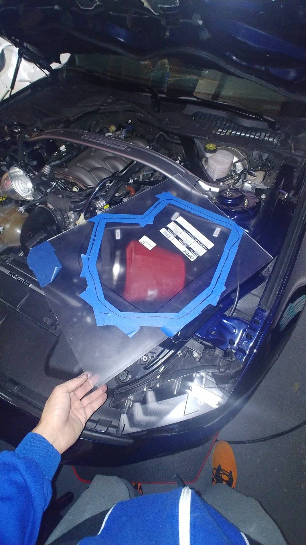

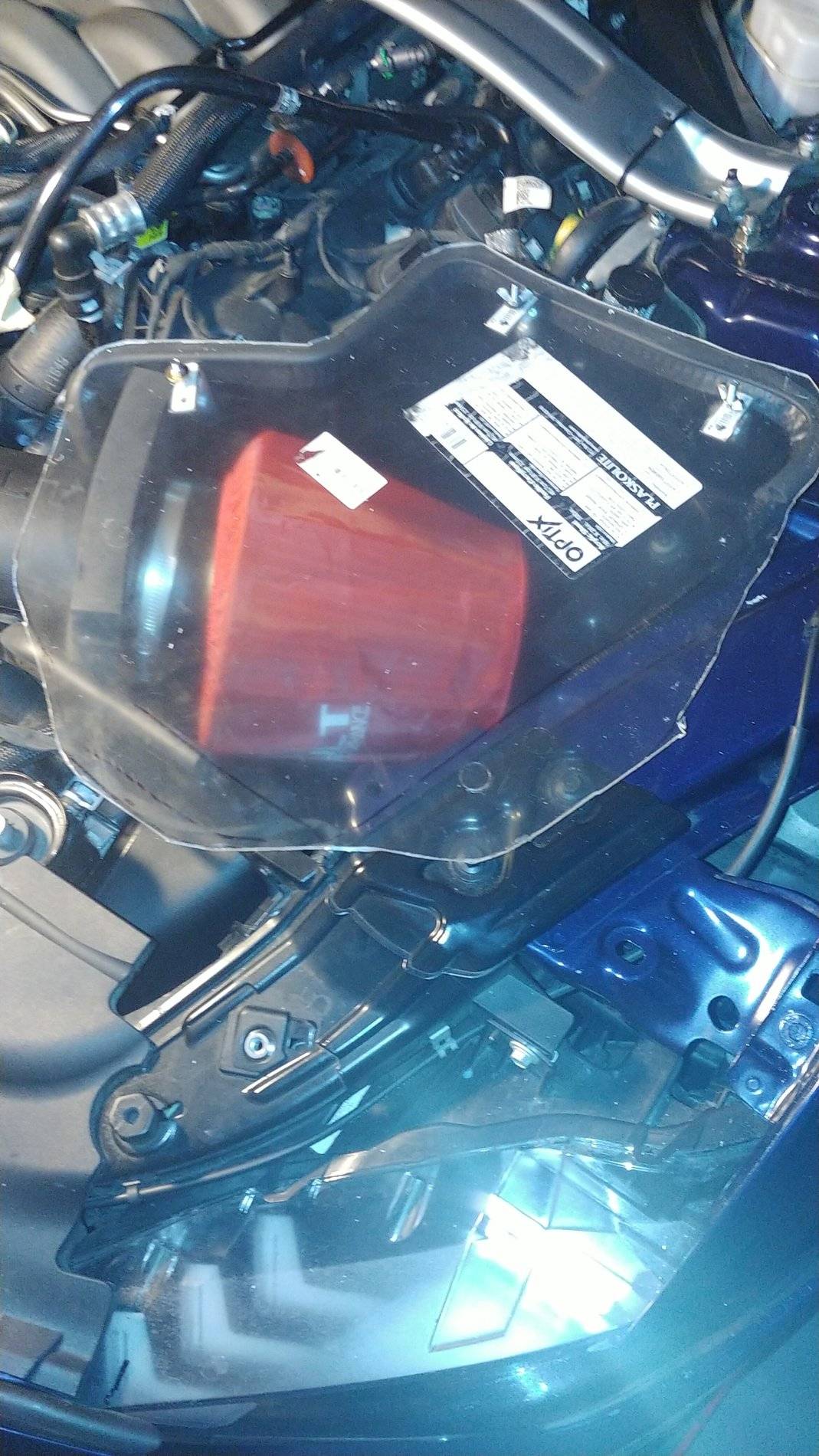

My experience has been great so far with the JLT and the video I did Proves that is better than OEM 18 airbox ( i have a 2018)
I can see a concern for the "CROSSLIGHT RACERS" where the IAT can grow fast .( but temp also drops fast once running)

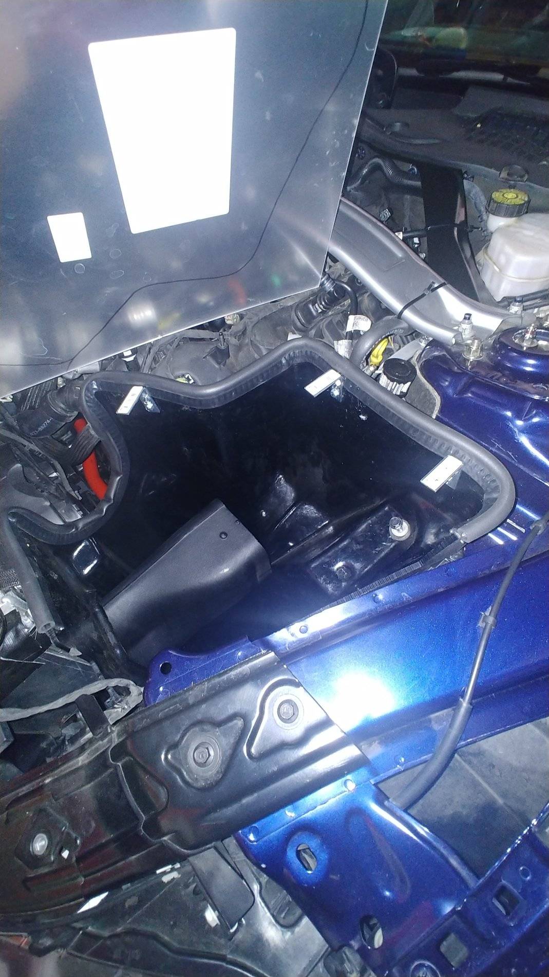

so I'm doing this :). WORK IN PROGRESS>
I hope to do some testing soon

The test I did was
Tune 96 octane +oem airbox
Tune96 octane + JLT intake ( and of course calibration otherwose you will damage the car)
Tune 96 oct +JLT intake and hood down
Jlt showed 22whp more than just the tune
And with the hood down 10-11.
That is why I'm creating a cover and test IAT and if I can MAF
