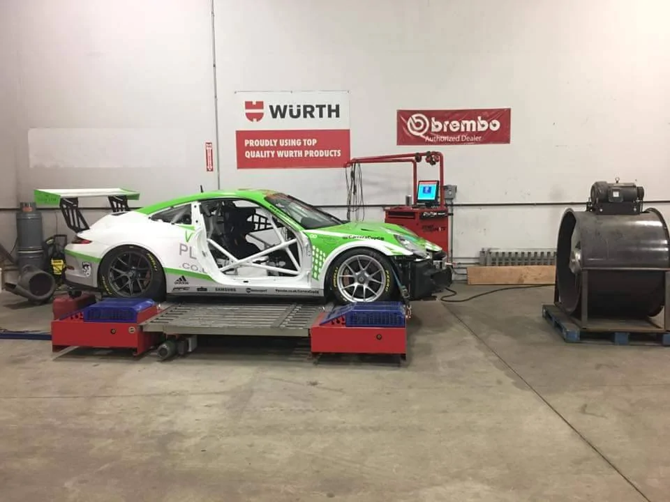

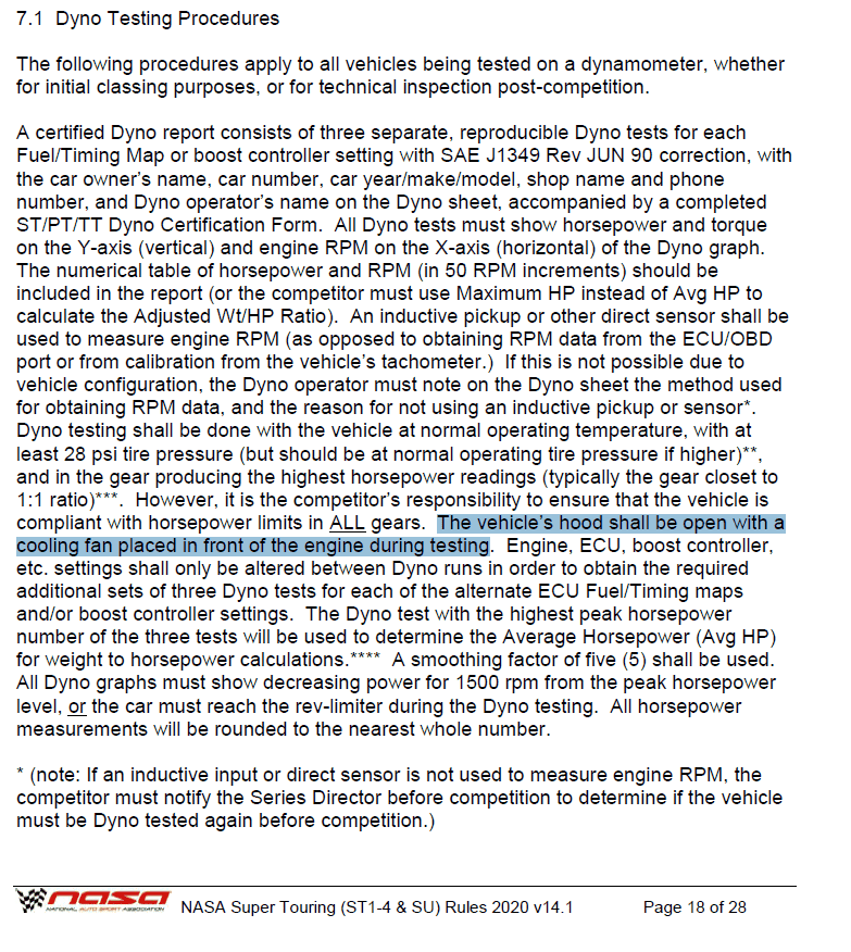

NASA or SCCA tests cars with hood open
NASA / SCCA simi pro shop.
Hood down, doors off (LOL) and a real Dyno Fan, not some carpet dryer POS.
Yeah the motors in back, the point is using a real fan.

TOTALLY agreed for the fan. I wish all the shop could have it..
But
again..NASA tests with hood open ( in your case doesn't work anyway lol )
I like to think their expertise is superior than mine. :)
