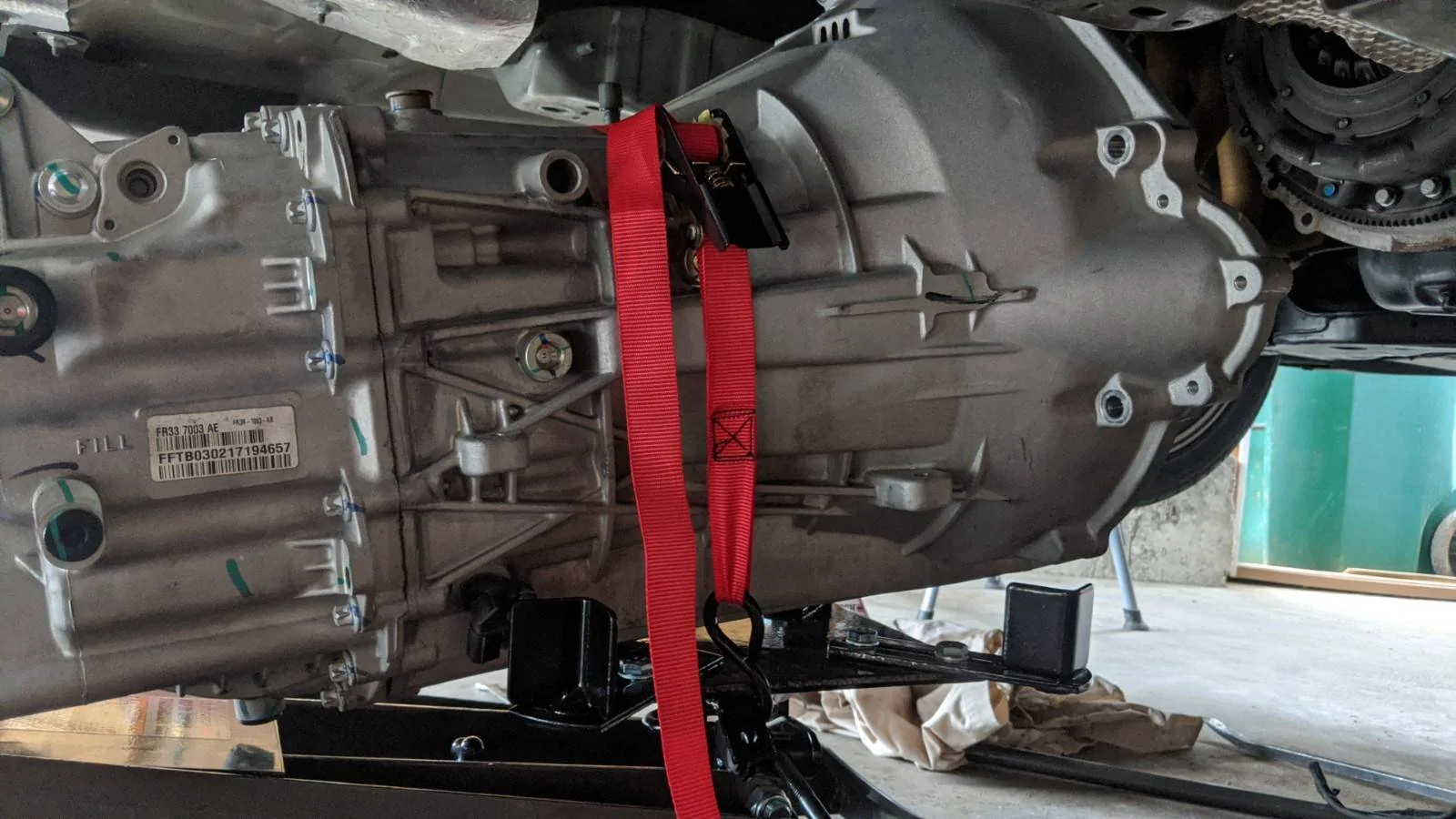

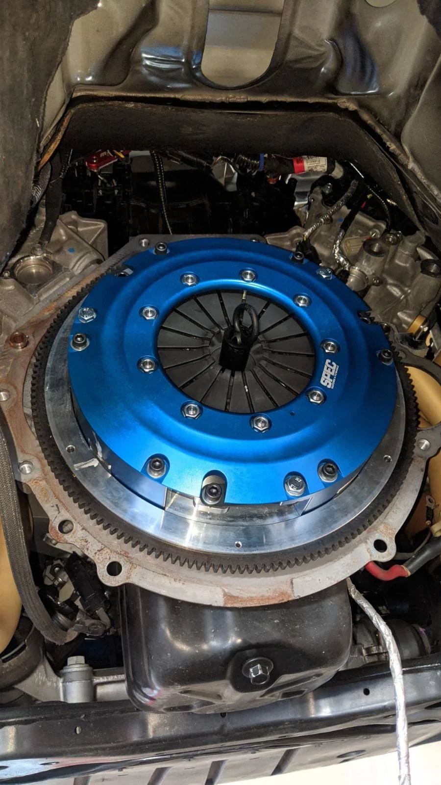

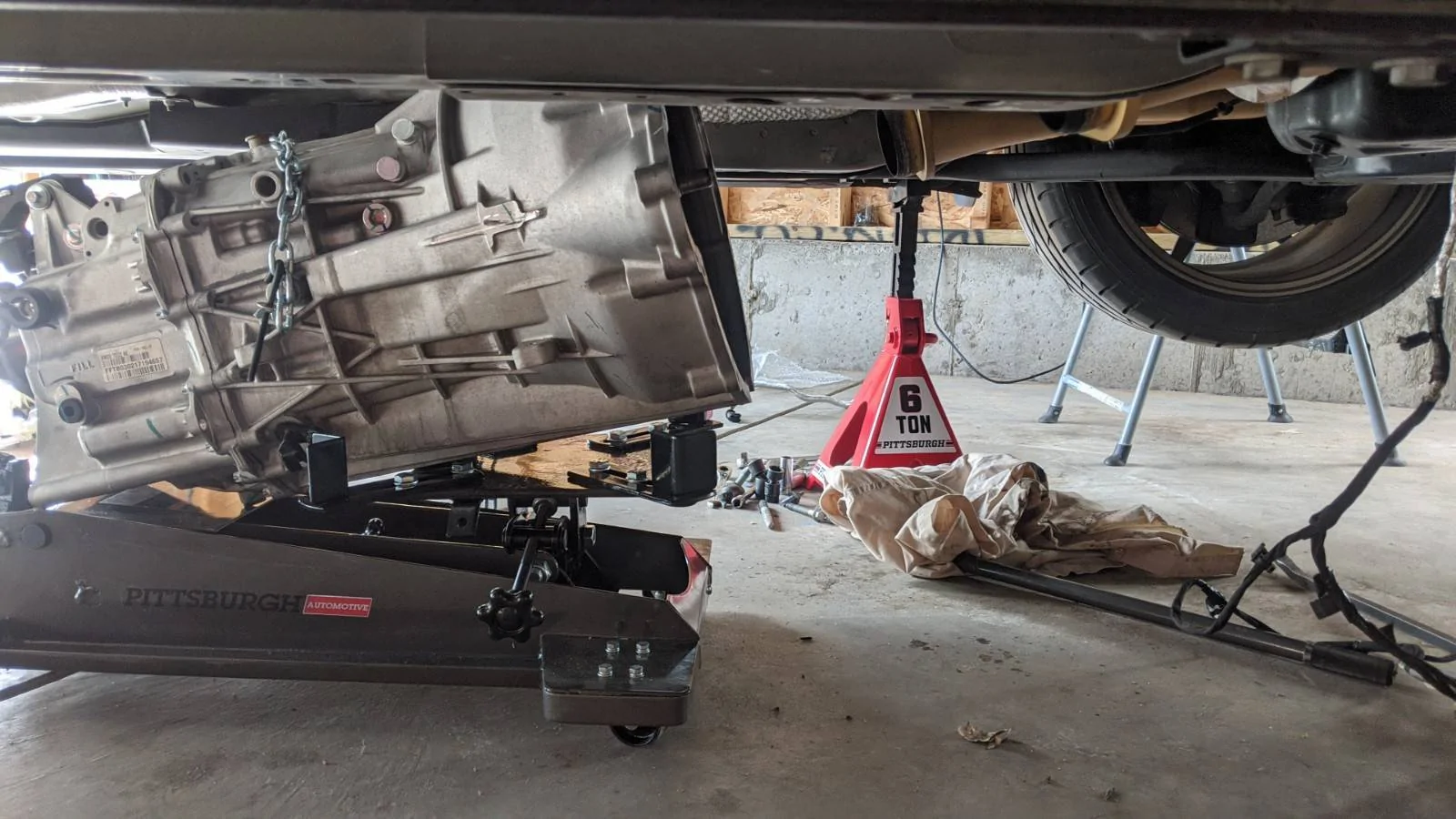

Completely doable on jack stands. Did it last weekend by myself. Definitely get yourself a transmission jack if you don't already have one. I have 6 ton jack stands, and they won't go high enough that I could get the transmission out from under the car unless I took it off the jack. Otherwise you will need to get the car a good 30" or more off the ground. May as well replace the clutch line of you haven't.

SheepDog, how do you like the Spec clutch? Which one did you choose?
Bravo sir. How tight was that starfish working under there with those stands that high?..
You got determination for sure. I dig it.
SheepDog
Nov 3, 2018
4,253
5,357
Colorado
Dax
Lol. At first, fairly tight but after a while it was just like "phuk it" if the car comes down then it was my time. the 6 ton stands are pretty damn stable. It would be even better if you have the 12 ton stands.
