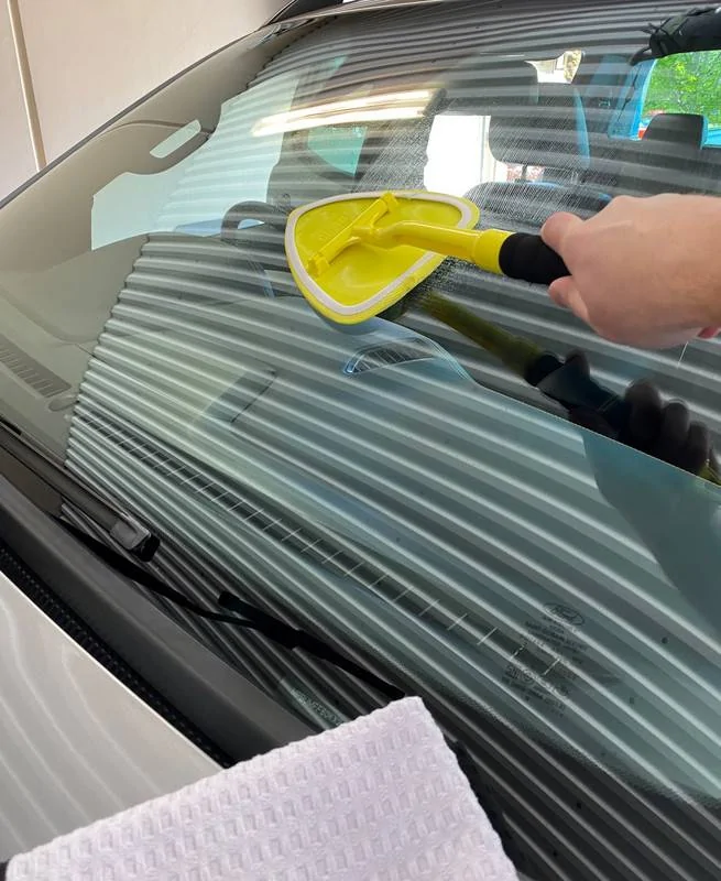

My mom had me use one of these to clean her windshield a few years ago. I laughed until I used it, now I own one. https://www.amazon.com/KNAFIT-Exten...jbGlja1JlZGlyZWN0JmRvTm90TG9nQ2xpY2s9dHJ1ZQ==
Here's what I use.its great getting the rear and front ,getting that smoky grime from front window outgasing from dash
2 Pack Windshield Cleaner Car Window Cleaner Auto Window Cleaner Tool with Detachable Handle, 8 Pieces Reusable Cloth Pads and 2 Pieces Spray Bottles for Car Interior (Gray, Green) https://www.amazon.com/dp/B08W1ZDYLK/ref=cm_sw_r_apan_i_XH8MB8CWV8XVSKYC5CZF?_encoding=UTF8&psc=1

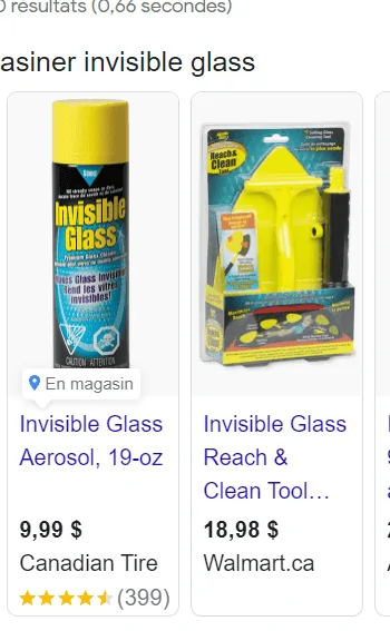

check for the Invisible glass kit. You can't go wrong. The one I bought came with the stick, 2 pads and a can of their magig glass cleaner safe for tinted windows.

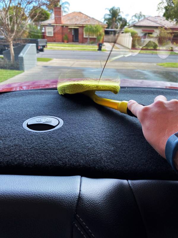

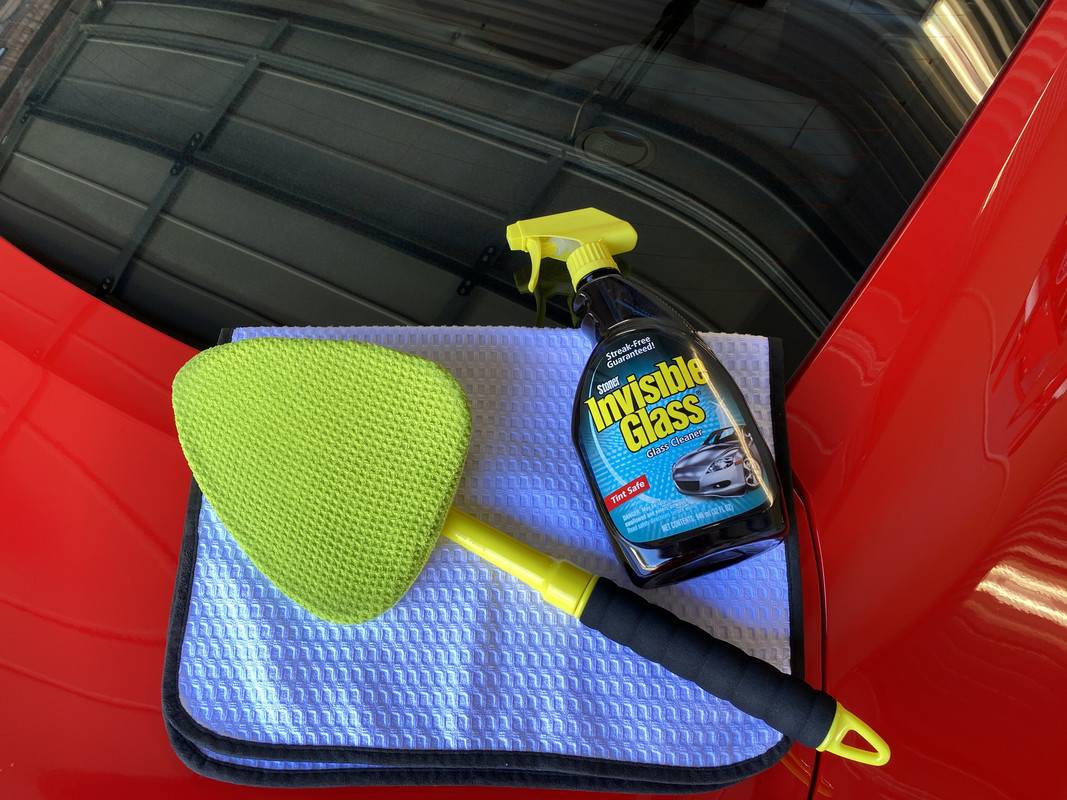

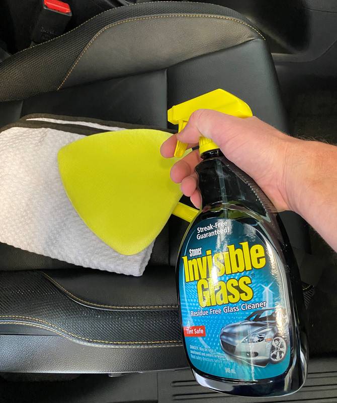

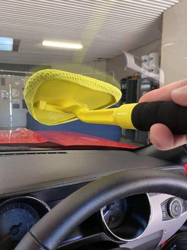

The Stoner's Reach and Clean Tool is 100% a necessity for any Mustang Hardtop's owner. For me, getting folded into the back seat is one thing, attempting to deal with the angle and depth of the screen is another. The tool also allows access right to the very bottom of the screen, which is hard to access due to the parcel shelf design and trim.
Also good at getting easy coverage on the outside of larger pickups rather than having to reach out awkwardly to get the middle of the screen done.
My go-to glass cleaner is also Stoners, in liquid form compared to the foaming type. It's cheap, available everywhere and gives excellent results. For towels, you want waffle weave to limit linting. And please, no newspaper, the ink that would help clean glass has not been used in decades.
Also, if the glass has not been cleaned in a long time and has a lot of film build up, you are best to clean it twice. The first cleaning will remove the bulk of that film, then put those towels aside and clean the glass again with fresh towels. This helps to limit simply pushing the grime around. And make sure the glass is not in direct sunlight or hot, this will induce smearing............ask me how I know this!
For all interior glass, it's safer to spray the product into your towel (or the Reach and Clean Tool) rather than directly onto the glass. This helps to avoid getting glass cleaner stains on your plastics and trim.

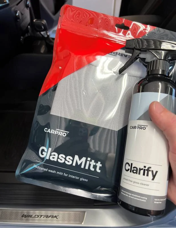

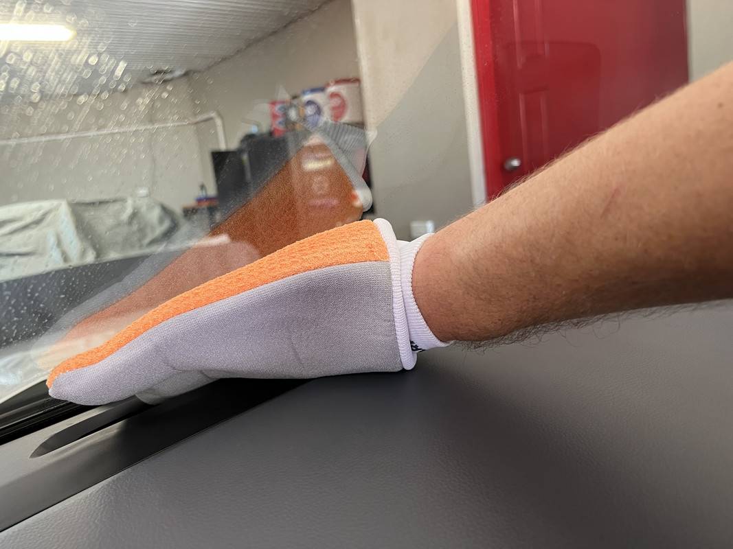

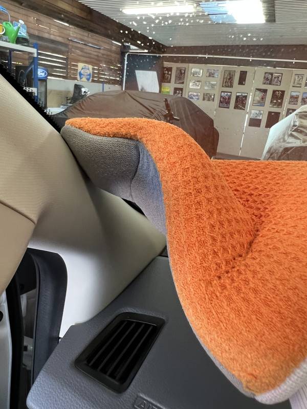

Another product to look at would be the Carpro Glass Mitt -
These are really well shaped for getting right into the corners and depths of interior glass.
