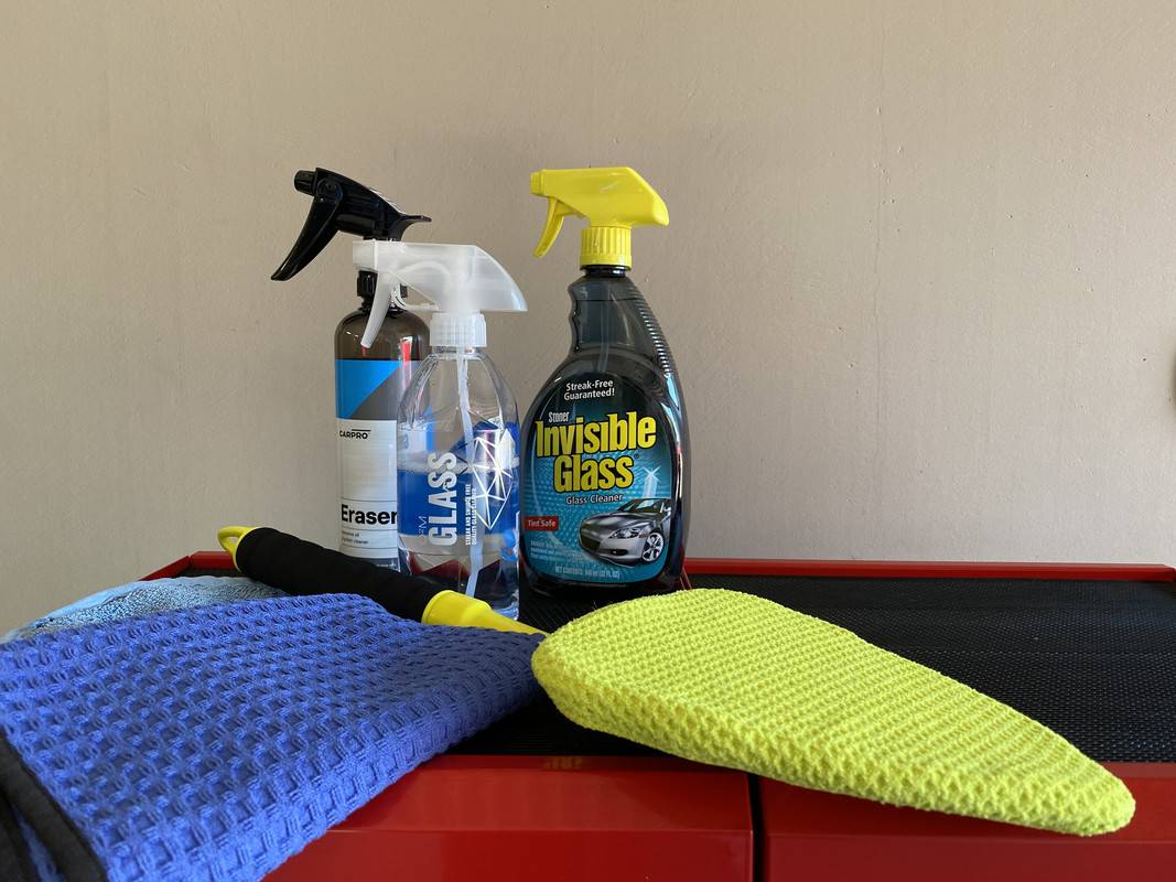

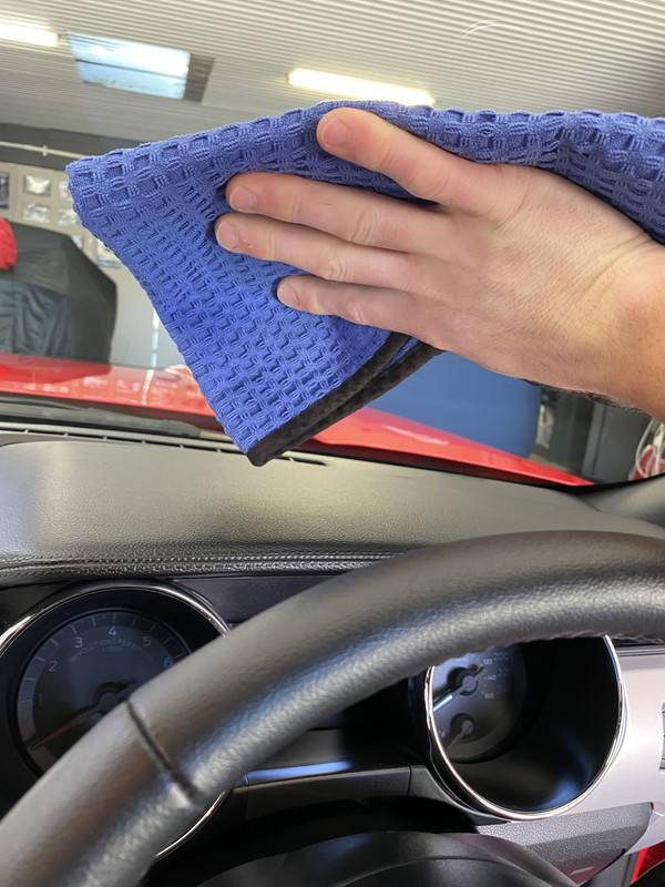

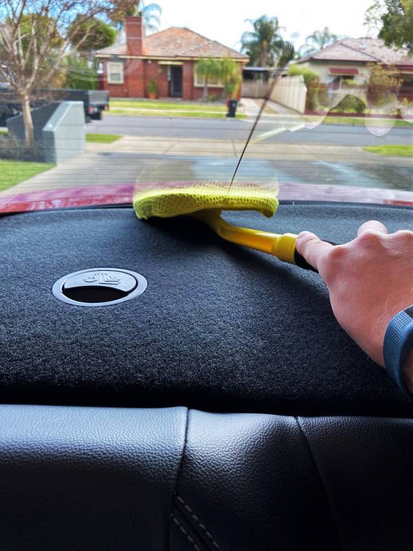

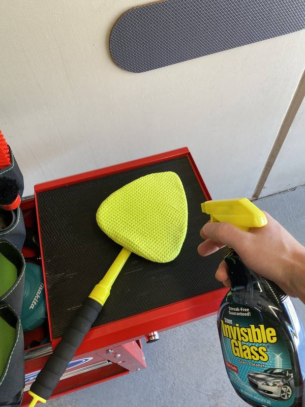

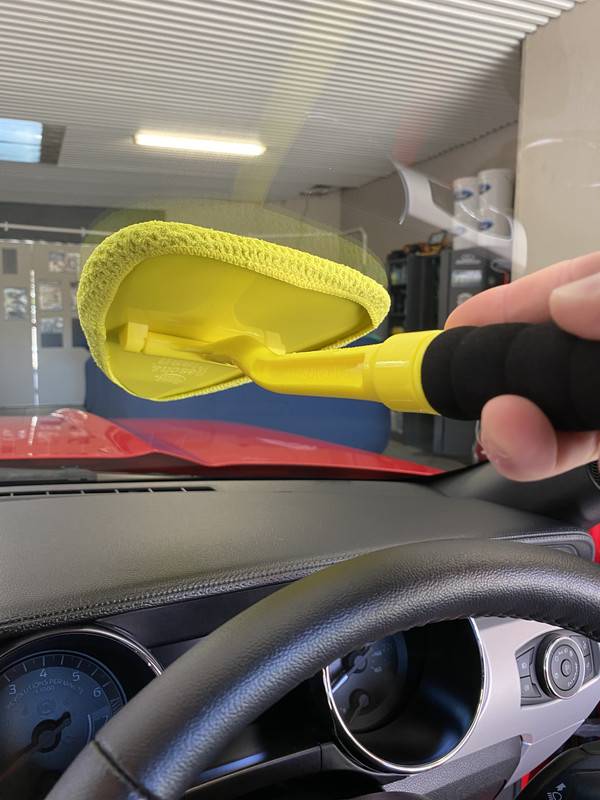

I hated cleaning glass until recently. The key to crystal clear windows is in both the technique and products.
Firstly, the glass should be cool to touch, not fresh from baking in the sun. It's also important to have the correct cloth. Waffle weave microfibre is best for glass cleaning to help prevent smears, one for the initial wipe and one for a follow up buff.
For glass cleaners, I love Gyeon Q2M Glass and CarPro Eraser and have had great results with Stoner Invisible Glass.
For the interior windscreens, do yourself a favor and get a Stoner Invisible Glass Clean & Reach Tool. These things help limit the impossible body contorting needed to do windscreens. Anyone with a S550 Mustang will understand the pain of cleaning the rear screen. Spray the glass cleaner onto the tool head, wipe up and down then buff with the second cloth.
