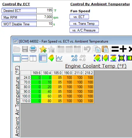

The logged parameters, such as lambda and spark timing, look pretty close. Looks to me like maybe 5 deg difference between the two, could be cooling fan settings. FWIW if you have the Reische thermostat and appropriate fan settings you can keep ECT around 185 all the time.

The fan control is a function of coolant temp and ambient temp, and totally controllable in the tune. I made several iterations on mine to balance temp control and noise. I start ramping them up at 180 and full on at 185 iirc. When I tried full on at temps lower than 185 it would be too noisy when idling and such.
You should start a tuning business if you haven't already.....thoughtfultunes.com 😅
I see, so even at freeway speeds the fans can be on?
I always thought vehicle speed was factored into fan control so good to be corrected on that
