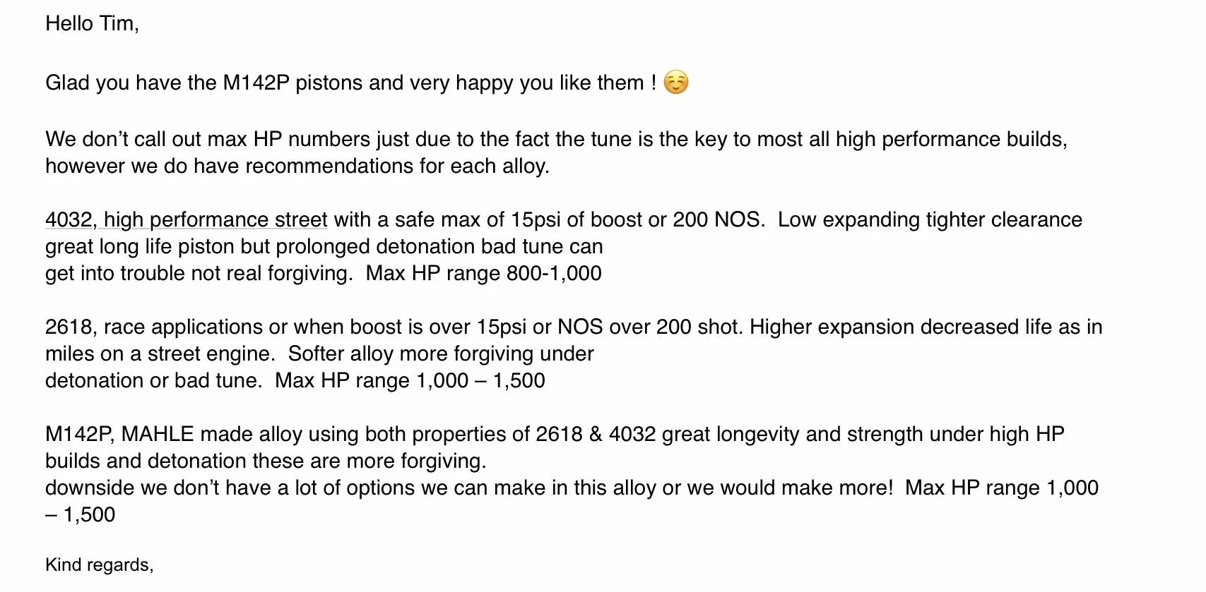

Here is a reply from Mahle. I asked I’d like to know the limits of the 3 alloys and when would you recommend 2618 over 4032 or M142p.
Probably get that 10.4:1 CR piston in M142P
