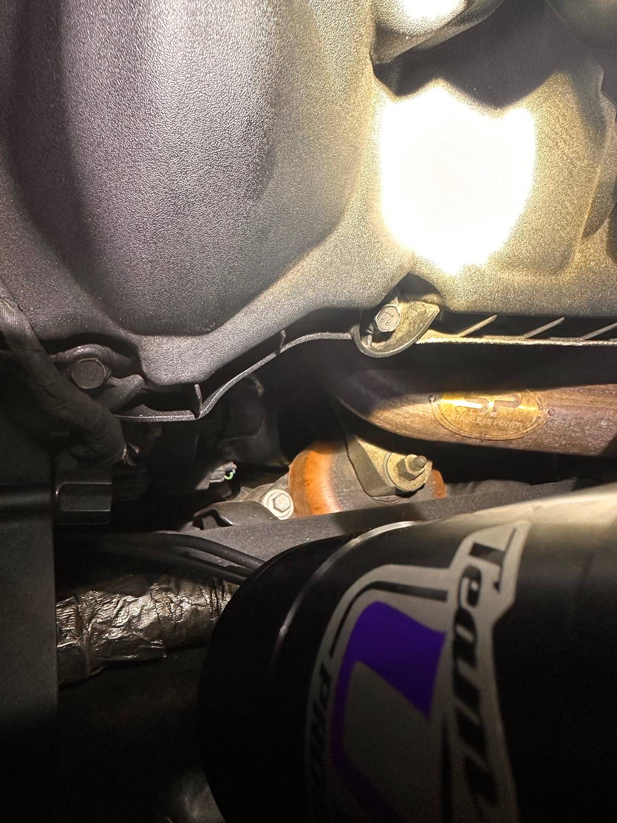

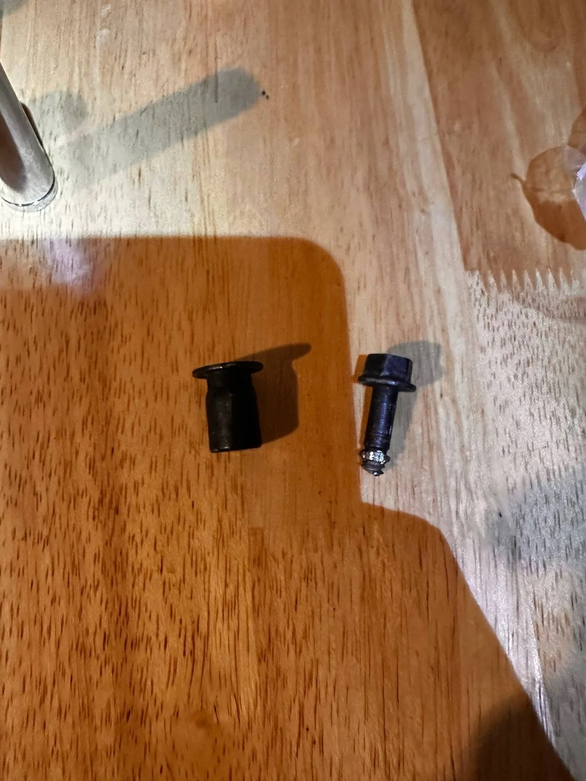

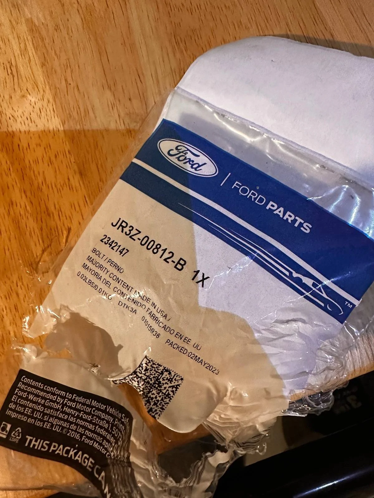

Are your valve covers missing 4 or 5 bolts? My 2015 is missing 4 bolts per cover. The TSB shows 5 missing per cover.Just checked my 17 GT. Yup, valve cover bolts missing as well. No leaks yet and I'll do the fix myself if needed. So the TSB reads to me like all valve covers are missing a quantity of bolts but only "some" vehicles may have an oil leak from the covers which the TSB will fix under warranty. Sure seems like they tried to save a few bucks again; sort of like the engines away back they decided to only machine 3 threads into the cylinder head for spark plug threads.
