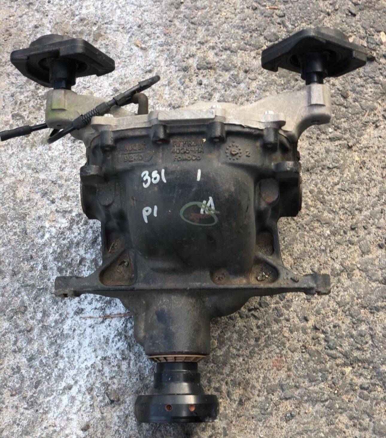

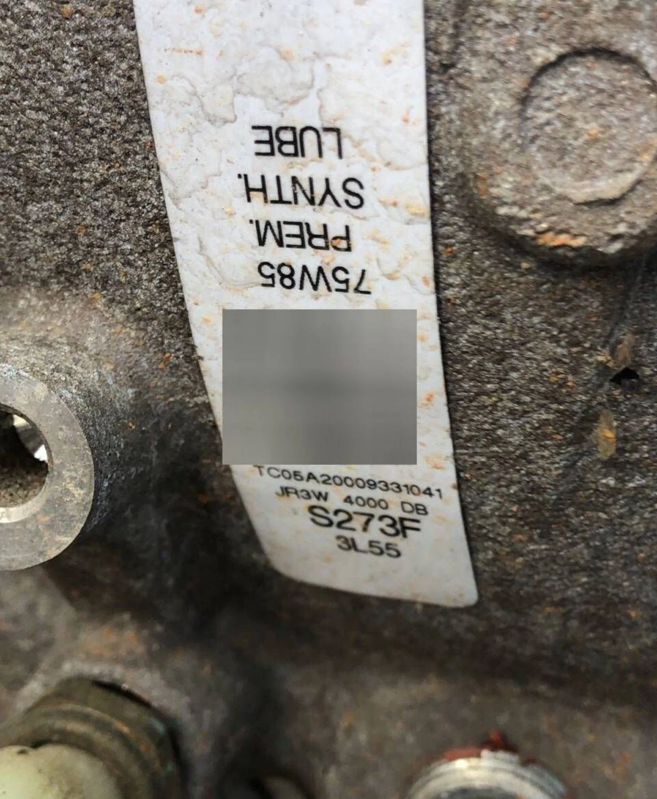

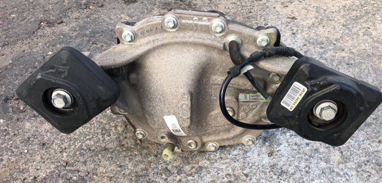

I have this device, and I want install him in return of the current one (3.15).

The 3.55 unit you posted a pic of is from an auto, it should be a straight swap.
You won't have to change anything in the programming of the car. The Car will auto detect that ratio.
What will change is your shift speeds. If it now shifts into 3rd at 30 it will after shift into 3rd around 27 Mph. This cannot be changed with forscan.
It is not a very big jump. I did the same swap and wish I went with 3.73.
