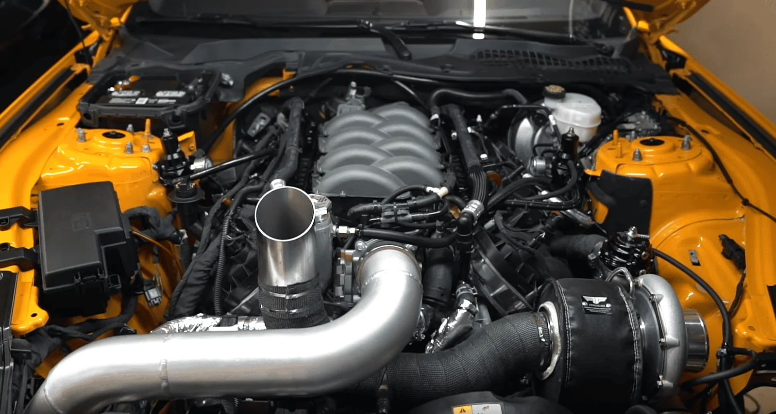

Just a little sneak peak of a buddy's 2018 Mustang we have been working on. He bought the hot side from CG Fab and then pieced together the rest of the kit. There were a few issues and challenges on the 2018 to get the kit installed but I think its turned out pretty awesome!
  • CG Fab T4 Hot Side
  • Precision 7675 Turbo
  • Tial 44mm Wastegates
  • Tial 50mm Blow Off Valve
  • Treadstone 1300hp A2A Intercooler
  • Custom Cold Side
  • Custom 3.5" Downpipe (Through the hood :rockon:)
He is still not done. It starts and idles great. Just need to finish installing a triple pump fuel system, injectors, boost controller and get it tuned.

Yeah he is putting the A/C back on. Hes going to make a custom line but now that the kit is installed and we relocated the harness, etc there is plenty of room for A/C.
Exhaust out the back? That one would be tough with A/C. Routing options are limited but I am sure it would be possible...

while my tastes are along the same lines as gimmie11s, I'm really glad someone did a CG fab single coyote kit on an s550 AND made a thread with pics! One question though, how much room is there for a larger downpipe with the factory cooling fans? Definitely in to see you guys make the 7675 do some work!

You could easily fit a 4". We wrapped his and still have at least 1" on each side. His radiator/fans could move even further forward if we had to and he could do aftermarket fan shroud like the hellion kit to get even more clearance. Dare I say a 5" could fit...
CPR runs a 5” under the car out the back that merged into dual 3”.
It’s tight, but can be done.

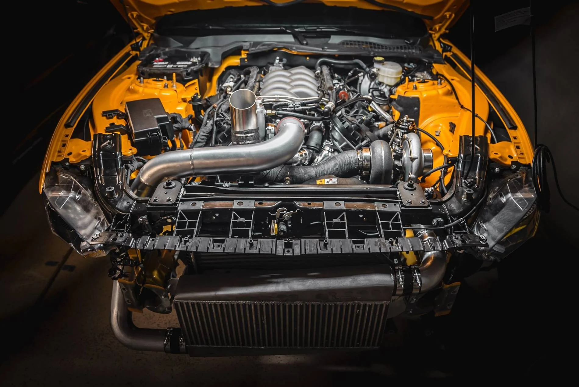

Updated pic. Lethal Performance triple pump fuel system for direction injection installed. Tune and test drive soon!
